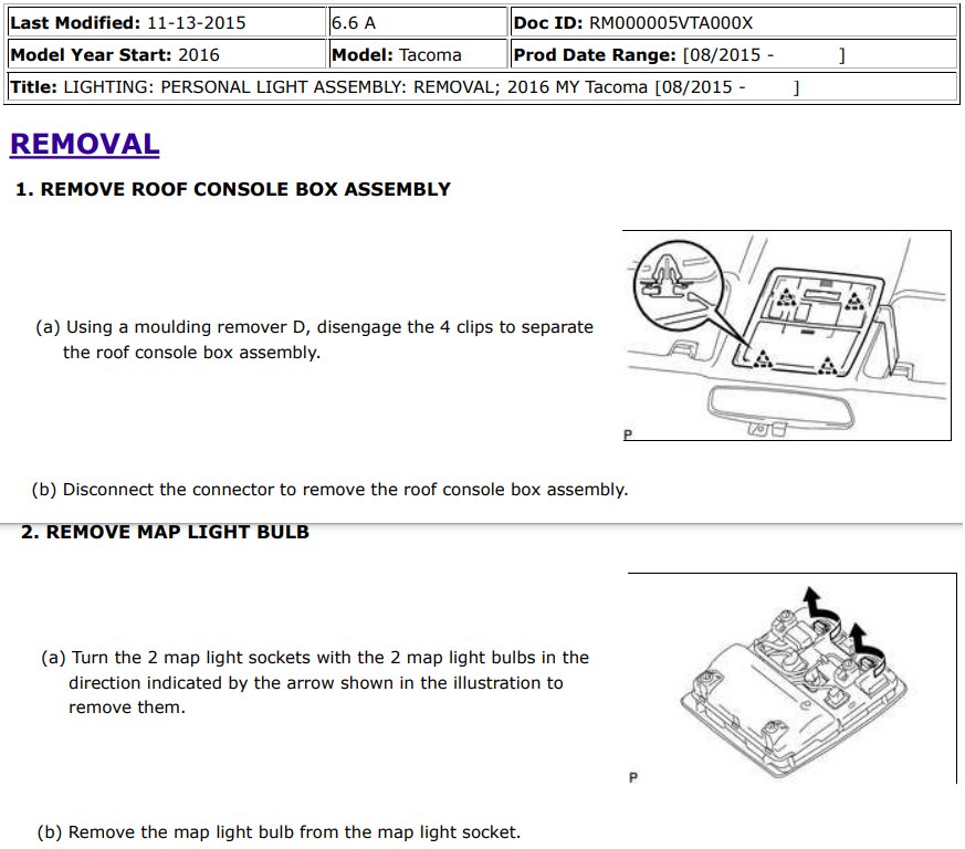

    The map lights removal is incorrect procedure. Many here have reported it has caused more gremlins than proper function. This is the correct way:
