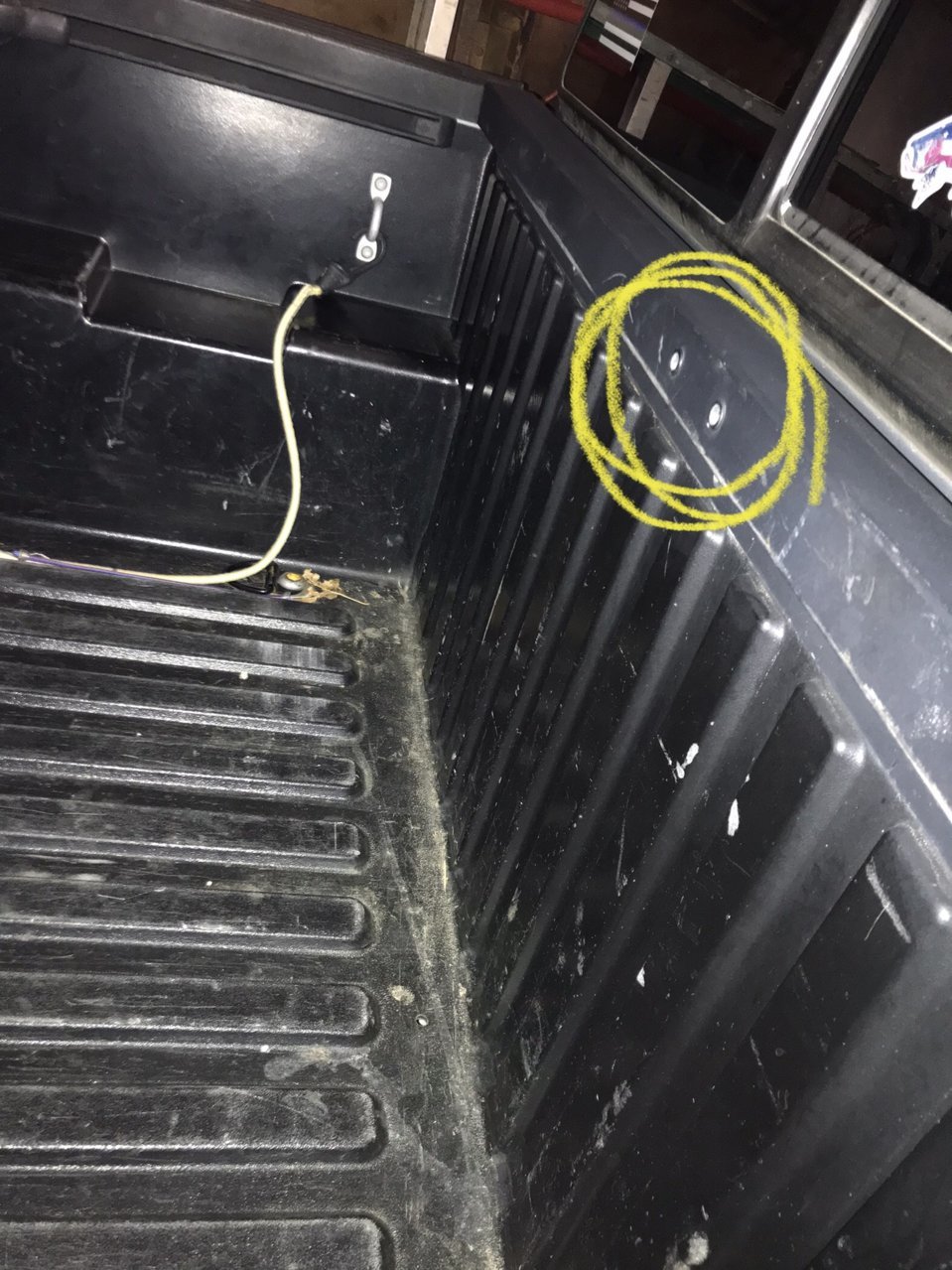

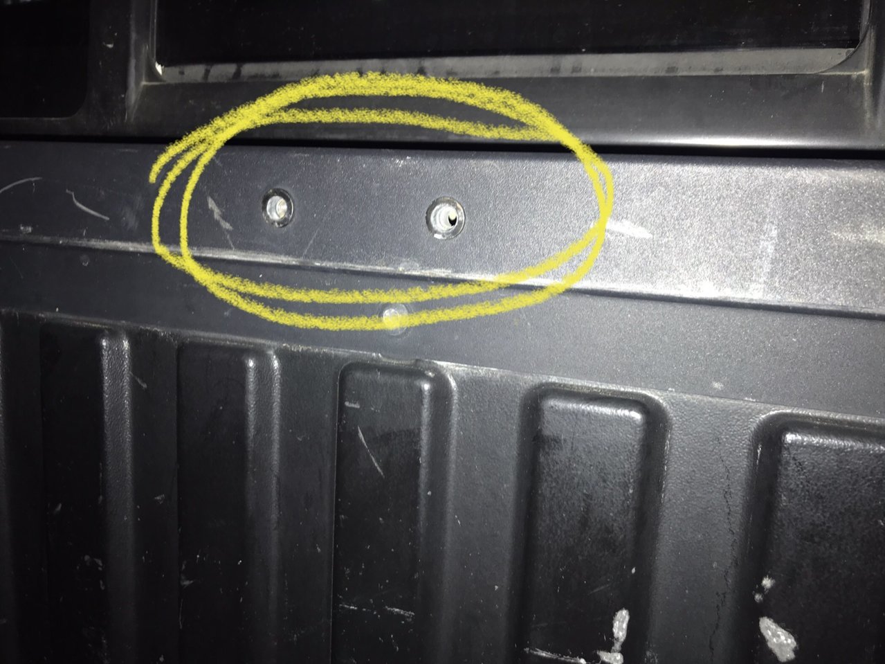

    Does anybody happen to know what size bolts fit in these holes? I'm assuming they are there to mount another rail for attaching tie downs or other accessories?

    those bolt holes are for a tonneau cover i think, not sure about the bolt size though...
    edit - check this part number for the bolts: 90148-A0006

    Most Lowe’s and Home Depot..have a measuring boards.. nuts and bolt section...to find the right size ,standard and metic ...nuts and bolts.
    Your’s will be metric..buy one of each metic bolt (measure the diameter)...most common thread pattern..wider ones..not the finer threads..take it to your truck screw it in...
    Once you know the size? Return the ones you do not need..?

    I'm pretty sure its 12mm

    M6 10mm bolts, same ones used all over the truck.

    As already stated the holes are for the factory tonneau cover, not a bed rail. The front bed rail would mount using the 5 screws just below, I like you and many others are also missing the front bed rail.
    If the thread is indeed 6 millimeter and I suspect Lava-road is correct on this, the industry standard designation would be: M6 1.0 by whatever length of screw/bolt in millimeters. Where "M6" is the diameter of the threads in millimeters and 1.0 is the thread pitch in millimeters. An M6 does not come in an industry standard of 1.5 millimeter pitch, only 0.75 millimeter and 1.0 millimeter. 0.75 is a fine thread and 1.0 is the course thread. The threaded holes are commonly called blind rivet nuts or nutserts. End of tutorial.

    I put a stainless steel hook there, they are indeed M6 x 1.0.

    I used 2 of the same bolts for the rails to go there
