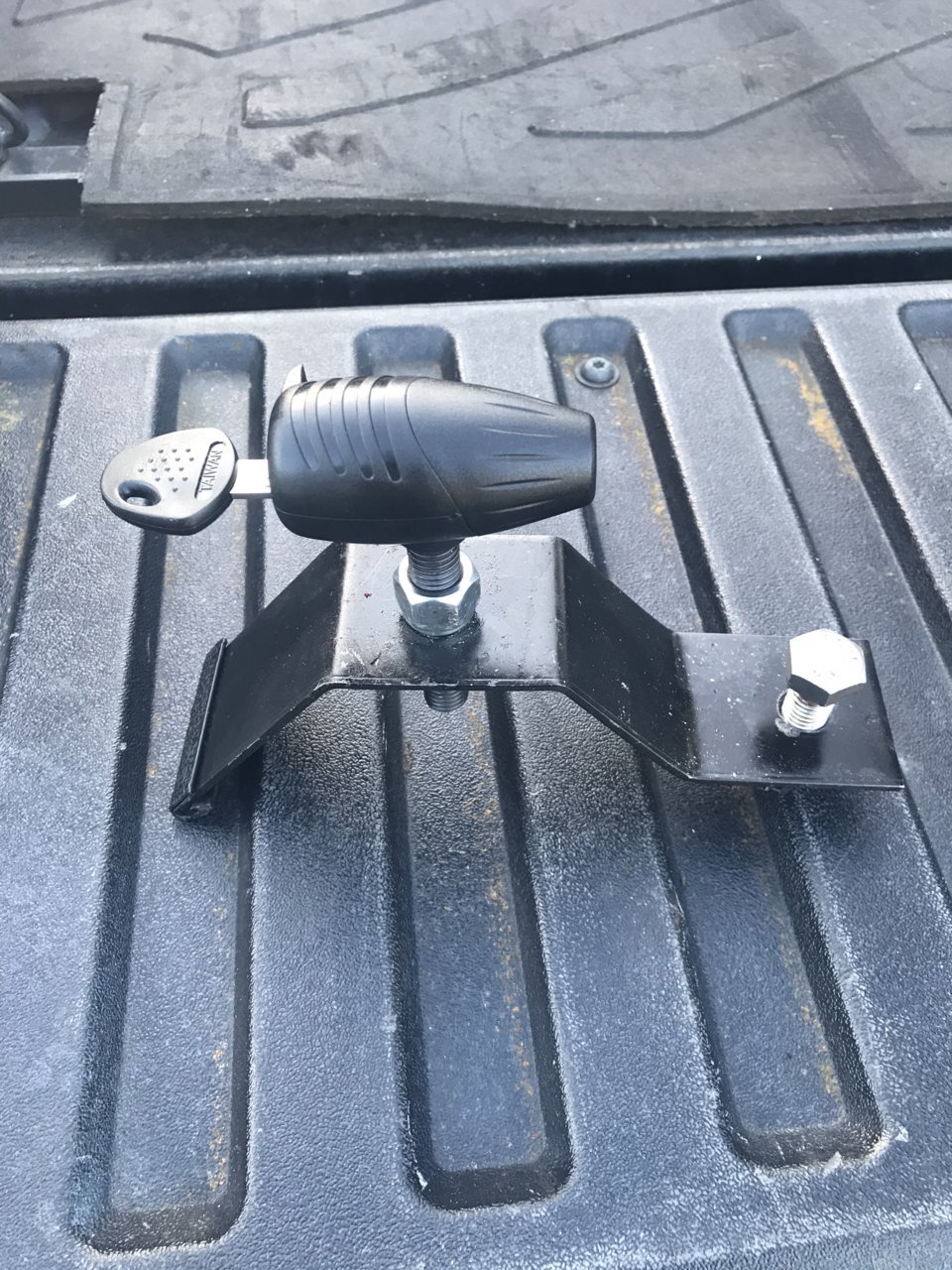

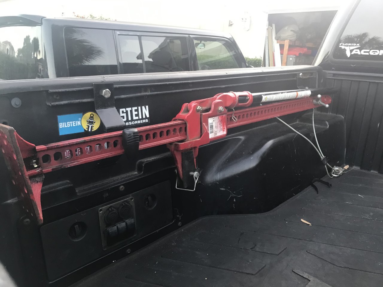

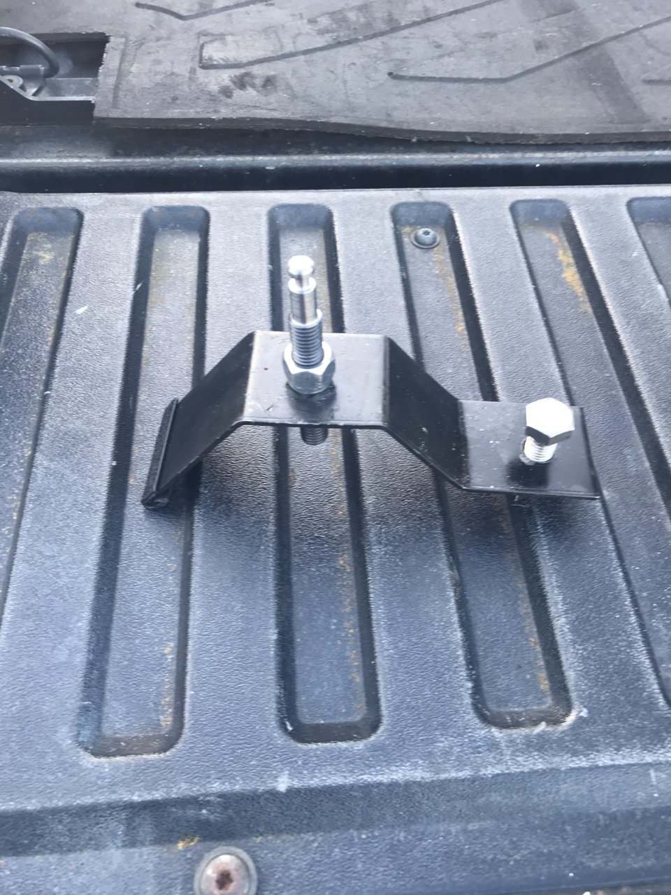

    I have recently made one of these for myself to lock my Hi-lift to a bed rail bracket. The lock is a harbor freight lock , however the pin is of one of a kind machined by a friend. This threaded pin can be adjust to a desired length to accommodate your needs. The head on the lock is free spinning so the threaded pin can not be unscrewed from the nut that fastens it to the bracket. I am planning on making 10 of these and possibly more if there seems to be a interest.
    Here are some pics of it and how I used it.
