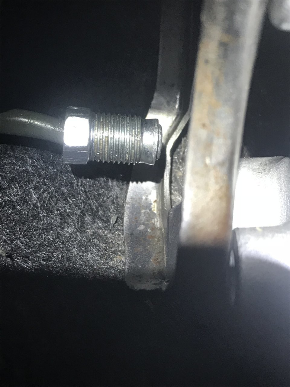

    Replacing my clutch master cylinder and need some help. can anyone give me some tips on how to get the hard line to thread into the clutch master cylinder? I have been battling this for 6 hours now, and im about at my boiling point as far as patience goes.
    Heres the fitting im trying to get started so i can tighten it down and start the slave bleeding battle.. Please help, i am to the point where i want to just sell the truck so i dont have to fight this damn thing anymore

    Yes, the threads wont start. It acts like its going to go, and then becomes very difficult like its crossthreaded, but i dont think it is.. just looking for some tips or tricks to getting it started

    I did use a razor blade to clean out the threads and everything looked good. Even used an air fitting that i have and screwed that into the old and new master to make sure the threads on the master werent the issue. Everything checked out on those, so im fairly confident that the problem is with the hard line fitting not wanting to start

    From your pix it looks like the 2nd and 3rd male threads have nicks on them. This will make it hard to thread on easily. Take a small triangle file and clean those threads up. Then start screwing it on, wiggling it as you go. Needs to be almost perfectly aligned before you start.

    You’re going to need a new line, or a new fitting nut on that line with the flare redone. The fitting “nut” has been overtightened, and is now flared out where it contacts the flare on the tubing. I hope this makes sense.

    Yep, that flare nut end is bigger than the threads now.

    As last resort, try using a dremmel tool to grind down the outer circumference of the over flared end so it goes into the master cylinder. Also clean up those threads. Tape up the end of the hard line and master cylinder so metal shavings don't get in.

    Thank you for the suggestion. I may take a file, or Dremel like you mentioned, and try to knock down the edge of that flare nut just enough for the fitting to cooperate with me!

    You might buy a new fitting and make sure that it will thread in all the way. You might have buggered up the threads when trying to reattach the line. Without the line in the fitting , it should screw right in, if there is no damage to the threads. If there is resistance, once you get the fitting started into the threads, and are sure its not crossthreaded, turn in with a wrench. If it gets harder to turn, take it back out and clean the threads of the fitting off. Take a cotton swab to clean out the threads of slave cylinder. A couple of drops of oil on the swab will help pick up the metal shavings and lube for success. Replete process until the fitting goes all the way in .
    If it were me, I would use a file instead of a drummel tool to trim down the end of the line fitting. One slip with a file won't ruin your day. It will take a little longer, but not near as long as replacing the line.
