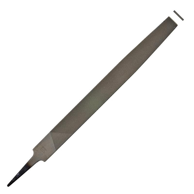

    I used a small file like this and just did a little bit at a time until finally it threaded back in
    Mine was a small file like the one in the image above. Definitely a tight space to work in. Remain patient and persistent, and you will succeed
