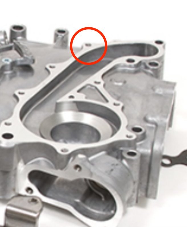

    Hello, all. Just finished replacing the water pump and a few other things on my 2000 2.7L. In the process of bolting in the new pump, one of the 10mm bolt holes got stripped out. The bolt just spins and doesn't get snug. In my ignorance, I wrapped the bolt in plumbers tape, put it in, and figured one loose bolt wouldn't make a difference. Of course, I was WRONG! Coolant is slowly leaking from that area while the truck is running and I don't think there is much pressure in the system as it starts smoking after a minute or two. The exhaust manifold and fan clutch were also replaced, for reference.
    Is there anything I can do? My first thought is epoxy; knowing I'll probably never get to remove that bolt again. I'm closing in on 225k miles so that may not be an issue. Open to suggestions. Thanks in advance.

    There isn’t much meat there to helicoil or install an insert, unless you are extremely careful... Jb weld, or LPS steel stick unless you feel like replacing the chain cover....339C9F44-45F6-4AB7-AA11-554BD411DD92.jpg

    Actually, looking at that casting there is plenty enough meat to go deeper. Get a tap drill for that thread size and a bottom tap. Leave the pump on, drill the stripped hole deeper, run the tap in there with some grease on it to collect the chips. Get a longer bolt. Even if you popped through thread sealant on the bolt will seal the oil

    Tap it to 1/4 20 standard thread. That's the next size up.

    Not having a 4 Cylinder and thinking M10x1.25 was what OP was calling 10 mm bolt I am thinking how can 1/4 20 be the next size
    M6x1.0 interesting .

    Good to hear! This is the bolt/hole in question.

    A tap wrench gets you a lot more control.

    With a bottom tap, I'd use a tap wrench. The lack of a taper means you can make threads almost the entire depth of your cut but when they bottom out they like to snap lol

    If the water pump is still on it, it will help align the tap.

    I bet you wont even need to dril it. Just run the tap in.

    Yes, still on. Hoping I can remove just the radiator and fan shroud to make enough room to do this.

    Well, the tap and new bolt worked well (which is awesome, never done that before), but there's still a leak around the water pump (I think) and the truck is getting hot. Hard to pinpoint the leak but once it stops raining I'll try harder. I'm pretty certain I installed everything correctly, gasket included.
