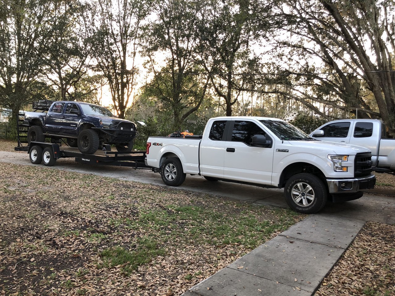

    Doesn’t look like oil starvation. Rod bearing starvation creates heat and usually rainbows the rods. Im going with hydro lock cracked the rod and it finally let go.
    Rattletrap66[OP], Torspd and Jeffs68 like this.

    797
    Classic hydro-locked condition. I did it back in the early 90's in a 86' Toyota 4x4. Sucked water in the engine,pulled plugs and ALOT of water shot out the plug holes. Engine ran tip top for 2 weeks,then traveling down the highway @ 70mph the truck actually bound up like I slammed on the brakes. Me and my passenger damn near hit the dashboard,then KABOOM! Smoke everywhere,tossed a rod through the block.
