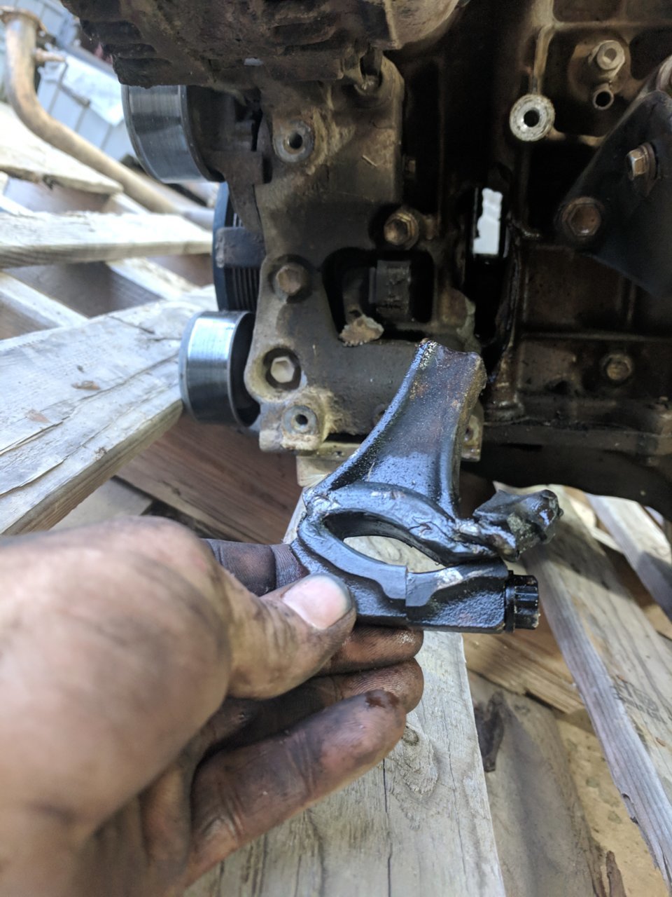

  13. Mar 25, 2019 at 2:56 PM
    #73
    Rwdetailer
    Rwdetailer Member
    Mar 23, 2019
    #287614
    9
    Ross
    2011 Black TRD Sport
    Cosmetic
    First picture of the damage on mine
  14. Mar 25, 2019 at 4:01 PM
    #74
    bobsuruncle
    bobsuruncle PhD in voiding warranties
    Feb 17, 2015
    #148863
    7,339
    Bob
    Fall City, WA
    06 TRD OR DCSB
    ARB bull bumper Warn XD9000 Icon 2.5 EXT Road Armor rear bumper Archive Garage shackle flip FJ/T4R tcase 4.30 gears Dirty5’s T4R rear axle swap w/disc brakes New frame from Toyota under EWP
    I'm not even sure what I'm looking at.. o_O
    Is that the starter? Looks like cylinder #6 failed?
  15. Mar 25, 2019 at 4:03 PM
    #75
    Rwdetailer
    Rwdetailer Member
    Mar 23, 2019
    #287614
    9
    Ross
    Cosmetic
    That is indeed the starter or should I say was the starter

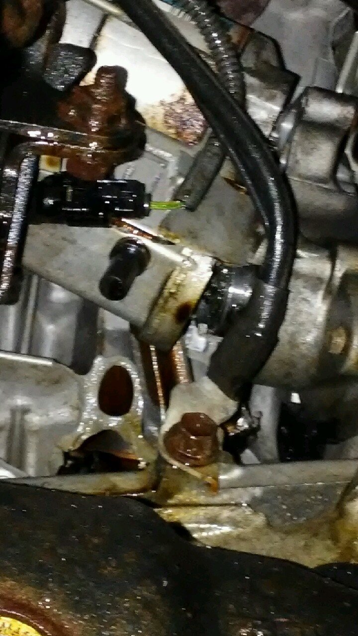

  16. Dec 9, 2019 at 9:09 PM
    #76
    TheJerseyDevil
    TheJerseyDevil New Member
    Nov 9, 2019
    #310252
    2
    Andy
    New Jersey
    06 DCSB_Offroad
    ECGS Mod, EGR Catch Can, Frame Swapped - Raptor Lined, ATH moto bed brace, Moly Console. Prior: Custom Roof basket w/area lighting.
    This is where I’m at today, ordered
    This was my realization today with my 06. I ordered the VVT cam solenoids 5 days ago, as the cold weather startup chatter got severely worse as of recently & their writeup on the issue was almost spot on until 2 days ago when it started developing knocking & some metal on metal rubbing noises that came & went like a wet pulley issue. I’ve been babying it thinking it was just the valves chattering... If only.
    Theres 0 lights on the dash indicating any type of problem, using my mounted “scanner gauge II” it comes up empty handed, 0 codes found. Though it’s not a professional grade scanner...
    As of yet I haven’t found a whole in the block, but I have a fear there’s a small one on the left bank behind the starter like your earlier posts have shown. It’s been raining non stop lately so it’s hard to tell but the motor mount looked wet compared to everything else down there. Oil level was fine, 5-30 Amsoil Signature series is rated for 25k with just about 7k of run time. (I’ve never really gone beyond 7500m even with that super extended rating)
    I’m just kinda in a state of disbelief that the legendary dependable 4.0 met its demise on an absolutely bleak drive down a 40mph roadway!
    bobsuruncle[QUOTED] likes this.
  17. Dec 9, 2019 at 9:21 PM
    #77
    bobsuruncle
    Feb 17, 2015
    #148863
    7,339
    Bob
    Fall City, WA
    06 TRD OR DCSB
    Well I feel your pain. All I can say is start looking for an alternate engine since you're aware of it. Your best bet is a low mileage 05-11. 2010 or 2011 would be my preference. I found a 2010 with ~40k on it for $1500. Shit now that I'm thinking about it, it was pretty much a year ago now when mine went.
    The clock, or should I say rod, is ticking. No telling when or where it will happen even if you try and baby it.
