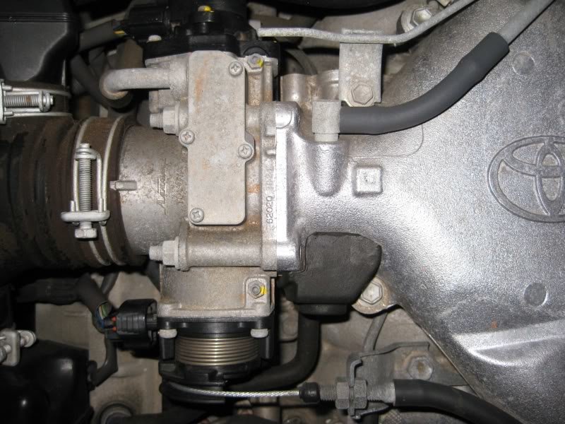

    Does your throttle body look like this?
    If so, it won't open all the way without the ignition turned on. It's throttle by wire. I believe that cable is a safety override so you can limp the vehicle off the road in case of a failure.

    Yes it logs like that. Aren't you side to turn the thing the cable is attached to to open the butterfly valve?

    if yours only has one cable then it is drive by wire and it could be what is throwing you off

    OK, if your has a single cable, and an electrical connection, then it is operating as designed. The manual cable is for cruise control. Not sure why Toyota did it that way, but hey, who are we to try and out guess the engineers? As long as your truck drives normally, I would not worry about it.
