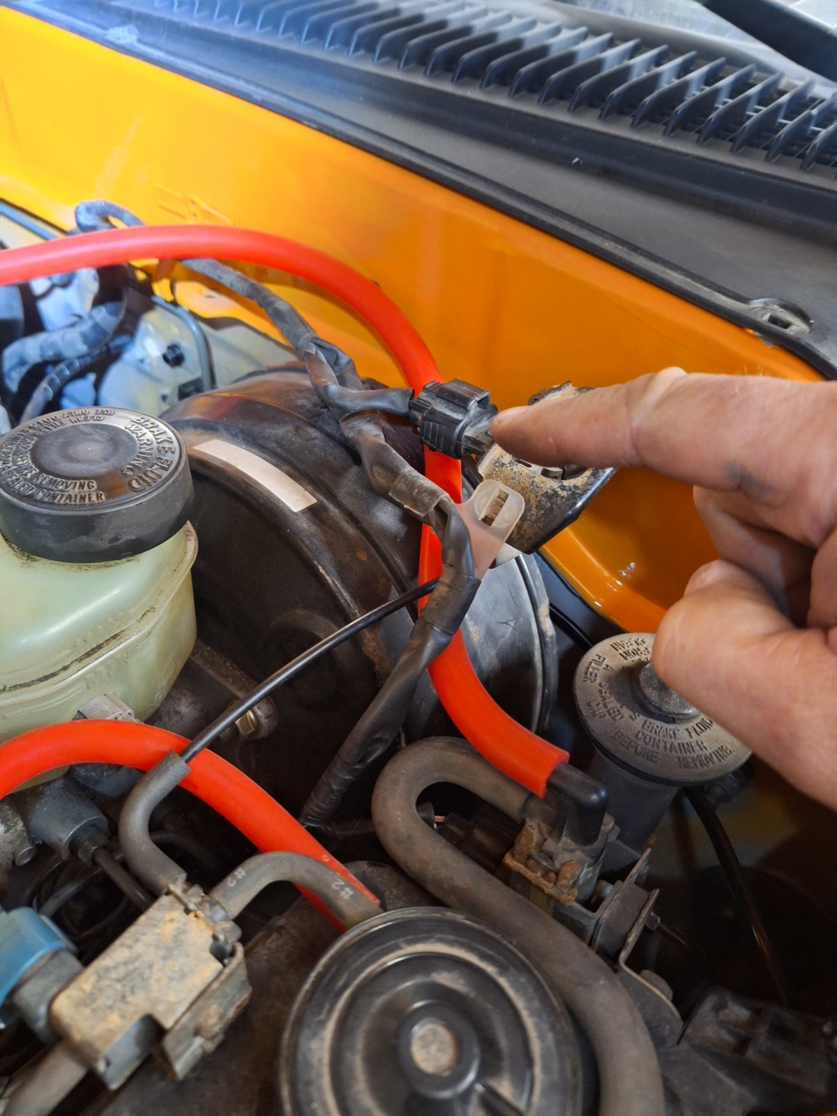

    I put the throttle opener screw back to the original setting (where I could see a bit of light the whole way around the butterfly) - installed it. what I think is the cruise control cable was a bit tight and the throttle cable was very loose so I adjusted. still at 1500 so I checked the vacuum going to the throttle opener and it was good - I also tried manual vacuum on the opener to see if higher vacuum would do anything and it did not drop the rpm regardless of pressure 0-12ingh
    I purchased a code reader and I was getting a 1600 and 450. I read about the 450 and looked at the sensor and the cable was not completely plugged in. I pushed it in and my idle dropped to 800. Thanks for all the input.

    I had trouble seeing the position once installed so I moved it manually to see if it made a difference.
