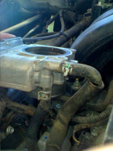

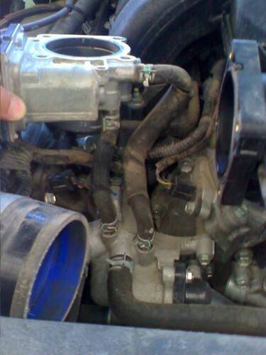

    I've been reading up on the Throttle Body Bypass Mod and haven't found any info on TW. It seems simple and might help keep my air intake cooler in these summer months. Has anybody had any good or bad experiences with this mod? Its not in the DIY so I'm guessing a lot of people don't know much about it.
    here are the hoses that connect to the Throttle body.

    X2 Judging by the OP pic, the coolant looks like it just goes in and out and not entirely around the TB.
