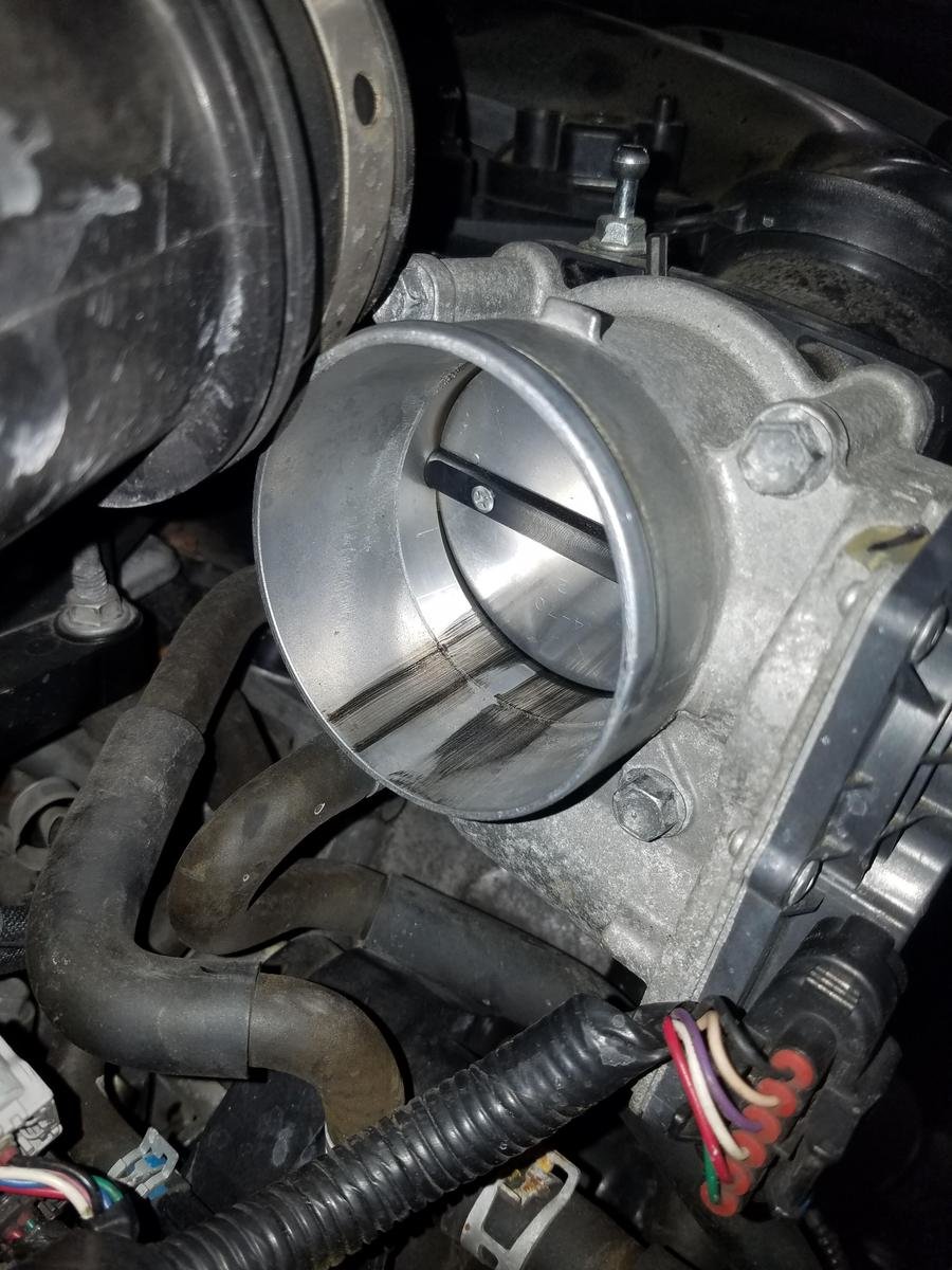

    They said it needs cleaning/service but it looks clean to me…. it’s opening fine too. Are they just trying to upsell me?

    Yes, but you can wipe that gunk out of there before you button it up again.

    Most of the buildup will be on the rear side and behind the flange. You can open it with your hand and look into it and easily clean it with $4 can of throttle body cleaner and some shop towels.

    Dealer did the same to me and MAFS. I only go in for my annual inspection. I tell them no for everything and request a print out and do it myself.
    Mine looked about the same as yours last year, I just cleaned it and the MAFS, then did the wife's car since I had everything out.

    Thanks all. This is helpful. Don't know much about this part... so didn't want to rule out their rec. but it did seem fishy. will do it myself.

    My son and I cleaned his 2017 Corolla last week for the first time. The exterior looked super clean, but inside it was quite dirty. You have to turn the ignition on and hold the gas pedal down to open it up. A few paper towels and some cleaner worked just fine.
