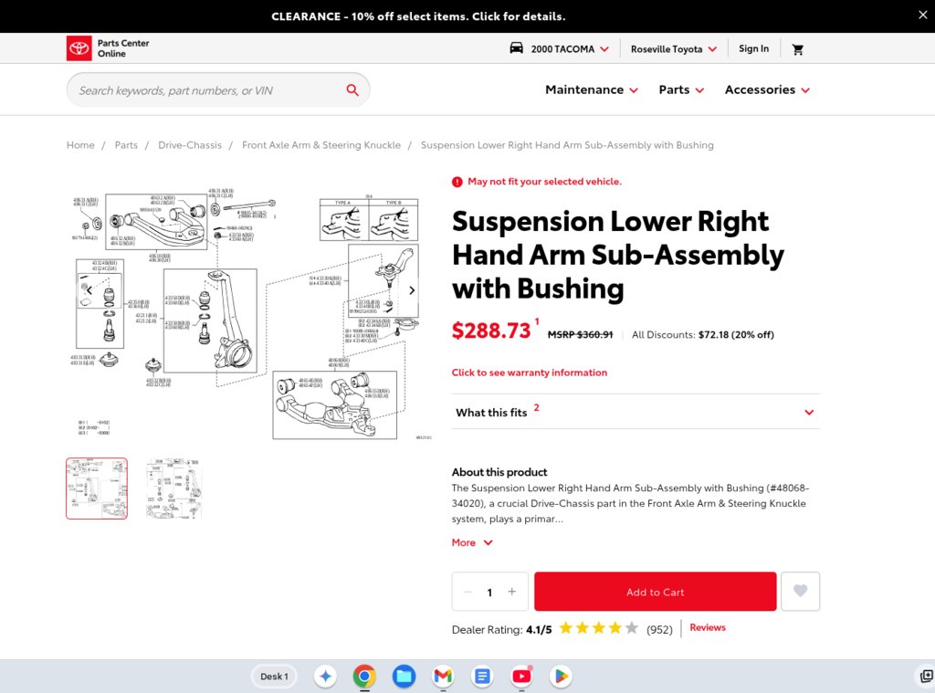

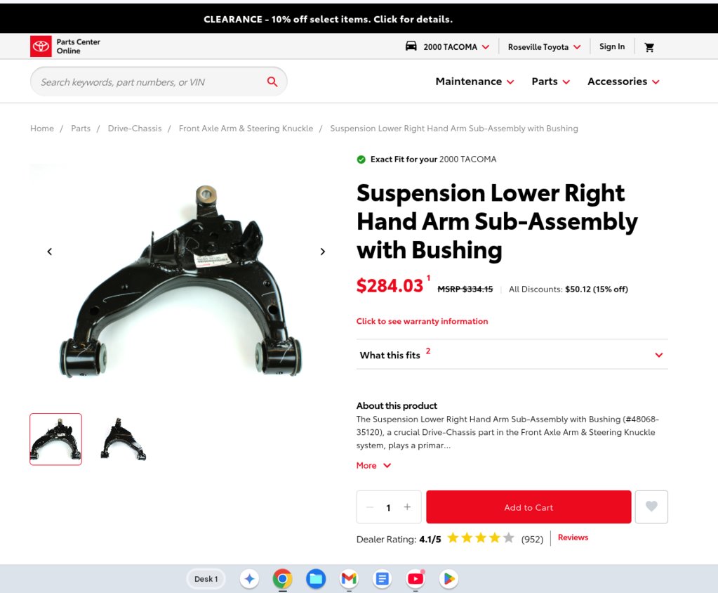

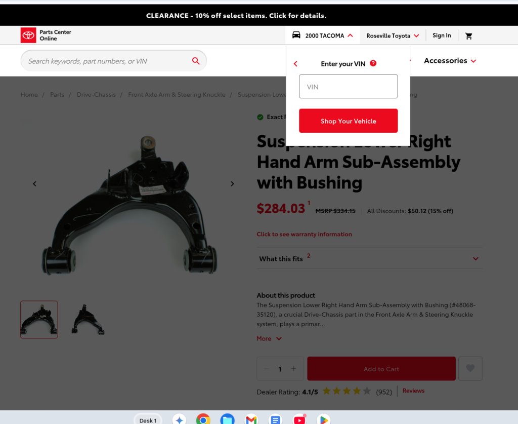

    IMO, go to Toyota's online part network. You can punch in your VIN and then when you enter part #'s it'll tell you whether or not its a direct fit for your exact truck based on VIN/Part # combo.
    DO NOT just enter year/model - that's not specific and won't yield good results in the catalog search. My example below says "2000 Tacoma" but that's after I entered my VIN in so it was an exact match. And always search by part #, not description or name. If it doesn't fit it'll say so like the last pic below.
    I do this for literally every OEM part I buy to confirm fitment. I google part #'s to get me close (sometimes i'm right on the money) then confirm this way before purchase. Plus you know it's a legit OEM part right from dealer network.
    Shop around different Toyota dealers though - this one was the closest to me, but I rarely use it because their prices suck compared to dealers farther away who offer free shipping sometimes.
    Note: also, snap a pic (or save your email confirmations) when you get the part so you have your own catalog for your truck on your phone. I do that as well. Exact part + timestamp of when I got it/did the work = awesome tool to have on hand for the future. Will save you time having to look up the same part again.
