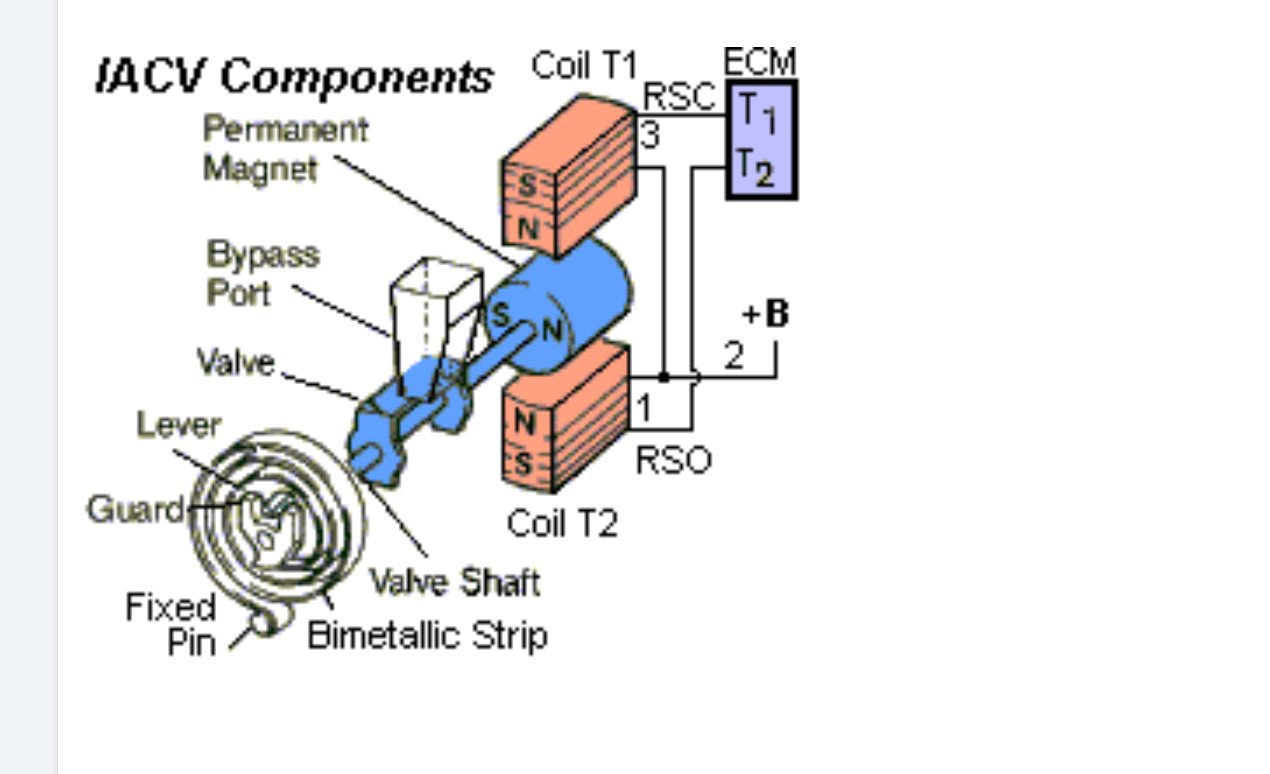

    Not saying it defective but some TPS need to be adjusted for correct idle signal/resistance. Of course I would think its set at the factory but if you have a DMM its worth checking, its just a 10 min job if that. I don't have my FSM handy right now but can check it. If your TSP has slots where the screws go in they can be adjusted but if just 2 holes for the screws no adjustment. I'm not familiar with the 4 cyl.
    So along that same line of thinking, perhaps your ECM is unable to control the IAC because of a wiring or contact issue. Pull off the connector, inspect it for corrosion or damage and maybe spray with some contact cleaner, (although since your TPS is new contact issue is unlikely). Also on my V6 and going from memory, if I pull off the IAC conn while the truck is running I get a IAC code so apparently there is some feedback to the ECM.
    Next step would be to monitor IAC control signals for proper signal but this is not easy. Its a AC signal and duty cycle controls the opening. However, if you put a DMM on the signal (and you may have to do this with the conn attached because of what I said above, typically using pins to pierce the insulation ) you will see a varying DC signal on the DMM when DMM set to DC because it will average it.
    Note that here it says it has a backup bi-metallic strip to default the idle if electrical control is lost, warm idle default is about 1000 rpm.
    https://www.toyotanation.com/thread...on-the-toyota-idle-air-control-valve.1676205/
    Summary is that you have all new parts as you said but it still does not work so my best guess is that ECM is not able to control it. Its a bit odd that its not throwing a code but on mine it has to be really bad to throw a code. Try pulling off the IAC conn while truck is running to see if anything changes or code thrown.
    You may have to take the truck to an electrical automotive mechanic but I have heard they charge by the hour or hopefully someone smarter than me can advise. Pretty much every car I have owned had a problem with IAC valve eventually but always due to carbon buildup. I had a Supra that had a stepper motor to control idle which is more reliable than the duty cycle method but damn stepper motor failed and replacement was $500 15 years ago.
    Matter of fact my V6 idle is still not right, it usually settles at about 750 but often is 900 or so. Its annoying but probably not worth spending $400 for new TB. I think you said you are at about 1000 rpms and that is not good and appears to be the default when no IAC signal.

    Also, on the V6 there is a diagnostic where you short some pins on the diag connector and it runs the idle up to prove that IAC is working. I'll post that for 4 cyl (if 4 cycl has that feature) when I have access to the FSM later today. That would be a good test because it proves beyond a doubt if ECM can control IAC.
