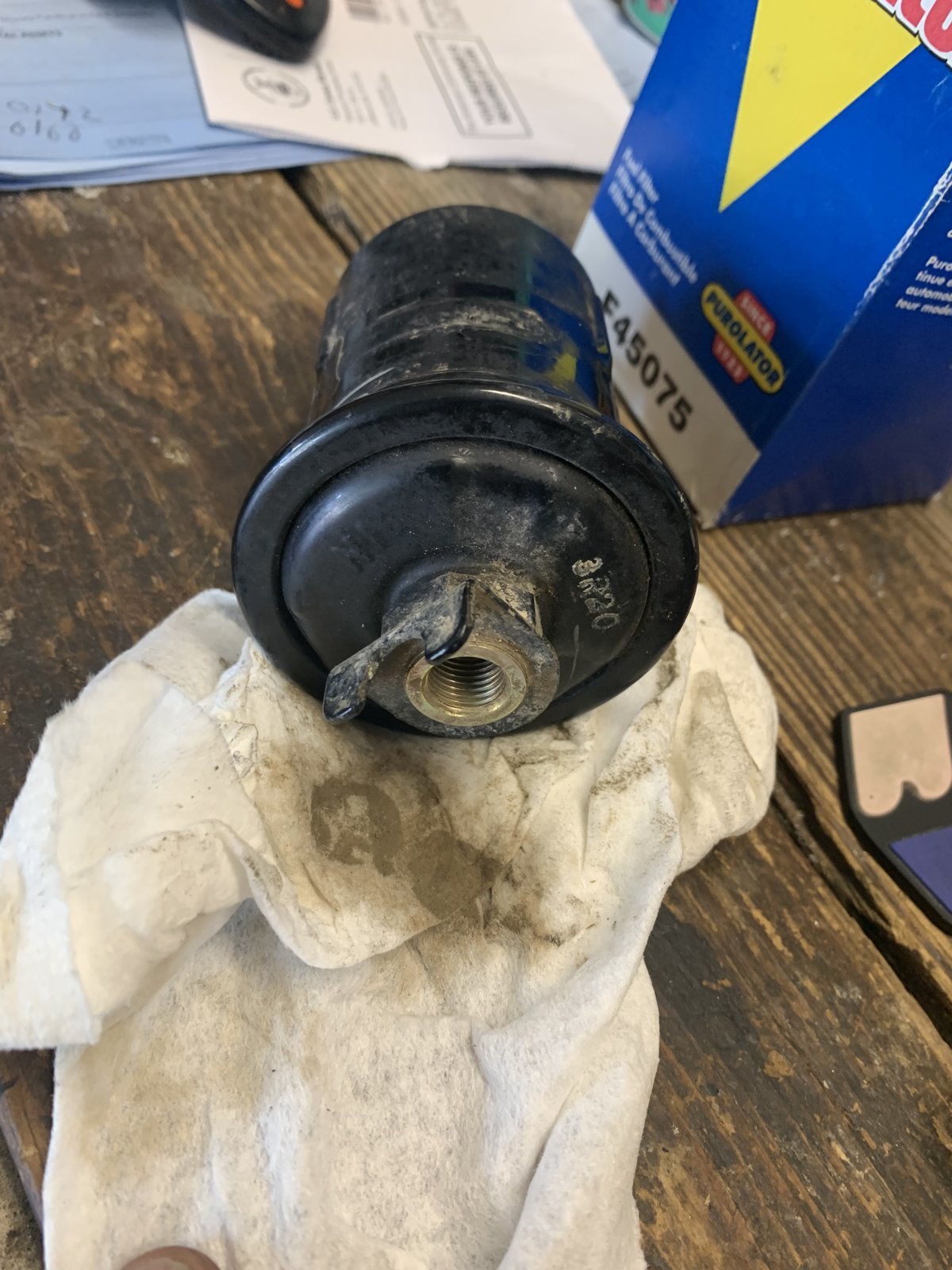

    Great time to tackle fuel filter if that’s same location on your 2.4.

    FF….ugh.
    2nd ‘project’ done
    The top of my hands were swollen from contorting to remove
    Got a gross pix somewhere…..

    Yeah, be gentle with those two fuel lines.....they are very very expensive....
    ....and you dont want to know.
    be ubber careful when u reseat any double flares....
    make sure they're perfectly aligned....when you wrench down...
    easier said than done.....

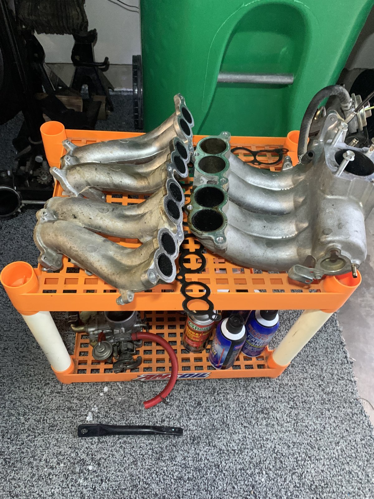

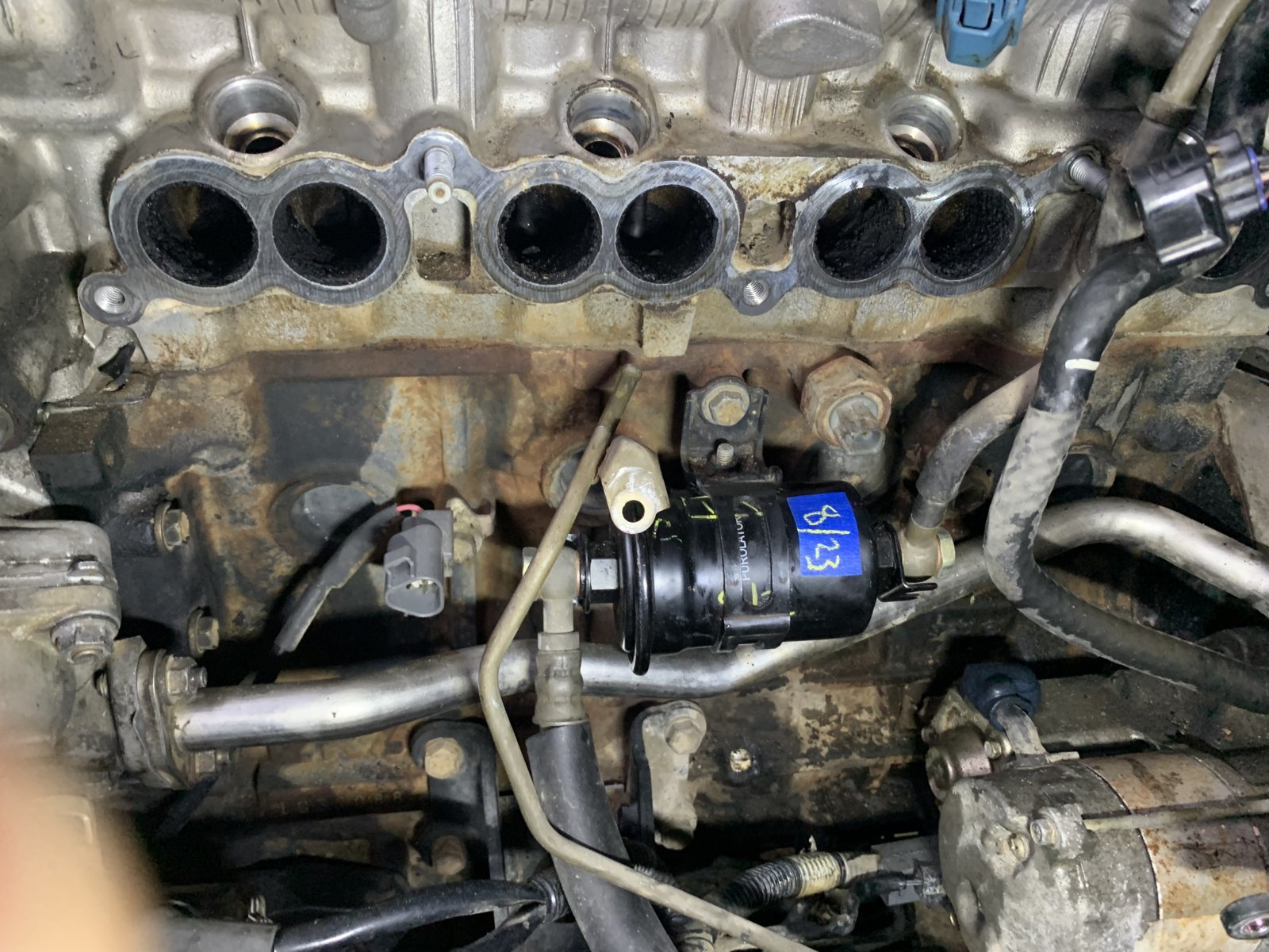

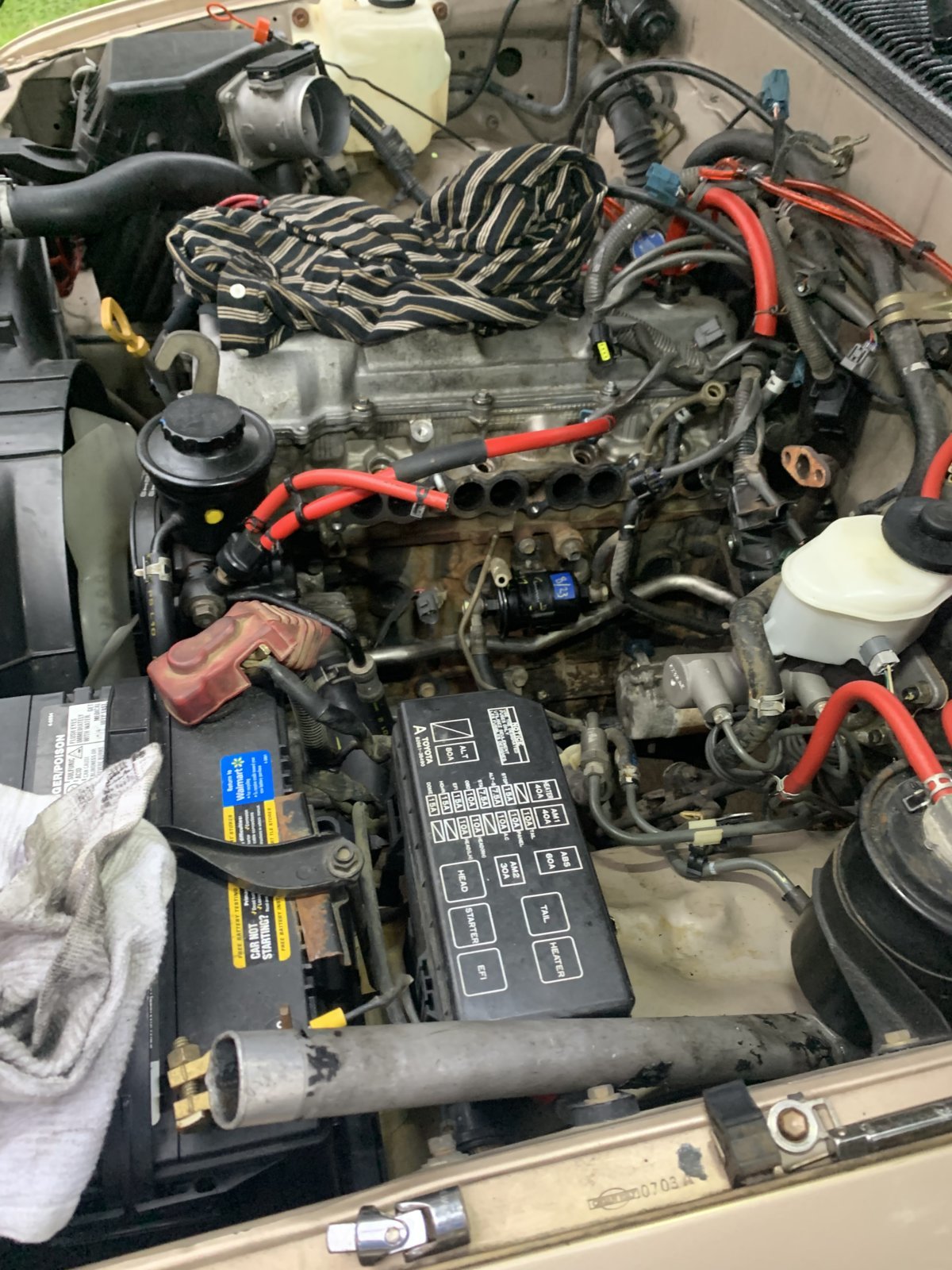

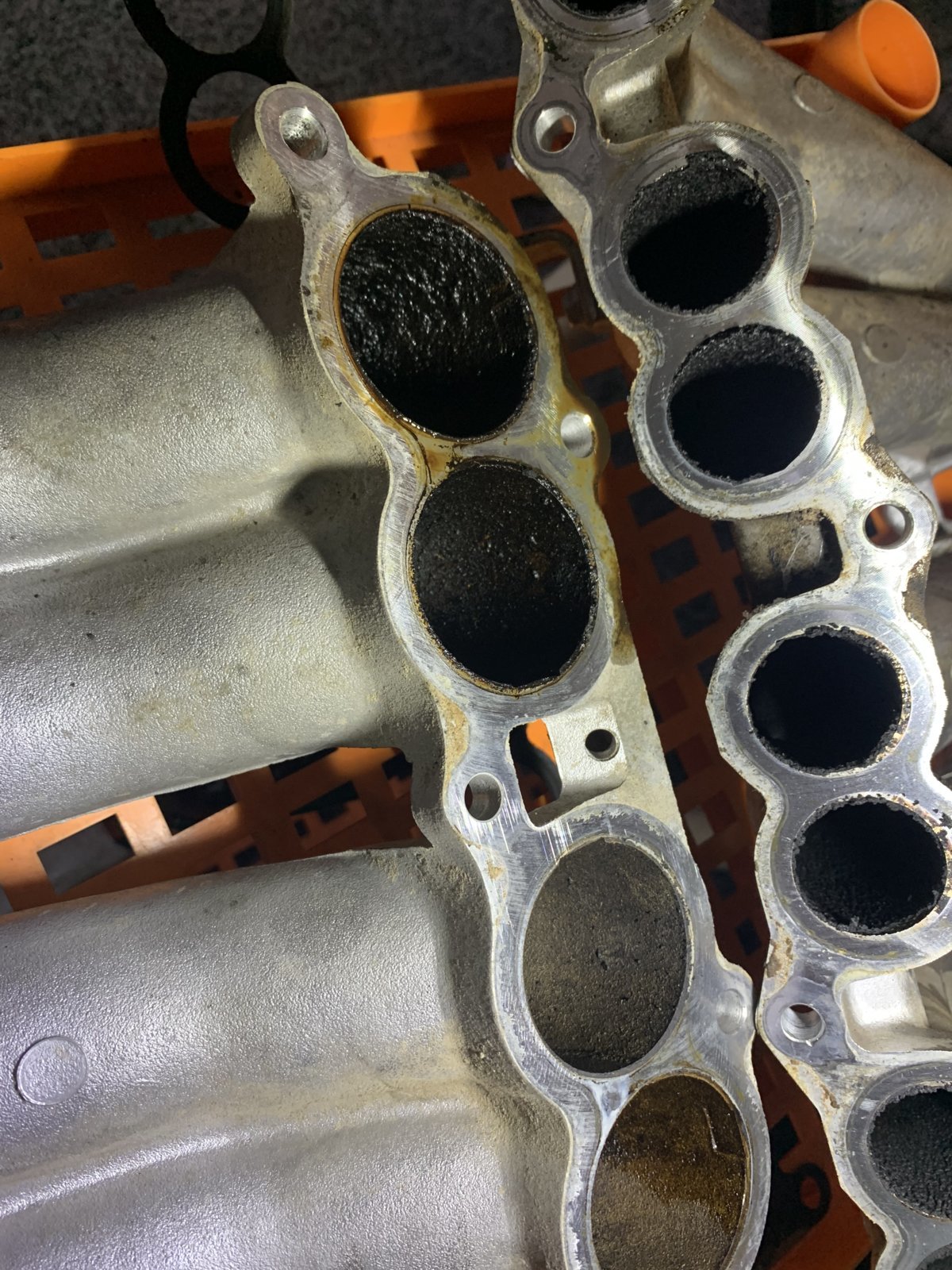

    Clock Volt meter/LSPV Delete/Hyundai 16’s/FP gauge/after 9months of wrenching ZERO oil leaks
    Not too bad, hell went perfect.IMG_3753.jpg IMG_3754.jpg IMG_3754.jpg IMG_3760.jpg

    Any comments on this?

    I’m not sure of firing order
    But front two intake tubes much more wet/carbon buildup than rear two tubes

  15. Dec 15, 2023 at 2:15 PM

    I didn’t notice much difference on mine, all looked like the worst on yours. Good job.

    Wow that's way more build up than mine had.
    What does that egr and temp port look like on the manifold,
    and your egr valve itself, and the egr tube.
    Any chance your pcv valve is sticking open?
    Is that from blow back, does it use any oil?
    Did you ever do a wet and a dry compression test?
    Leakdown test?
    What does that mean with the front two being so soiled,
    is that the egr stream kicking that across the top of the plenum???
    or something with the valves....
    So sorry, for so many questions, but inquiring minds want to know...
    it takes a heck of a lot of work....to become a know-it-all....
    Is there any chance that that's coming backward from the valves??

    I used a good lint free rag with that xylene and got that gunk out of the side of the block ports too. Wrapped around a finger or two. Didn’t hurt and made me feel better about it.

    Everything I’ve read here suggested repeated short hop driving would gunk like that, mine. I wasn’t concerned since it was uniform from throttle to block.

    IF that is true.....I am so screwed...
    I actually avoid the highways.
    I was hoping frequent oil changes would save me.
    I'm a least a 100K from going back in there,
    think I might start replacing that pcv valve more often.
