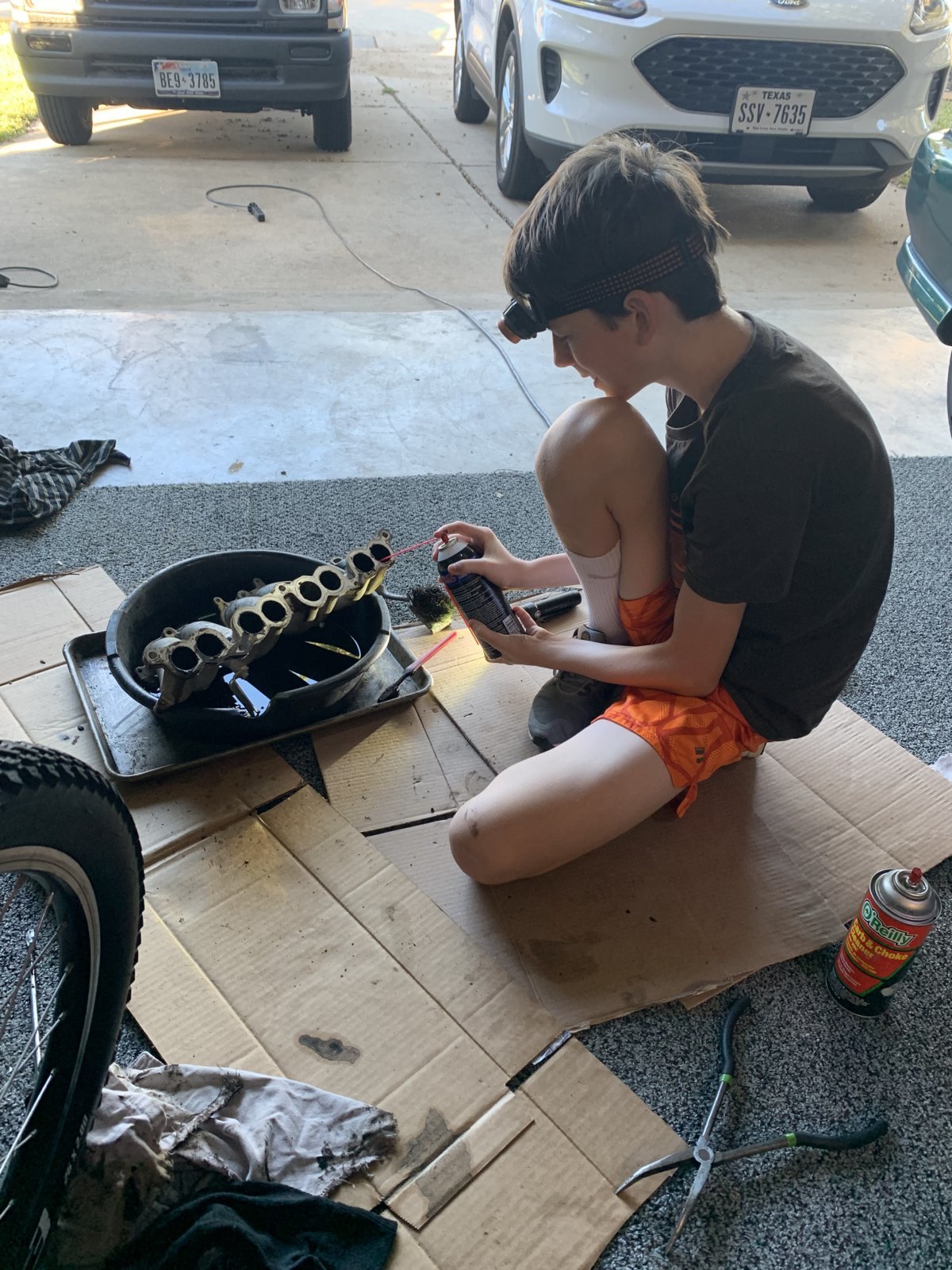

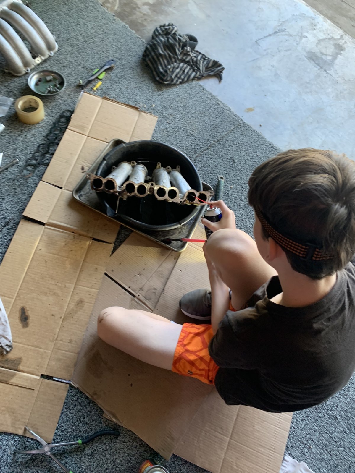

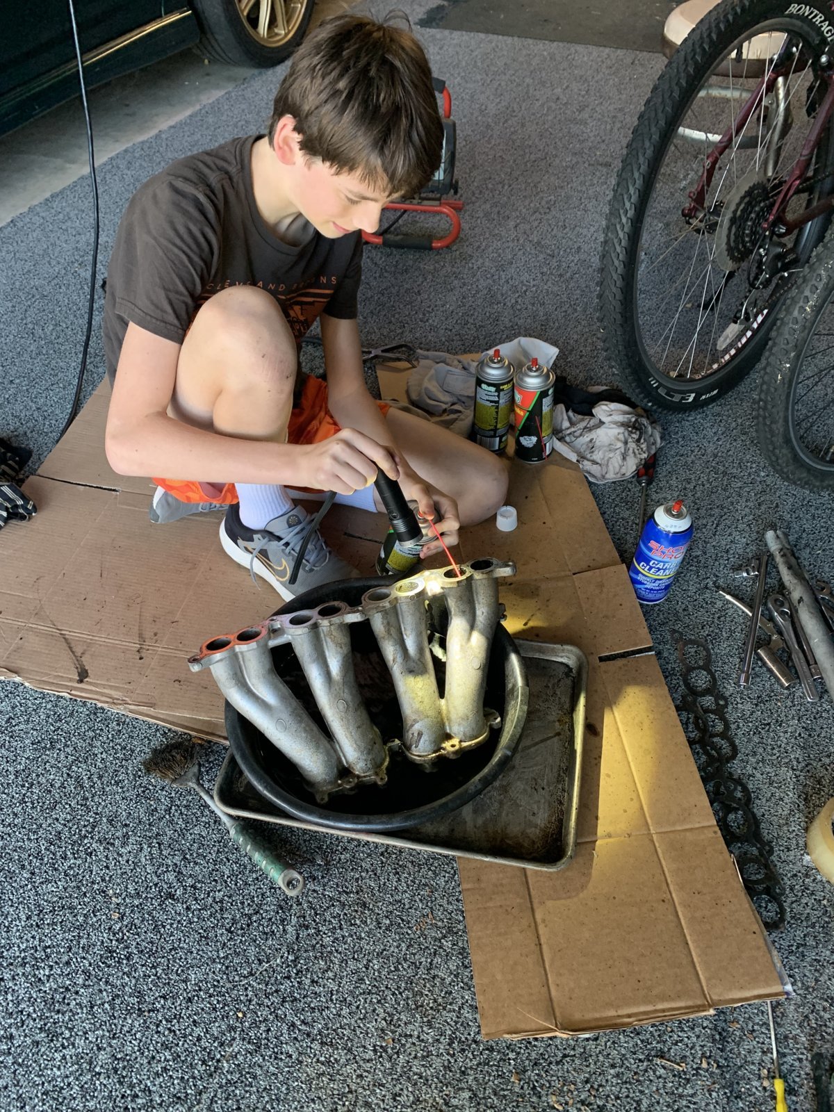

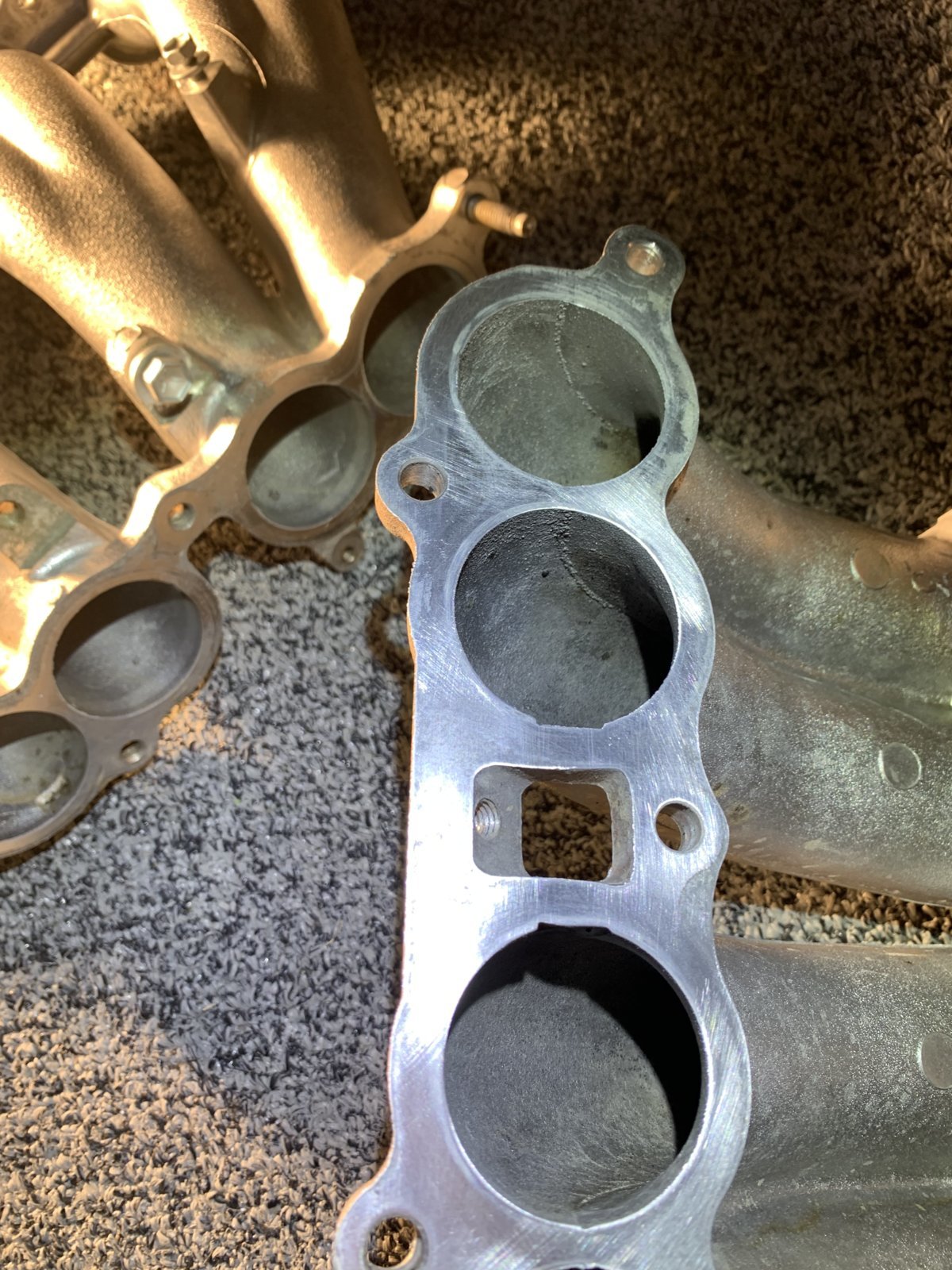

    Got the kid to help!!!!!
    (After he saw how carb cleaner took off carbon, the night before (test spot))

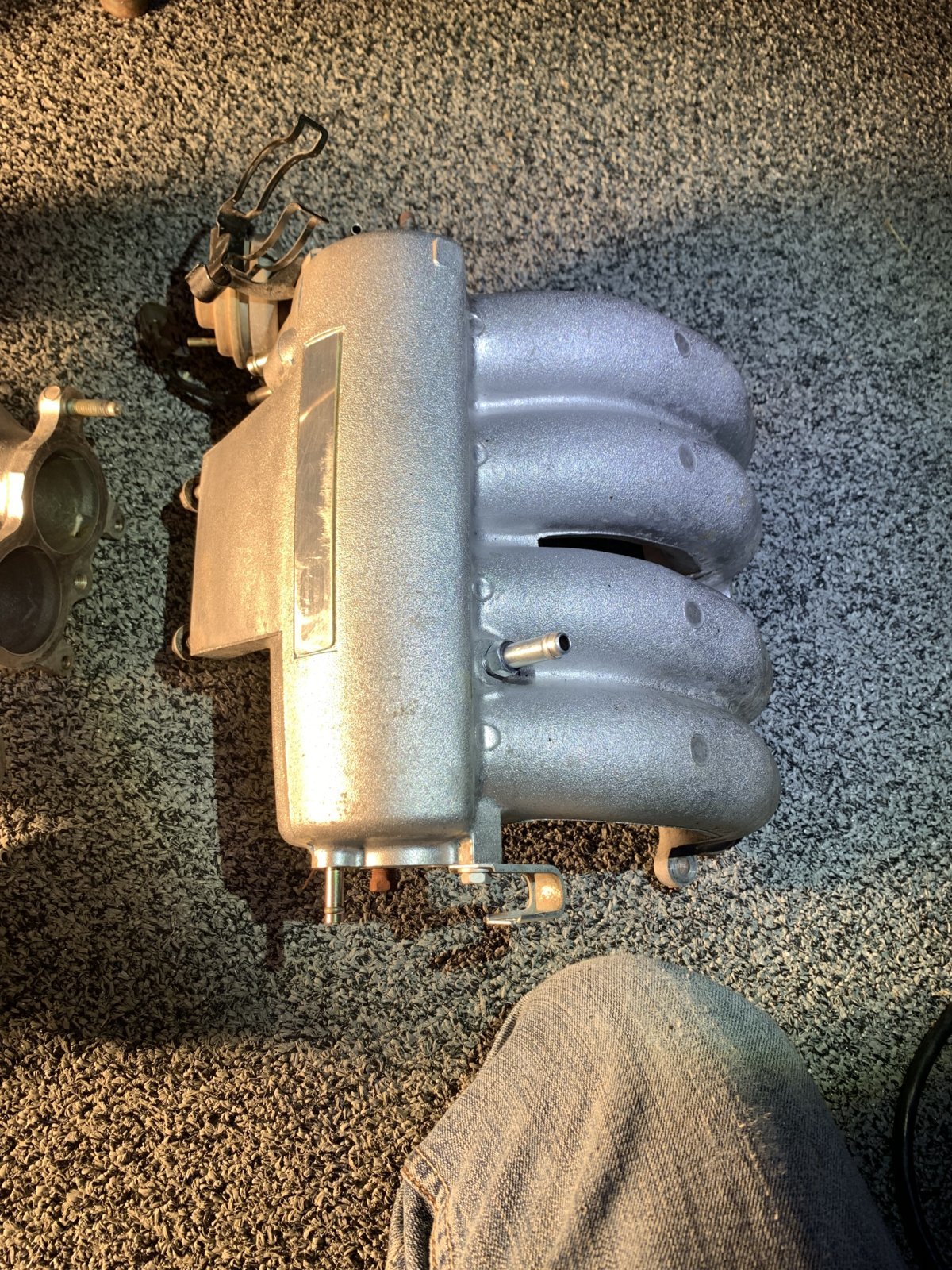

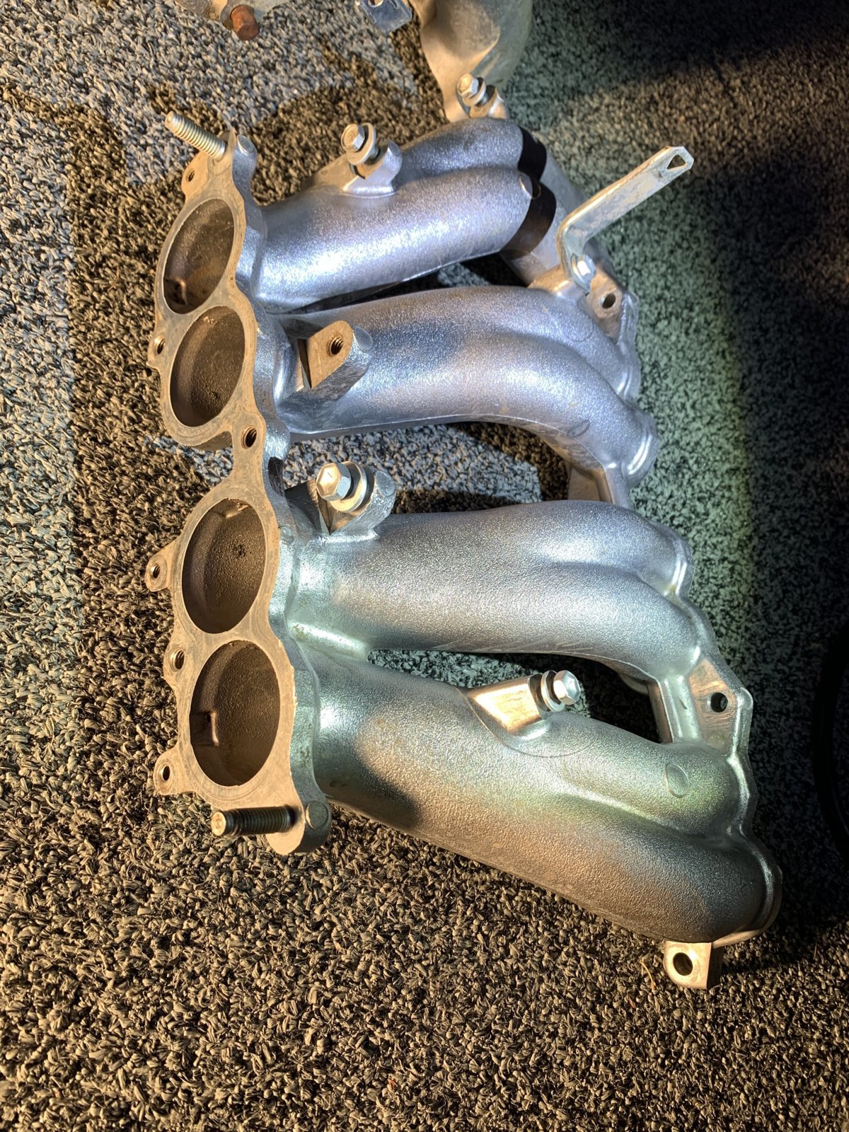

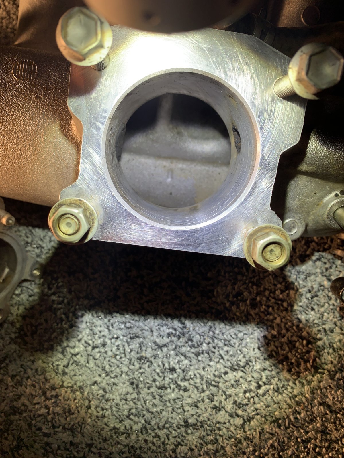

    Not perfect
    But 120% better
    Freakin 8 cans of carb cleaner/1 tooth brush/angled dish brush were collateral damage

    -used acid chrome wheel cleaner on outside (30-45sec set b4 power wash)
    -as y’all explained, wrapped up EGR valve with towel/plastic b4 power wash
    -the ‘16 VALVE’ decal on the IM wrinkled off before pwr wash
    glad Kid got lil dirty
    New gaskets AND injector cups arrived today
    Will be busy updating 2 threads tomorrow weather permitting
