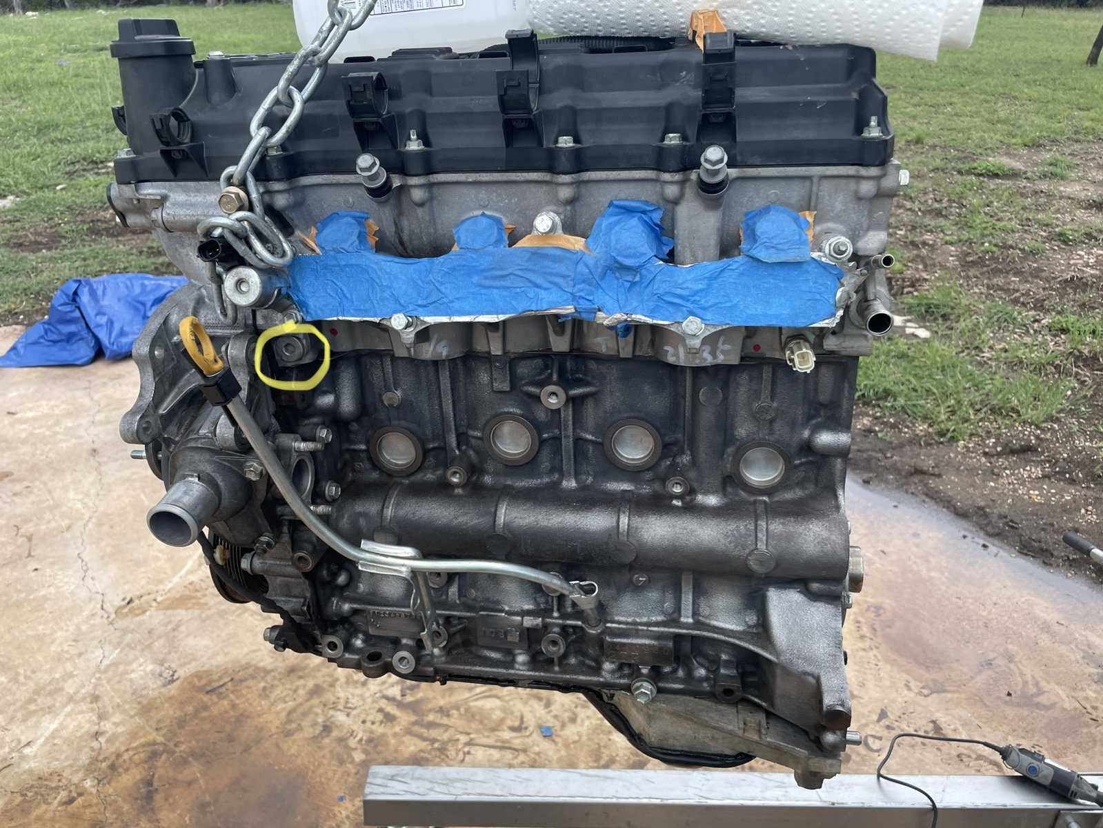

    I bet @BassAckwards knows how hard it is to get to.
    I’d also like to hear his opinion on what that stuff in the OCV is?
    I can’t figure out how it would make it passed the oil pick up screen, the oil filter, and the OCV screen?
    Is there plastic “parts” in the OCV?
    This is an odd one for sure.

    Predator tube steps, Ranch Hand grill guard, Magnaflow CatBack exhaust, Toyota tool box & bed mat, 2LO Module by @Up2NoGood, Rearview Compass/Temp Mirror, Tune by @JustDSM.
    I mean it looks kinda like the RTV Toyota uses but how it got in the valve:notsure:

    Here’s where the filter is you’re looking for. I agree with @Dm93 it looks like that tan-ish rtv that toyota uses on their timing covers and oil pans
