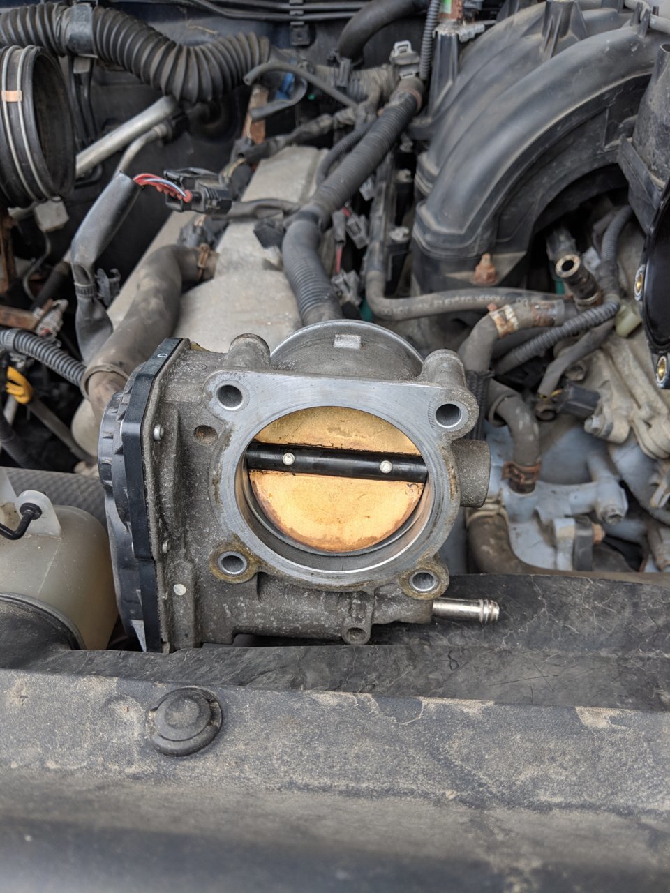

    I was cleaning my throttle body and MAF sensor and for the first time decided to plug it in and open the butterfly using the throttle. I had the pedal held to what should be wide open throttle and it only opened maybe 20%. I thought nothing of it because the engine was not running and I figured the computer would not let it open all the way without the engine running. as I am driving home today, I went to give it some gas and it seemed to not want to go. Was my observed observation of the throttle body with the engine turned off he normal occurrence, or should it have opened all the way?IMG_20190505_150526.jpg IMG_20190505_150517.jpg IMG_20190505_150503.jpg

    It did open some, just not all the way. I haven't removed that filter mounted in the air filter housing otherwise, I'd put the scope down and watch it.

    I did not. I let it run for a few and noticed the idle was high then it started dropping then stop and drop a little more and stop again until it was at it's usual idle.
    I suspect buildup was being compensated for by holding the butterfly open a bit more than when it's clean.

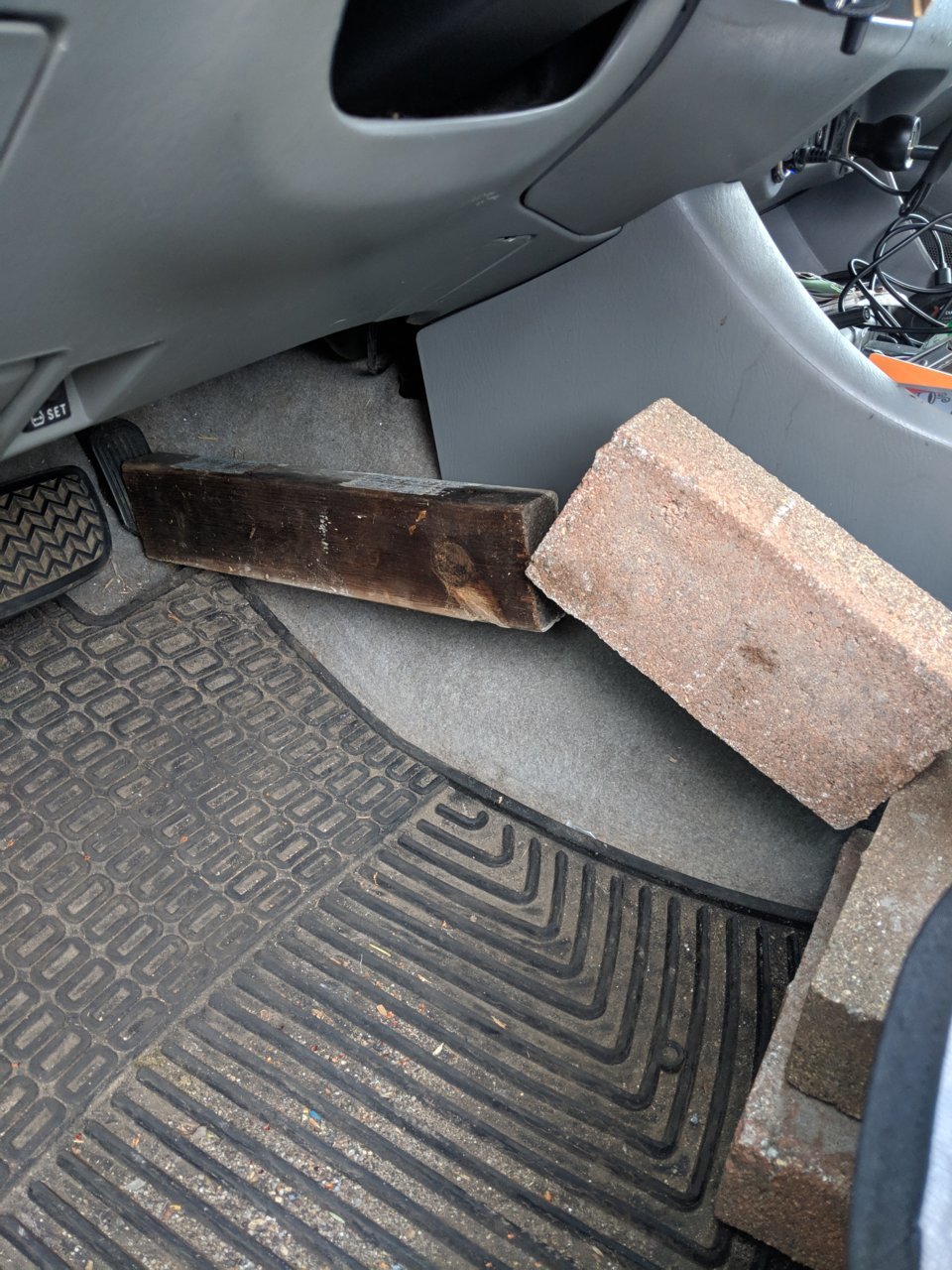

    If you depress the pedal right now will the throttle plate open? I just did a service on a Highlander with the 2gr and with KOEO (key on engine off) and a pedal depressor on the throttle the plate opened all the way.
