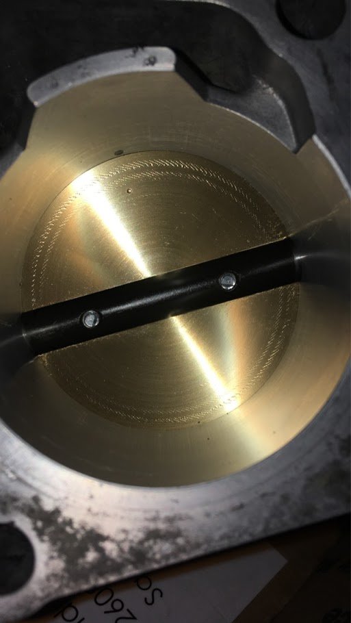

    Did you look to see if you have a gap around the butterfly and the throttle body wall after you cleaned it?

    Yeah it’s shown in the first YouTube video I linked. Gap wasn’t as visible until I cleaned things out.

    The gap on the top of your butterfly is probably your issue,
    Send the throttle body off to maxbore.com. For 125.00 to have it fixed.
    If you have a gap and air is getting passed your problem is the butterfly and throttle body, both have wear and need to be fixed.

    I’m also worried about how the throttle won’t return all the way. I can get it to idle if I force it all the way closed.
    But multiple people have mentioned they’ve never seen that part of our TBs fail. So maybe the butterfly is getting stuck against the wall (there are wear marks inside the TB) and I’m just forcing things a bit more closed when I press on it.

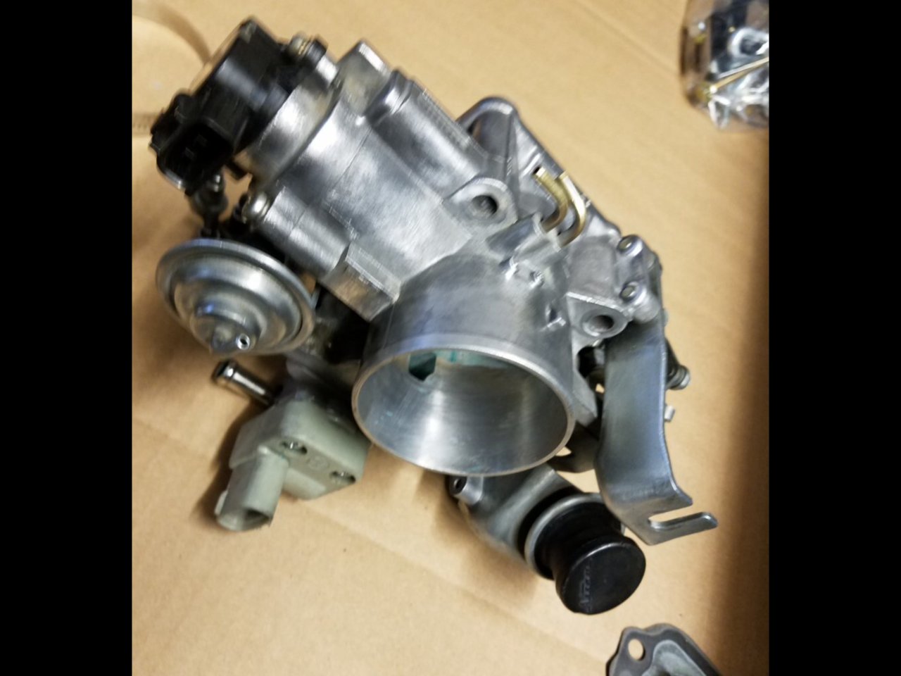

    When the throttle body is rebuilt it is completely taken apart springs and all and put in a sonic tank.
    I would go this route, it’s obvious the butterfly and wall have issues regardless

    Already on it's way to Maxbore. $150 is extremely reasonable after looking at his process.

    Excellent, this service is a bargain and should fix your problem,
    If you have the extra time I took a dremel with a wire wheel on low speed and cleaned the complete throttle body and made it look new again

    My 99 is far from returning to the road. Timeline is maybe finishing it by late October. Just got the TB bored out so it wouldn’t hold me up after frame and body repairs.
