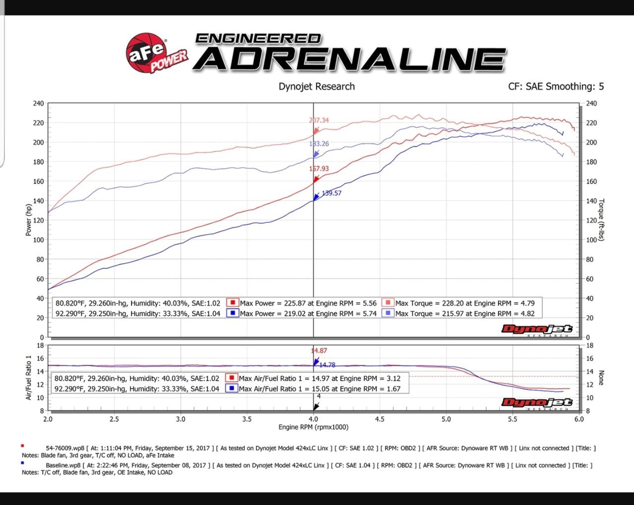

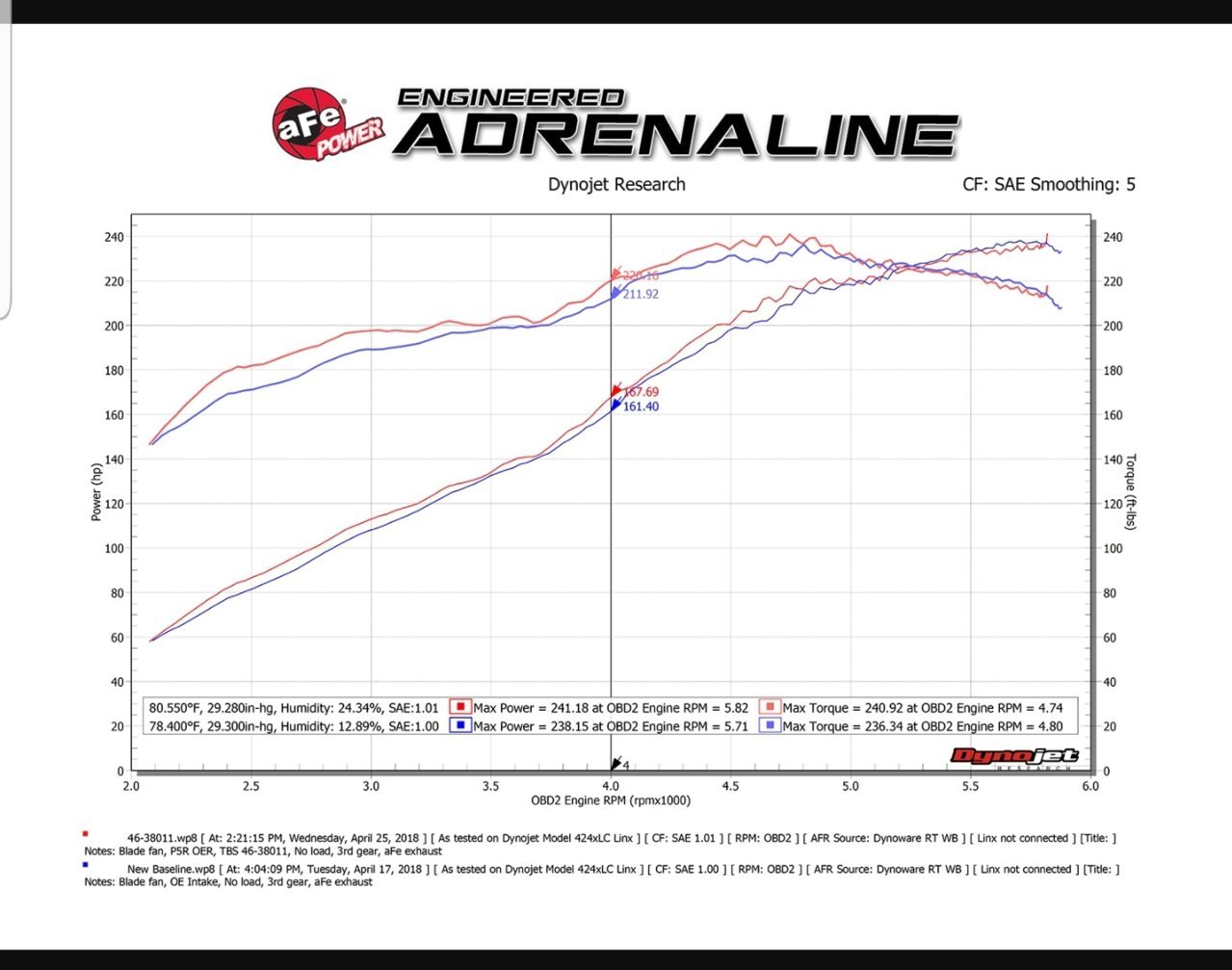

    Dyno results for the TBS and Intake

    Admittedly, the greater increase is seen in torque (vs HP) and the intake & exhaust generate more power than the TBS (which was thrown in by afe).
