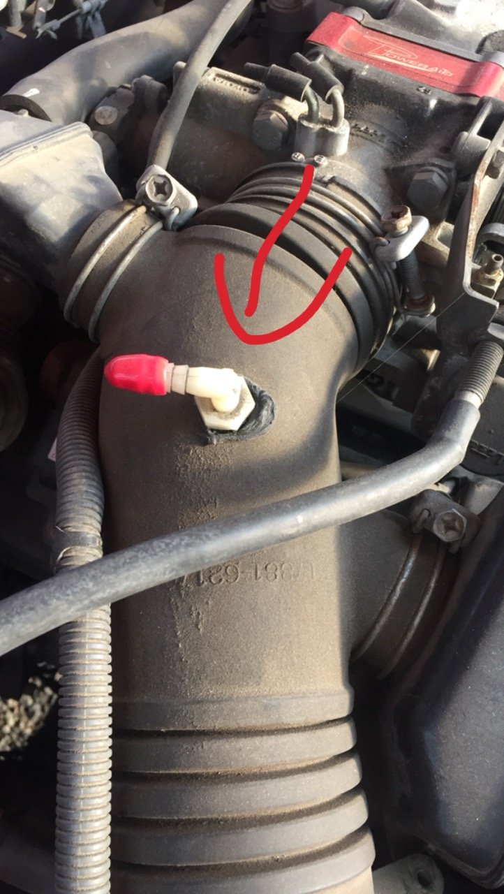

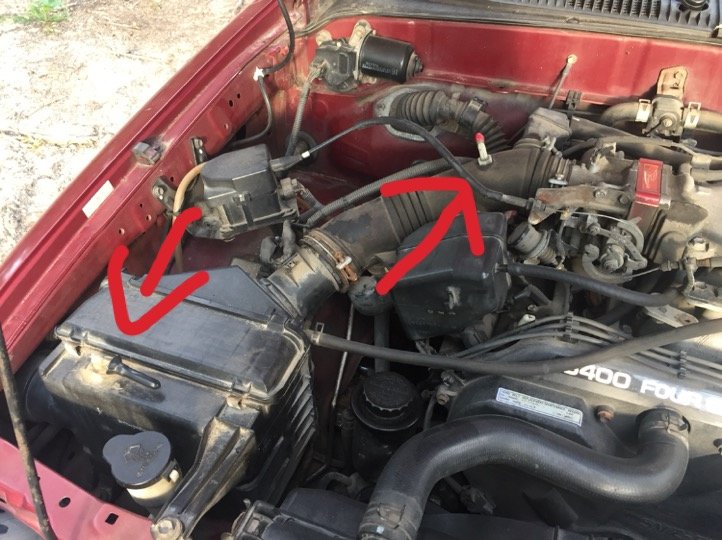

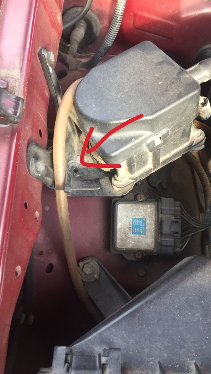

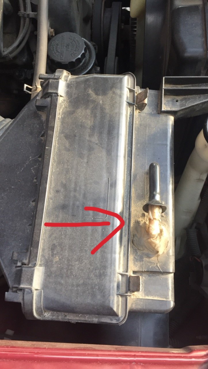

    B56BD66E-2770-4686-A1B7-E4A523649143.jpg 8A064693-C57E-4C7F-87D6-D76334700E11.jpg 3444F960-CF0B-4DF6-907C-6762E8086895.jpg 646C116E-3570-4CB1-9DBA-33CDA40EAC77.jpg
    So i finally got around to getting some pictures today, i have no clue what these are for. The one with the red cap is very loose and probably leaking, would that cause the p0171 code? Also I added a picture of a line that does not look factory and I dont know what that is either.

    Yeah, no good. Can’t have unaccounted for air after the MAF. Causing your code. Get a new snorkel. The thing at the airbox is most likely related to the charcoal canister system but is before the MAF so not really a big deal, I have no idea about that line by the cruise box. If it’s a vacuum line it should be fairy obvious where it goes.

    I wonder if the one after the MAF was used for a homemade hydrogen system put in by the previous owner

    What's the first pic?
    Yah that looks jinky. I would take some carb cleaner and spray the red nubin. If the idle changes it's your that's a leak.
    Either way, I would pull them out and see if you can at least seal the red one. It's probably not super high pressure so you might be able to test with duct tape or something. A more permanent fix is to replace it. Silicon doesn't la
    The one in front of the air box - I don't "think" that would do anything. It's before the air filter.

    All that crap reeks of "free hp!" Posts on the internet. The upside is the spacer won't hurt anything unless it is leaking. All the other holes though would have me looking fire replacements. Even sealed it would irritate me knowing it was there m

    Thanks for the help guys, i taped over the hole and cleared the code just to see if it would show back up and it hasnt yet, which has me leaning towards that was the problem. I ordered a new intake pipe the other day because I didnt want the hole in it even if that wasnt the problem. Lol

    Update, I talked to the previous owner and he said that the original owner thought it was a good idea to drill a hole in the air intake to get better gas mileage. :crazy:

    I was about to say that fitting looked like it’s for Methanol injection on a supercharged engine, the nozzle on my truck is almost in the same spot. Albeit a 4 cylinder.
