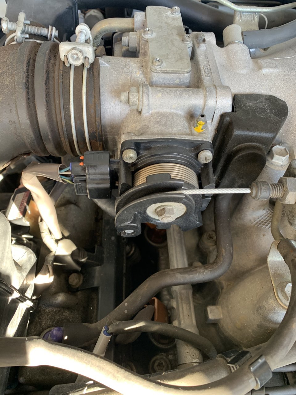

    I have a 2004 Tacoma 3.4L. I can press my gas pedal 1/3 of the way down and do not get any response from the engine. After I pass 1/3 of the pedal I then get an engine response. I replaced the TPS and this did not fix my problem. I have attached a pic of the throttle actuator whatever it is ( not sure what it’s called). It has a four pin connector. One pin i am showing is ground with a meter. Another pin I am getting 5 volts with the ignition in the on position. The other two pins I don’t have a clue. I just hate to buy another throttle body if it could possibly be something different. I really need my truck back on the road. Any help would be appreciated.

    Do you get the same response when you twist the black thing where the cable sits, rather than the pedal?

    Yes, when I twist the black thing by hand where the throttle cable ties in it does the same thing. I do have a guy looking at it for me now.

    It just feels like nothing inside the throttle body moves for the first 1/3 of travel.

    Mechanically nothing moves until 2/3rds pedal by design. The throttle plate is controlled by an electric motor in the throttle body. The black sensor next to the throttle cable is bad. None serviceable item. You need a used throttle body and hope its good on that one. Or buy a new throttle body.

    The service engine light is on and code keeps saying TPS and pedal position sensor. I have changed TPS so it sounds like you are right. Looks like I am fixing to get a new throttle body. I really appreciate the information. I will update as soon as I get one and change it out.
