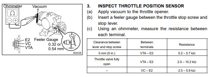

    You do not need a complete new throttle body to replace the TPS.
    The diagrams are a little tricky unless you know all the ins-and-outs of the various options- which is why you are seeing 3. They are likely: 4 cylinder, pre-03.5 V6, and 03.5-04 V6 with fly by wire throttle cable. Unless you knew all of that, it's hard to pick the right one.
    Either way- The TPS is available separately. 89452-35020
    However, I think you should do some further digging to determine if that is indeed the issue before you spend money on it (especially if you're on the job hunt).
