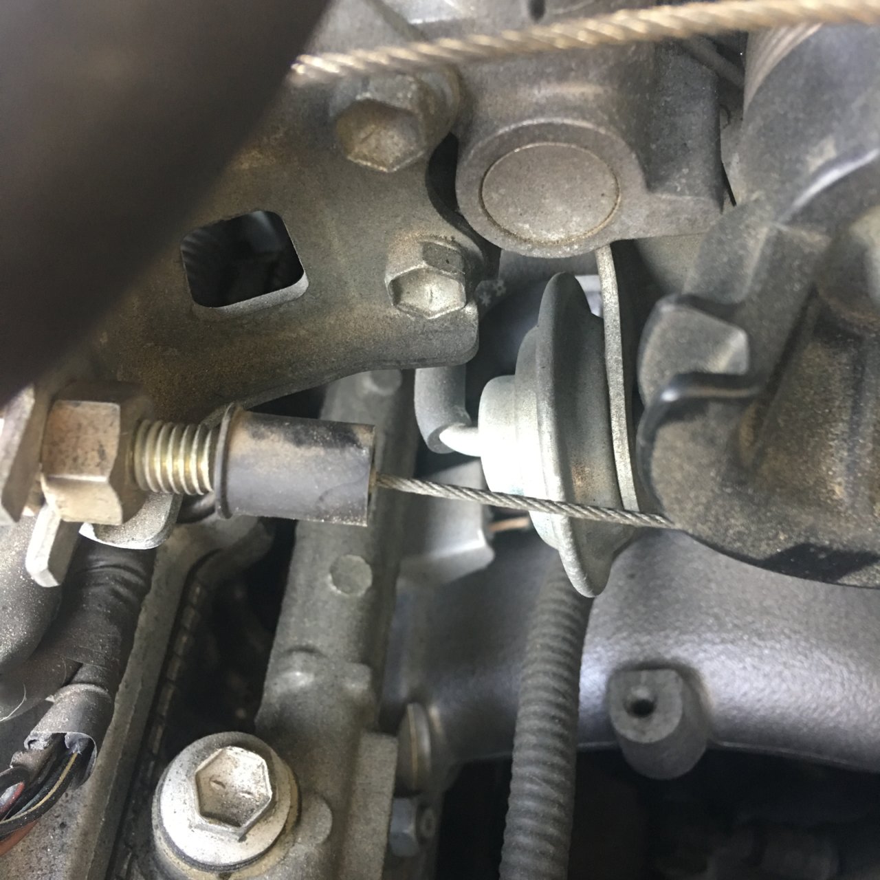

    here is a video of my situation. Is this normal for these tacos? Mines is a 2.7 and I feel like they need to be tightened, but not sure if they are supposed to have some level of slack.
    Let me know what you think, thanks!

    on the lower cable, the one with the black cap, that is you Transmission Throttle pressure adjustment. The little silver tit that is sticking out in your video should not be sticking out that far. it should be flush with the end of the rubber. The trans should shift "normal" after that.

    Thank you for this piece of information! I have since adjusted the cables and the truck runs great now with "normal" trans shift

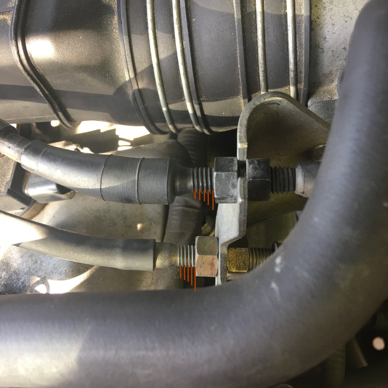

    Here's what I did:
    Aligned the nipple flush with the black rubber piece on the lower cable.
    After that, I aligned the top cable's screw with the lower cable's screw teeth. The lower cable had about 5 teeth separating one end from the nut, so I did the same with the top one.
    Truck runs very fine to me and idles at 700 ± 5 rpms

    Thanks !!!! , I did find out that the correct way to adjust the cables to have the gas pedal to the floor . You then try and move the throttle bell crank and if still movement noticed adjust cable to remove slack
    As for the transmission kickdown cable keep some slack in it for proper operation

    TV cable, loosen both nuts floor it adjust bring the forward nut to the bracket then the rear one to the bracket tighten them together. You need a bit of slack in the throttle cable it does not want to be tight there is more than enough travel in the assembly for WOT.
