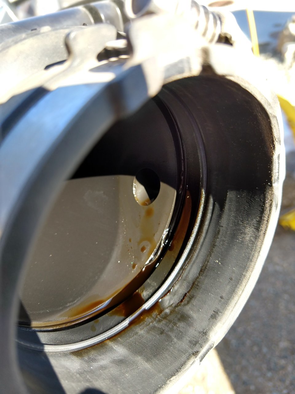

    Or he has one of them janky oil-soaked aftermarket filters?

    Not even 35k from new.
    That residual oil went up into the throttle body.
    And people here say a catch can isn't needed.
