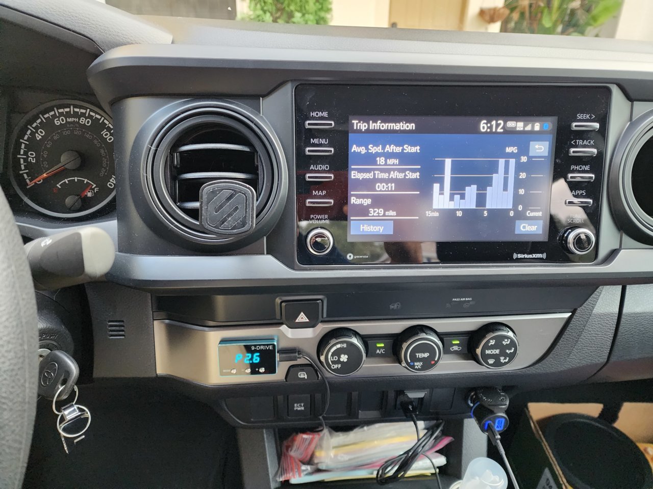

    Installed today a 9-Drive Throttle Controller plug-and-play device, cost about $48 shipped from Amazon.
    9 Drive Throttle Response Controller,Smart Electronic Racing Pedal Accelerator Compatible with Toyota Tacoma FJ Cruiser 4Runner 2003-2009(4th Gen Only) Base,Limited,Limited V8,SR5 V8,Sport V8(821) https://www.amazon.com/dp/B09N8V12HB
    I'm not easily enamored with cheap, disposable consumer items and tend to desire gadgets that approach or are as good as OEM engineering, but after nearly 10 hours of using on city, highway and some spirited driving I have to say the truth - this simple device is a game-changer for the 4cyl gang.
    No longer do you have to floor it and worry if your vehicle is going to propel its' way to safety - this of course doesn't increase horsepower but simply advances or tricks the electronic pedal into thinking it's pushed down further than it is. The real-world effect though is that below 45mph, it simply feels more responsive and perhaps more importantly - safer.
    So far as you can see from the graph, I have no real difference in fuel economy. Avg about 21mpg, which I'll gladly take. Likely will do better over time as I learn to adapt to the imcreased dynamics.
    The effect is incredible and certainly not a gimmick - it makes the 4cyl far more usable and a real viable option vs spending thousands more on a V6 you may not want nor need.
    Rarely can I say there's a $40 device that fixes a car. It's that good.
    Cons?
    It's plastic-y. I'm not necessarily a fan of the somewhat /loose-fitting iPhone plug on the right hand side, may move it over to the left of wheel but for the moment it made sense to install next to the other physical controls I typically reach for with my right hand while left steers.
    Also, the color really should be deep blue to match the instrument lighting.
    Beyond that, it simply works. The end.
    Carry on.

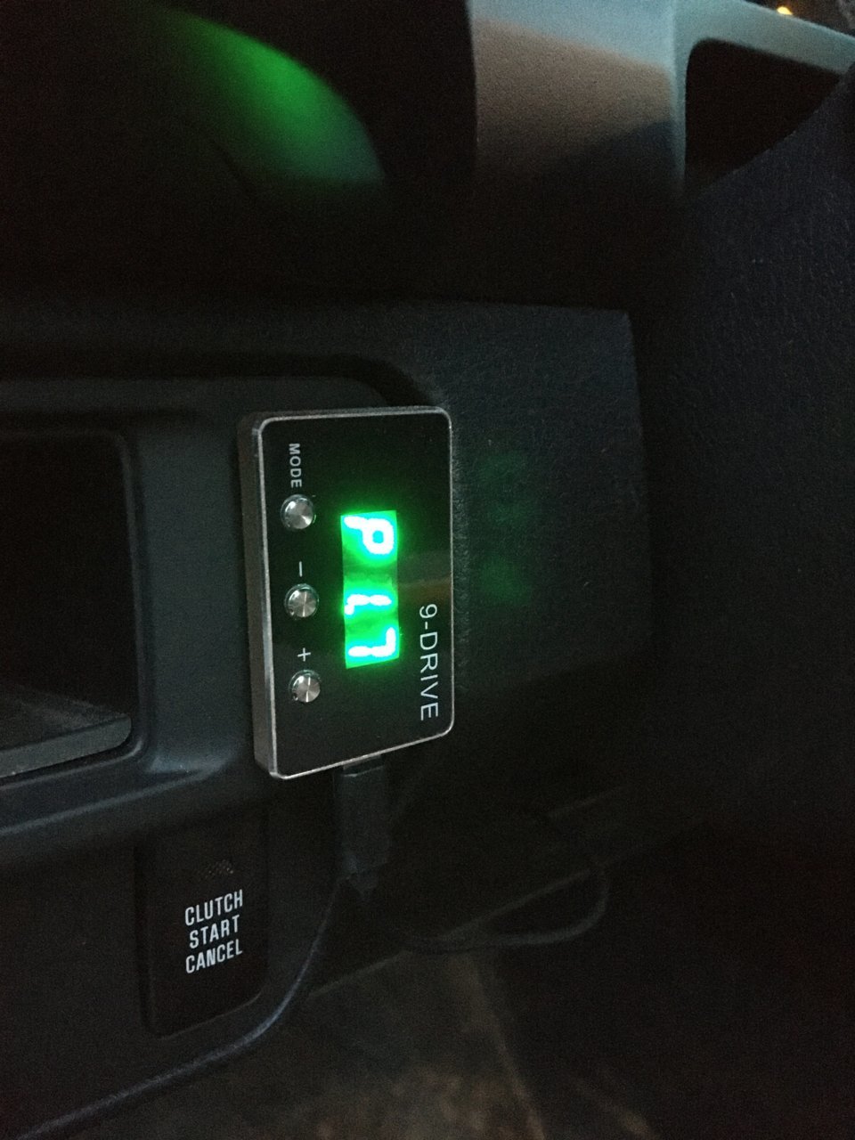

    Ran it for 3 years now, no issues. Run on 1.7 mode with my manual transmission. Works good paired with all my other mods done.
