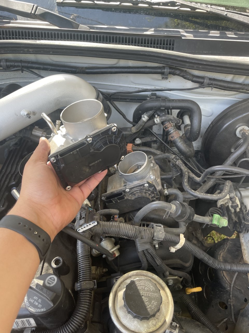

    I just purchased a new throttle for my 2.7 and it’s starting to get stuck open again, just like the old one. I don’t know what to do it’s brand new it shouldn’t be getting stuck open what do I do

    Need more info here
    Throttle body you replaced? And pics if any

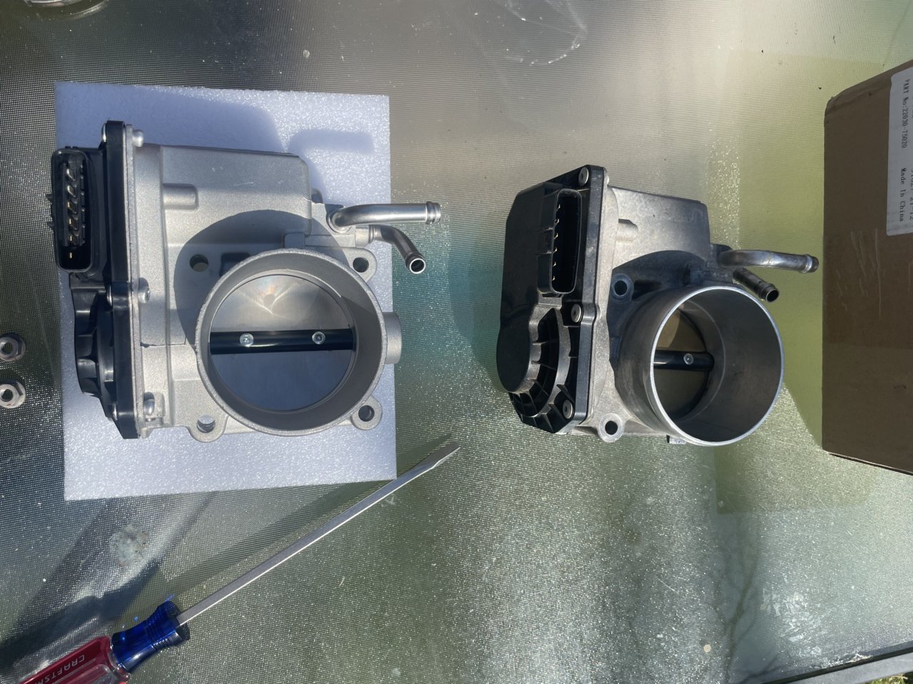

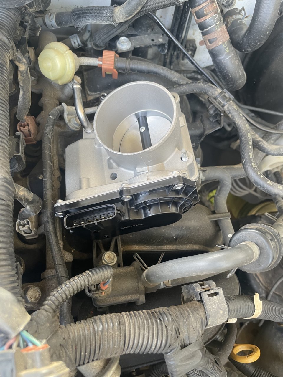

    I think you can tell which is new and old lol, all i really needed was a TPMS but it was easier to just buy a whole new throttle, but it acts no more different than the old one, getting stuck open even after I left the battery unplugged over night.

    Agreed, need some info and context here.
    Is it idling high?
    Accelerating on it's own?
    Setting a code? If so what code number(s)?
    Physically sticking open?
