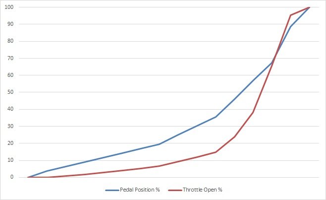

    This all has to do with throttle pedal mapping on the later tacos (12+ I believe) Same applies to later 4 runners. Essentially rather than your 07 4 runners closer to linear throttle pedal mapping, the 15 taco has a curve that ramps up which makes you have to be deep into the pedal before much changes.
    HPTuner can fix this and it makes the truck SO MUCH more driveable. Check out the big HPTuner thread.
