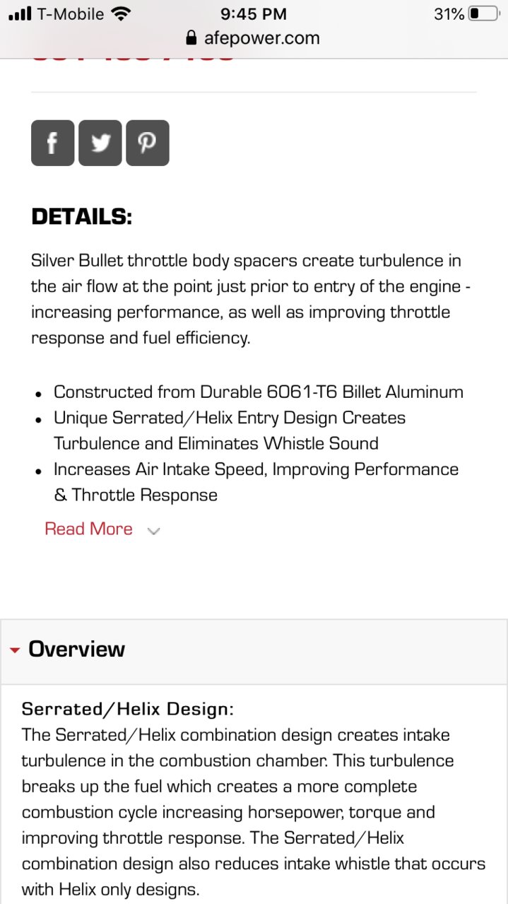

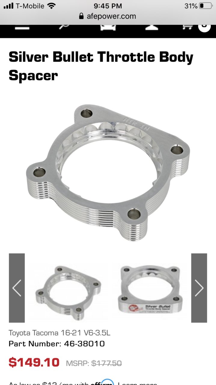

    I did put an AFE Power throttle body space on at the end of the CAI. Do you think that could cause such a thing sticking?

    This is the throttle body spacer I put on

    All 3rd gens have this feature, but it doesn't kill the engine. It ignores the throttle pedal input and returns the throttle valve to idle position. It also displays a message on the center display if it activates.
    I'm going with the throttle plate sticking from the spacer thing.
