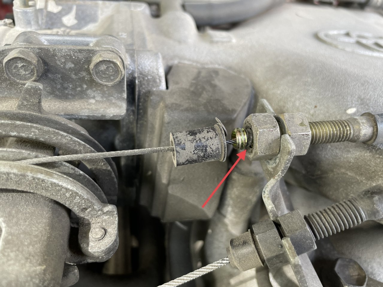

    So within the last week I adjusted my tv (kick down) cable on the throttle assembly. It immediately started shifting like it was brand new. However, today the transmission started making a weird noise, similar to a small propeller or fishing reel.
    I’m gonna try adjusting it back to see if the noise persists but either way I’m kinda panicked.
    Any ideas on what’s happening?

    Update:
    I adjusted the throttle valve cable back to how it was and the noise seems to have gone away. However, it appears the cable was stretched out or something because I’m unable to adjust the linkage to get the rubber stopper into spec without it causing issues.
    I’ll probably have to replace the cable and see if that fixes it. Luckily I’m already in the process of draining/refilling the atf so I needed to take the pan off anyways.

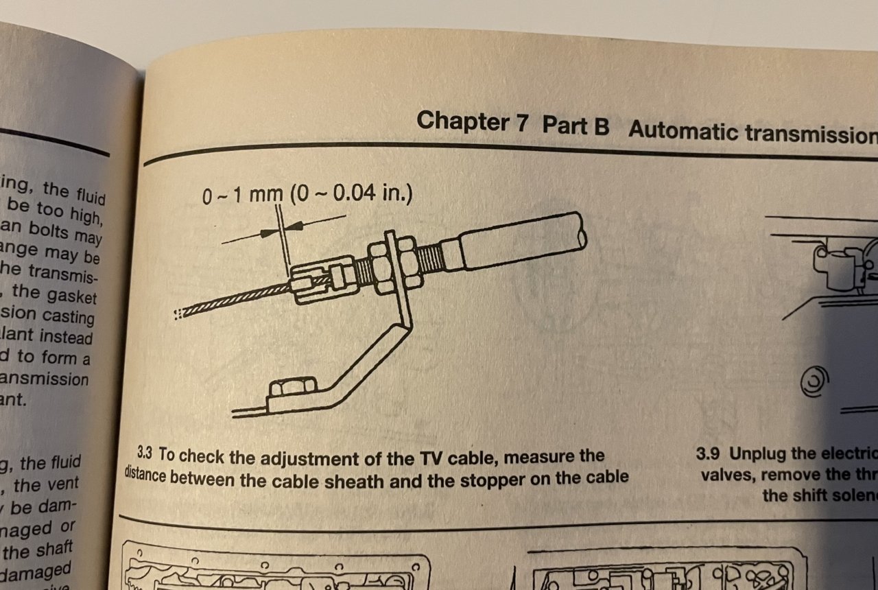

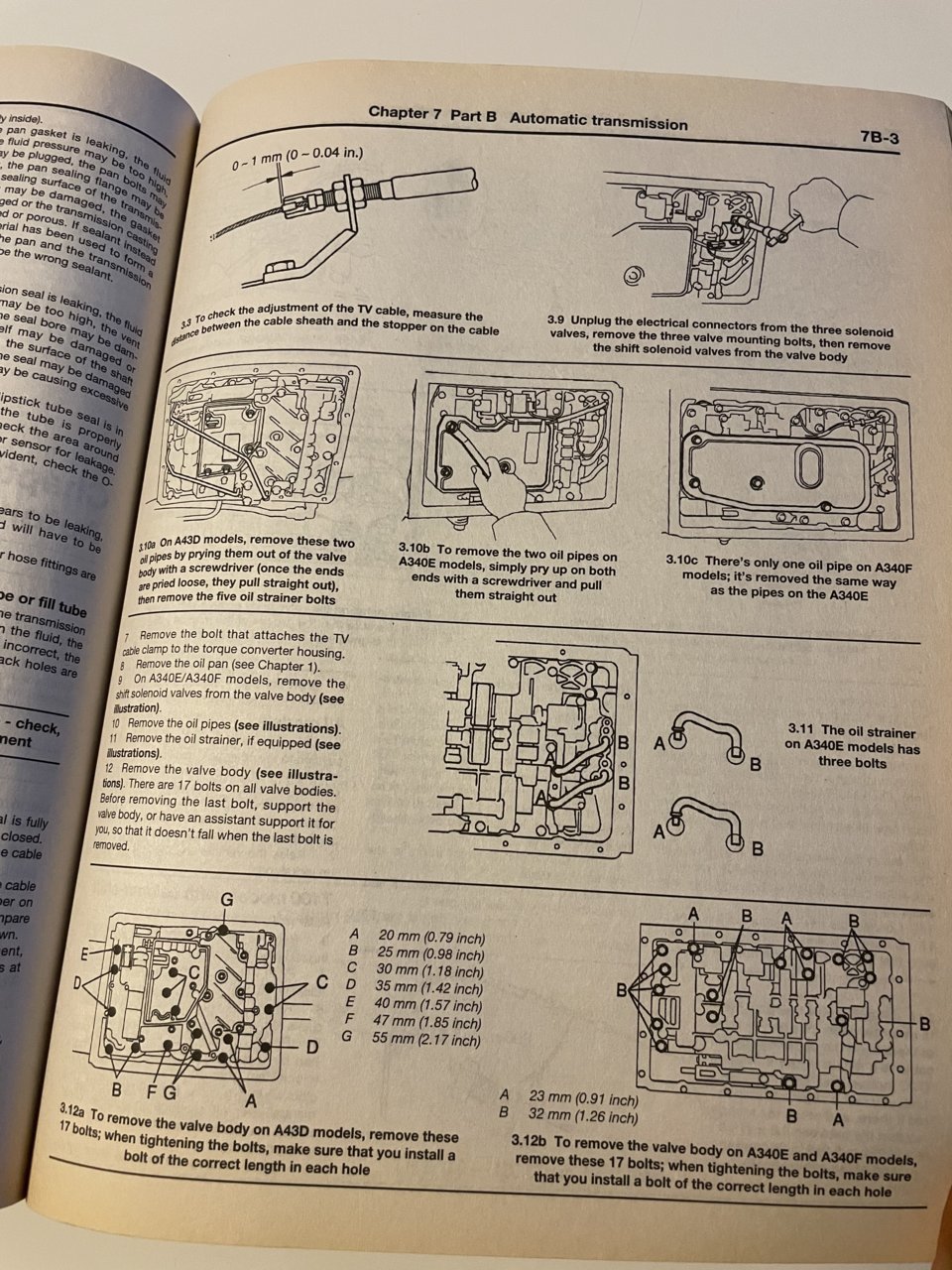

    I appreciate you responding with your experience, it helps a ton. I started digging into how to replace it and it seems doable. But I’m still confused on how it got “stretched” or whatever.
    So far I’ve had good luck with the Haynes Repair Manual on this truck, but I’d still like to track down what the FSM has on this topic. Here’s what Haynes has on it…

    But I swear it wasn’t my fault haha

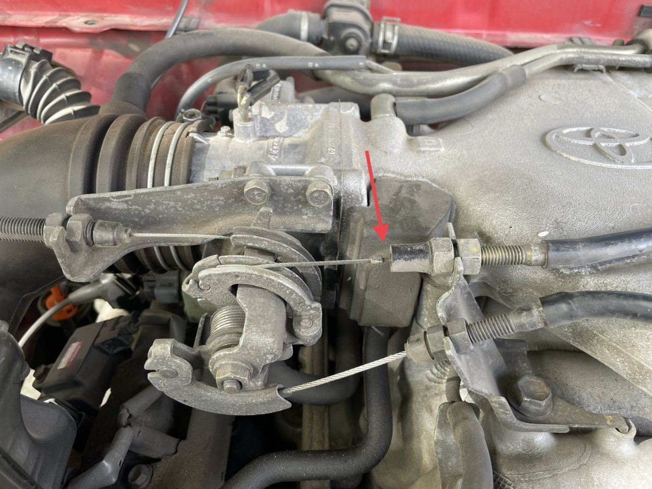

    It had been shifting a little aggressively so I was trying to get the rubber sheath into spec (as shown in pic below).
    I didn’t realize I was pushing the rubber piece off with the bolts in order to get it far enough.
    Ok, maybe it was my fault…

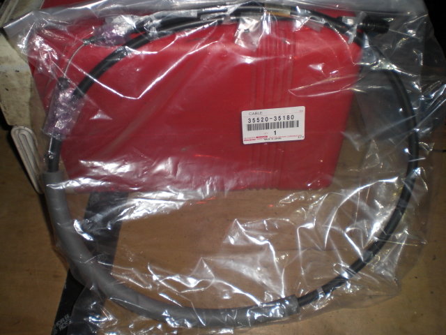

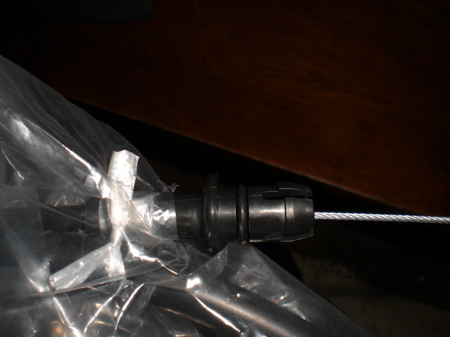

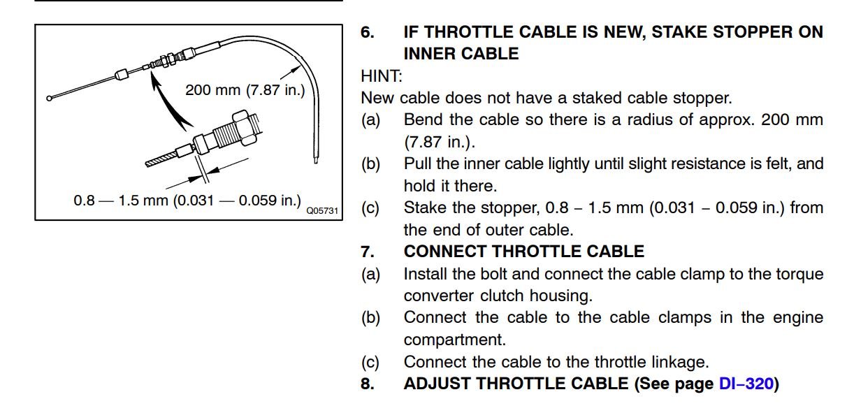

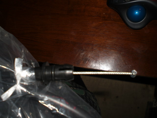

    This is for the 5VZFE - You're obviously not moving the stopper but it gives you an idea on how it should be sitting in the bracket. I'm not sure if that rubber piece is supposed to come loose as it did in your picture.
    If you can't resolve yours, you can order a replacement cable. You'll need to drop the transmission oil pan to replace the cable. The FSM says the valve body needs to be removed but it doesn't.

    Thank you for taking time to get all that!
    That’s weird, the Haynes manuals says to remove valve body too but I definitely won’t be sad if I don’t have to.
    It also doesn’t say jack about installing the new stopper so thank goodness you posted that.
    Since I’m gonna replace the cable, would I reuse the old stopper or how’s that work?

    The new cable comes with a new stopper, it cannot be reused.

    Here you go...
    Precheck starts on p7.
    Also reference this vid which shows replacing the throttle cable with the pan off. It's that simple. Feed it through the hole, secure it and then tighten the bolt which holds it in place. Clean up the old FIPG and then seal it back up. Make sure you use the correct FIPG - toyota seal packer #1281 (orange).
