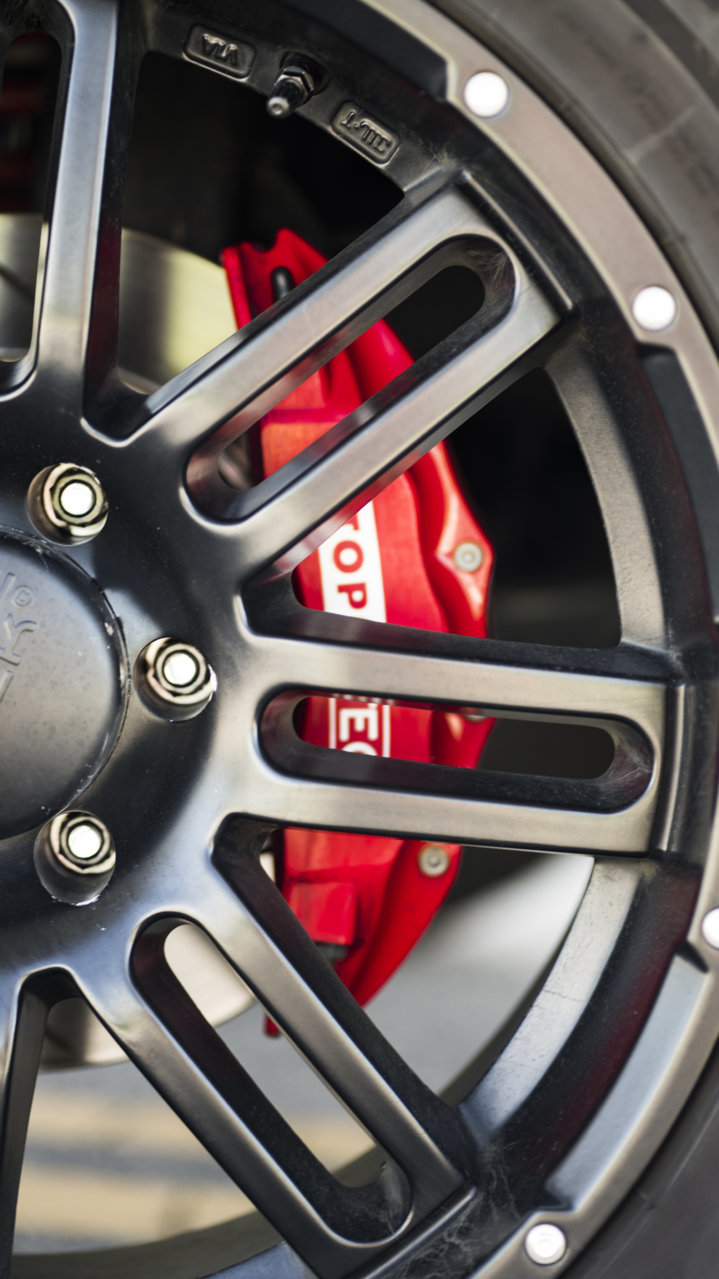

    Mileage and intended use is always the more important factor with wear components than time. I did my brakes at roughly the 4 year mark as well, admittedly that was mostly for the upgrade in braking power when towing and balance the vehicle properly due to added weight.
