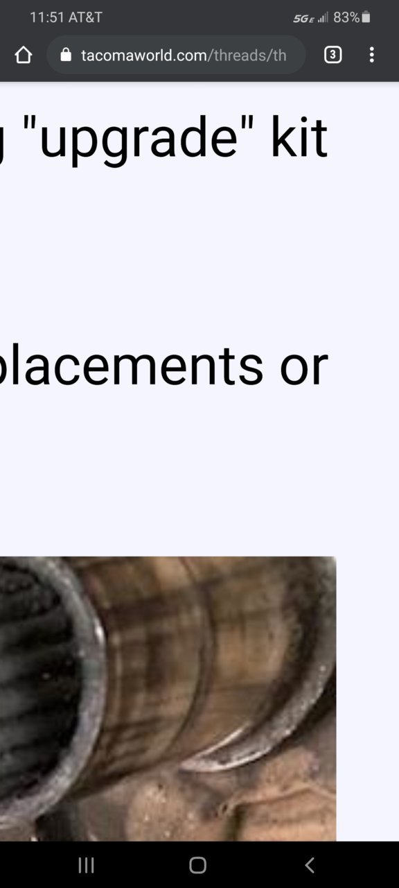

    okay guys I got one to throw in the mix I had mine done 3,000 miles ago with all Toyota parts supposedly it updated bearing as well the noise is back and it's worse and there's a clunking sound now.
    I'm not sure if I replace the bearing and clutch in time and maybe there's transmission damage now I am so busy at work that I do not have time to go and take care of this unfortunately and it is probably going to get worse by the time I get to it.
    All I know is that when we replace the clutch parts it was great clutch felt like new again and then the noise came back about 3,000 miles later.

    The first bearing lasted 65,000k before making the noise so I will throw that out the window.
    I think it has to do with the transmission now. And just excellerorated the cheap bearing.
    As I said now there is a knocking and when you disengage the driveline by pushing in the clutch the noise goes away. I think there is more too this than just simply replacement of a bearing

    I think this sleeve where the bearing sits is the culpritScreenshot_20201201-115145_Chrome.jpg
    But what would be causing the knocking, idk.
    The fork possibly hitting something.
    Nothing should be (wiggling) around in there

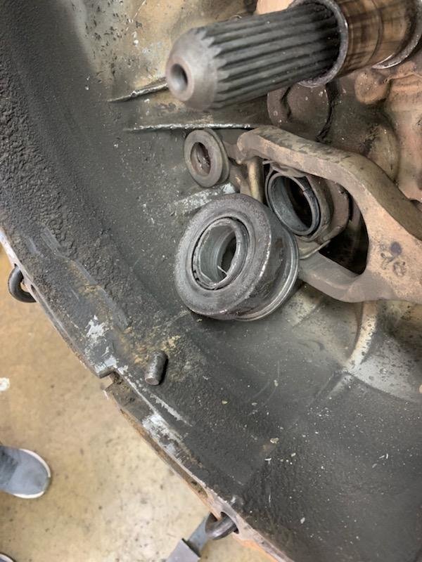

    Could be this as well
