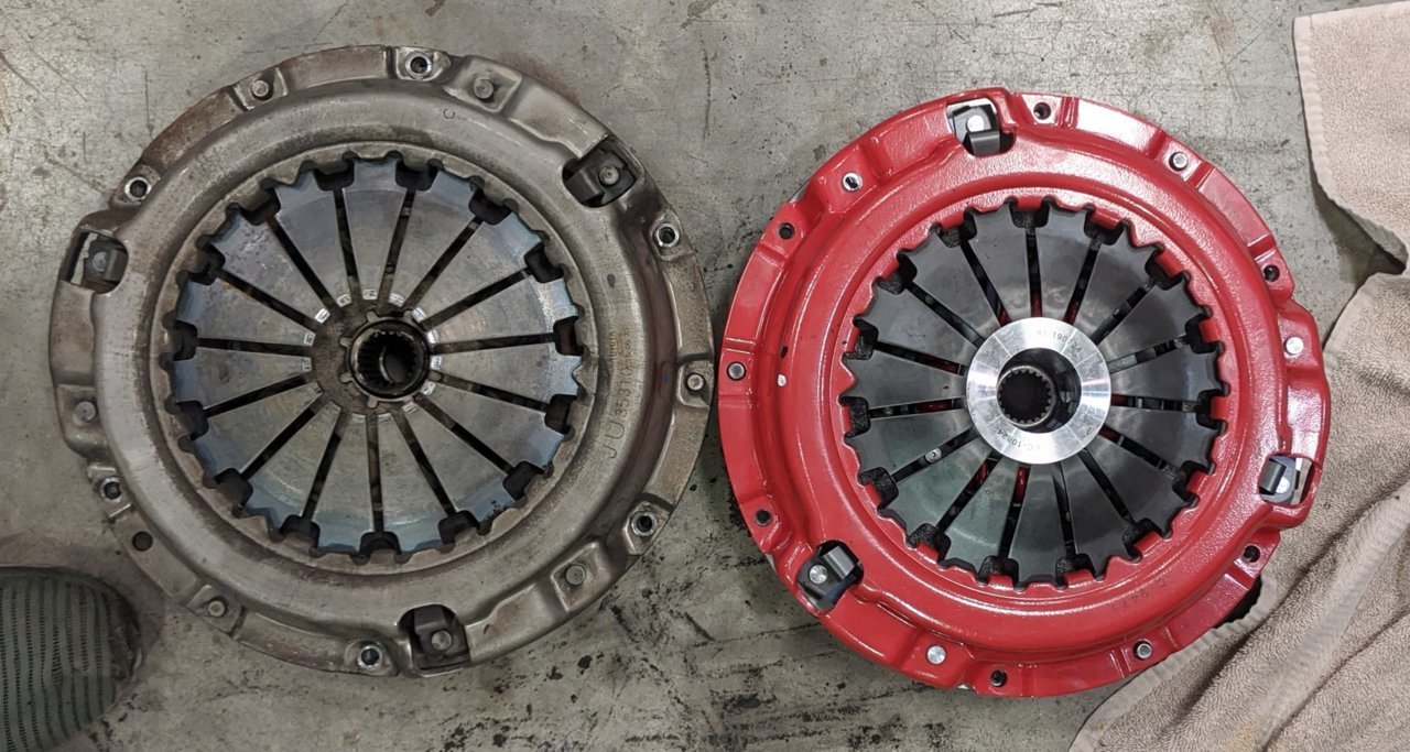

    One thing i forgot to ask you guys, and Gadget yesterday was this....
    OKCR4guiYteE-5LSIEJHMgfbe_sV3CkUS5o6x5Vq_09a253d98773365af631eb412bcbfdf6cf7a9788.jpg
    On the URD pressure plate, there is a metal ring within the fingers. What is that? I understand it runs against the TOB?

    Belleville washer? https://en.wikipedia.org/wiki/Belleville_washer I have used wavy Bellevilles in addition to the conicals. Calculations for use are a bitch tho. Good help you just did.

    Anyone have a picture of this part on our truck?

    No, I am asking if this is the name of his washer he replaced. Not an additional component. Sorry for confusion. :)
