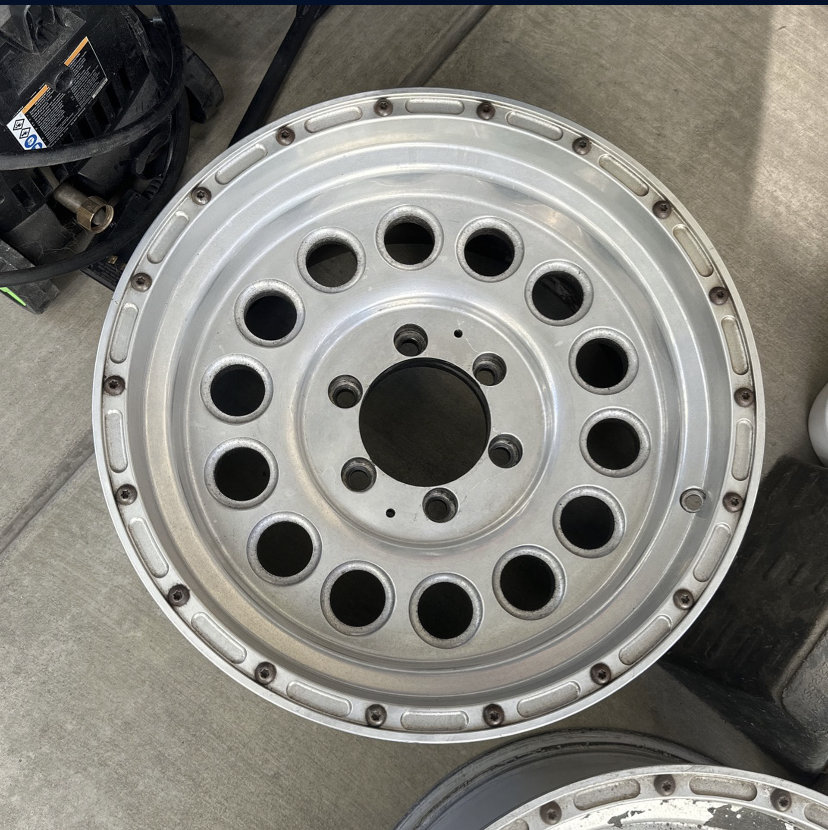

    Looking at picking up a well-used set of these Eagle 102s in 16x8 -20 and giving them a quick refinish to replace my stock 2nd gen OR wheels (16x7 +30) for the MTs. Main purpose would be to get rid of the Spidertrax spacers I currently have to swap when I switch wheel sets. I've only found one pic below of these on a 1st gen, anyone happen to have one on a 2nd?

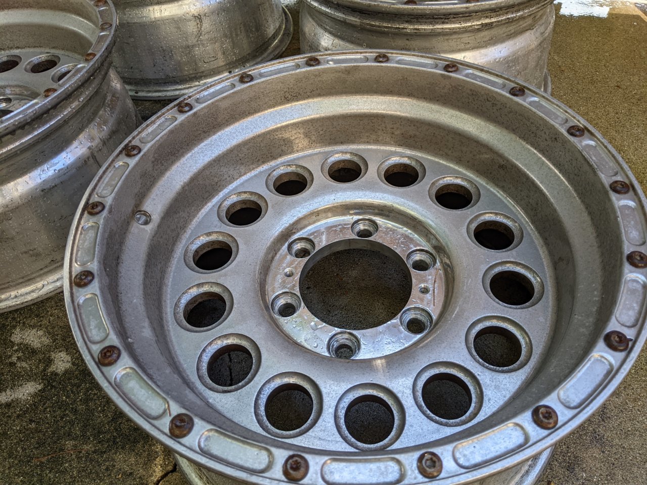

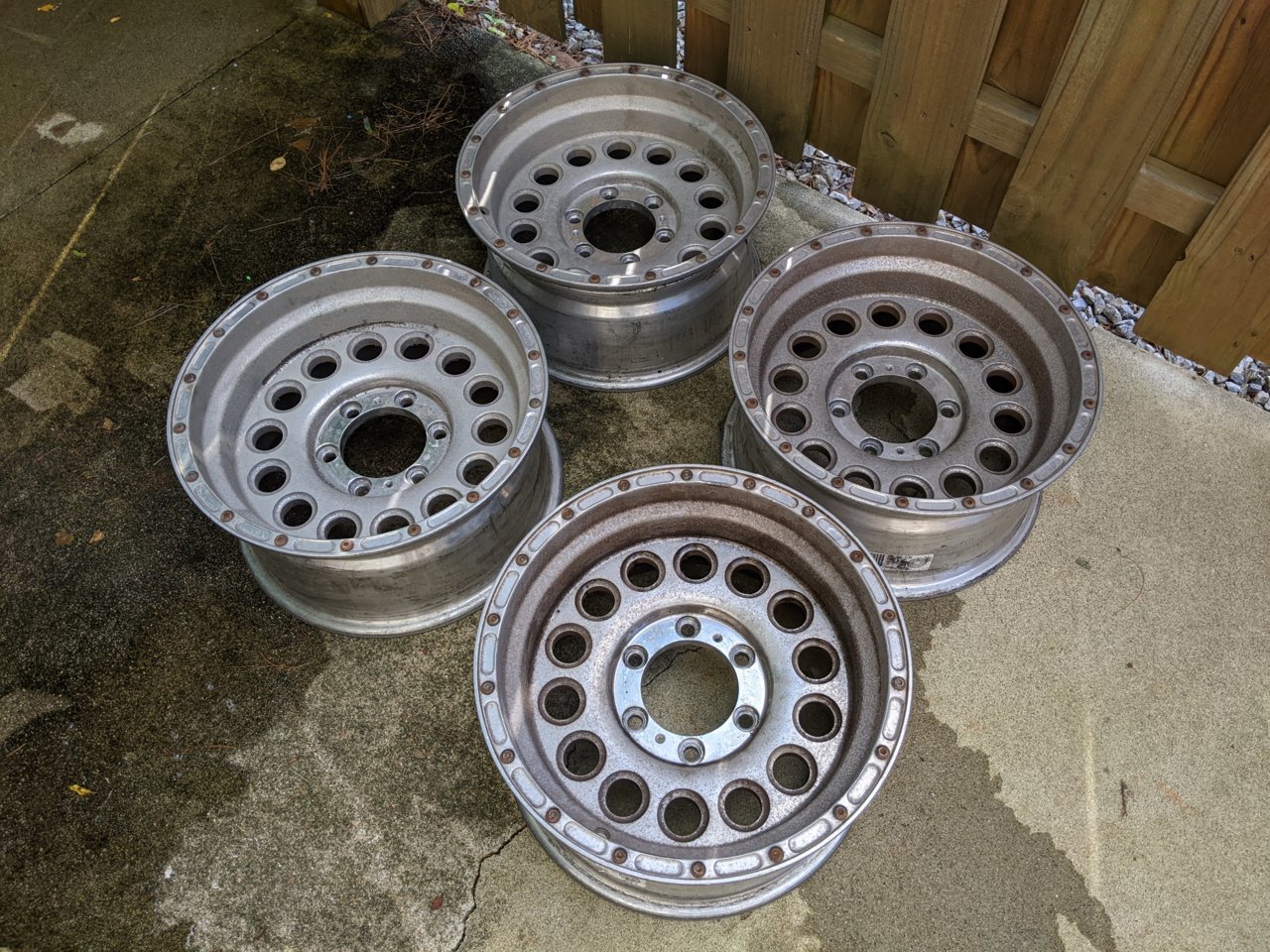

    Started cleaning them this evening:

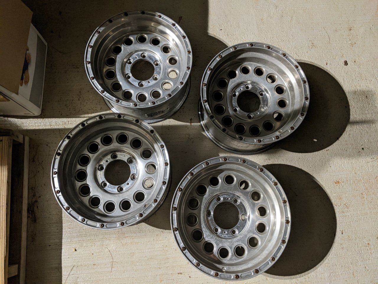

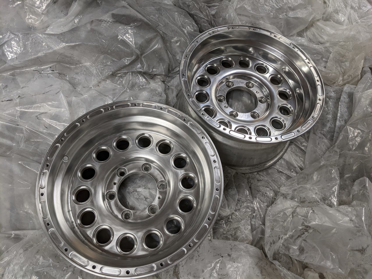

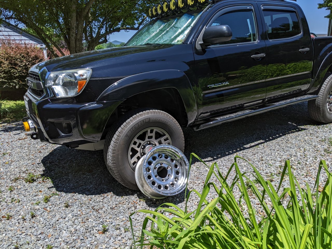

    3 of 4 sanded with 180 grit, 400 grit, and polished with black compound. Need to start looking into sealer or ceramic coating to help protect these.
    First pic shows the difference between 400 grit and black polishing compound.

    Thanks! I looked at blasting and painting or coating them bronze, but they started to polish up nicer than I expected for the amount of pitting they started with. Plus I couldn't fit them in the blast cabinet :)
    I'm up to about $60 in HF polishing stuff right now, including their cheap right angle die grinder. Not sure it's going to last one more wheel though, sounding pretty rough.

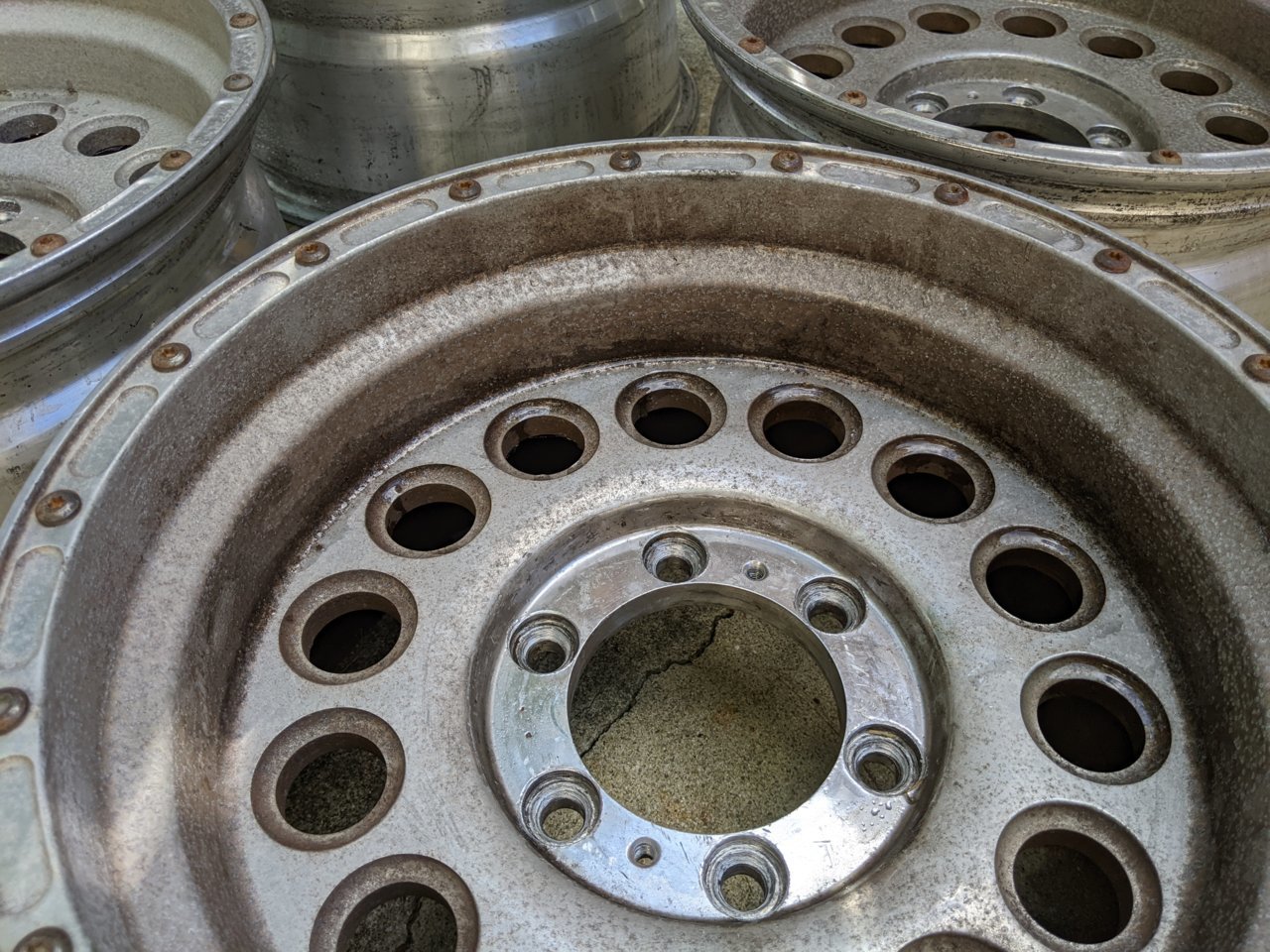

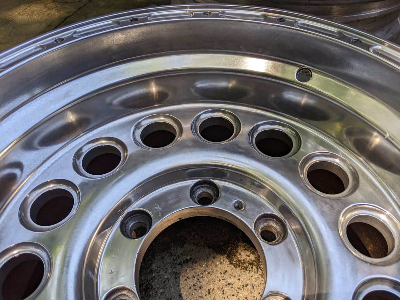

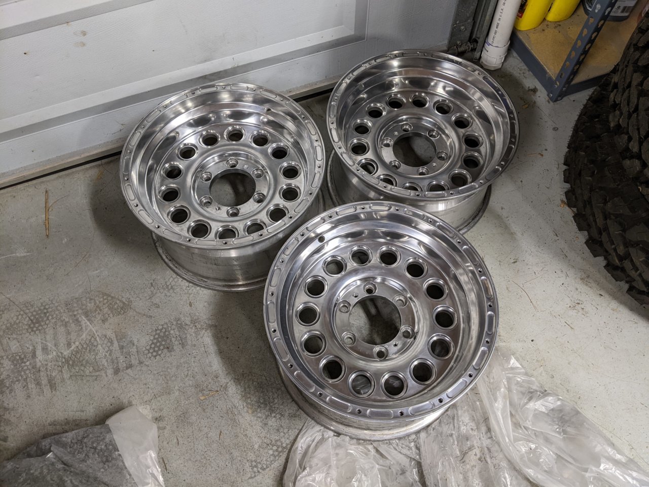

    Progress so far: everything finished with the compound. I tried some Nevr-Dull polish on the bottom right and it looks like it took the compound residue off but didn't do much. Going to give them a wash and then a final shine with Mother's Mag/Aluminum polish.
    Forgot to give a detail shot from when I started:

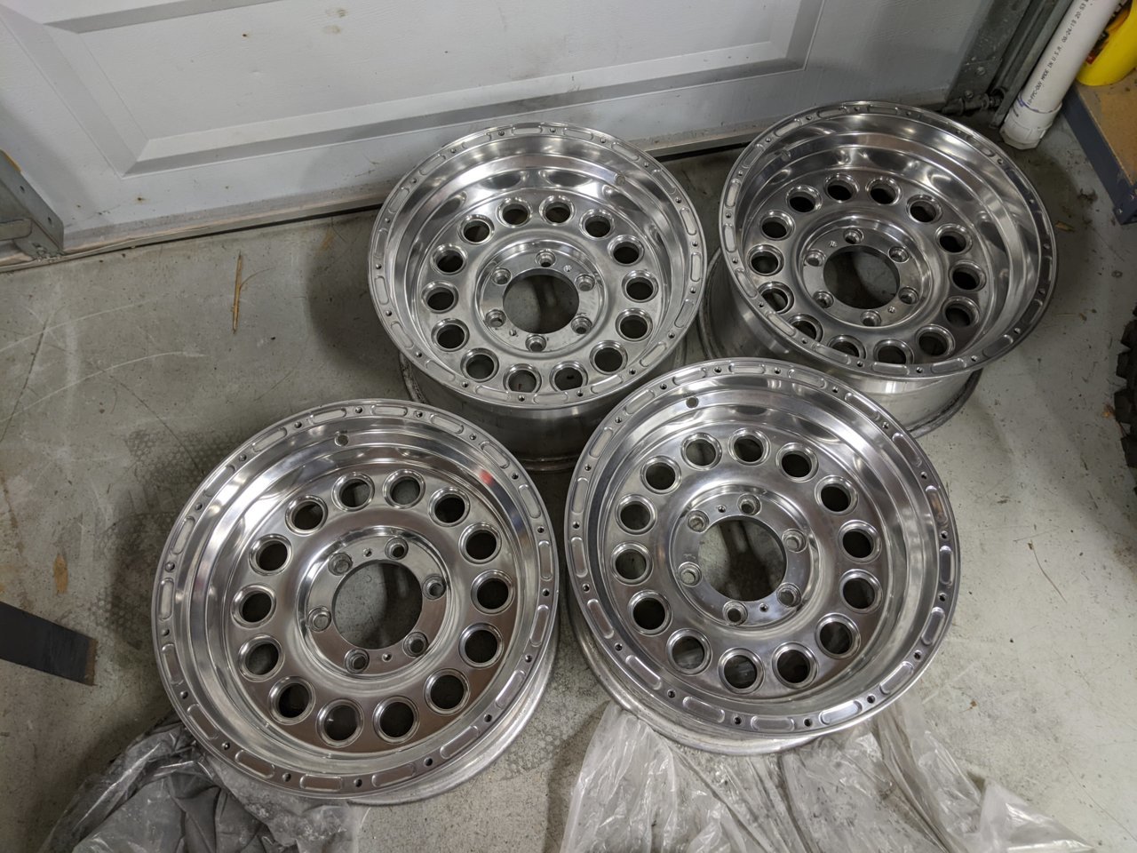

    Finished, and I'm surprised how well it goes with the rest of the truck.

    Here's the final result. Just finished putting the Icon RXT leaf packs in last night, went with option 3. Wheels and tires fit well with no rubbing yet. Happy that -20 offset is working so far.

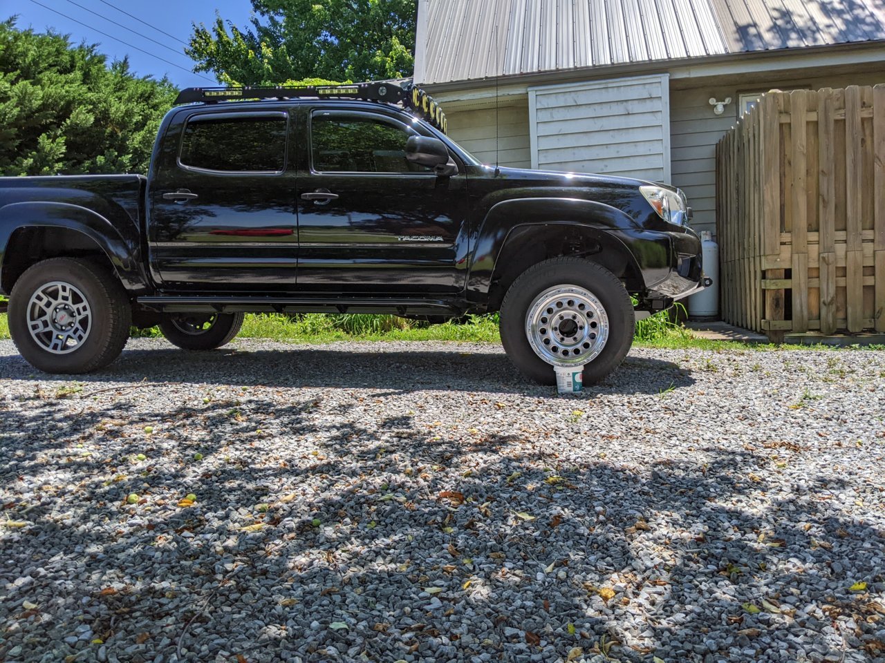

    So I'm going to be the guy who brings this thread back from the dead once again. I'm looking at a set of these in black 16x8 -20 offset. It looks like you had clearance issues with the caliper. Did you use hub rings? Should I pass in these?
  19. Nov 15, 2023 at 1:54 AM
    #19
    clip
    clip [OP] Well-Known Member
    Mar 12, 2021
    #359021
    616
    VA
    15 OR
    pinstripes. lots of pinstripes.
    I didn't need hub rings, and the caliper ended up extremely close to the back of the wheel without actually touching it. Didn't want to risk getting debris in there. I could've clearanced it with a little file work, but the 255/85s were also rubbing when turned and the suspension was compressed. I might have been able to take that out with another alignment and UCA adjustment.
    I'd go for them if you find a set in black. Some thin spacers and different tires could clear up any issues I experienced.
