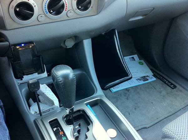

    So recently, I read a post here about where people keptt heir garbage in their truck. I know i always end up having a stack of receipts and gum wrappers every where and hate when it interferes with my cupholders or when its all over the floor:D. Well it got me thinking about that and I decided that I was going to make some kind of glass FRP container for trash in my truck that would fit right in and be easy to reach and clean out.
    I scoped out my truck and determined that the best location for this “garbage container” was right next to the center console by the glove box.

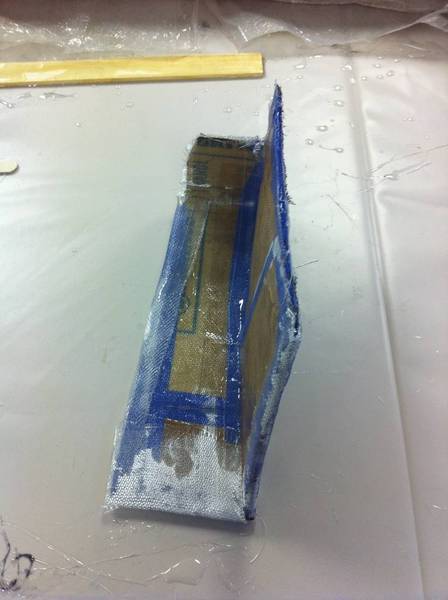

    I cut some cardboard to the shape I wanted and taped it together. This required a few trips into the truck to make sure the angles were ok and that the container wouldn’t interfere with the glove box (very important). There were no real dimensions I took. I just winged it. I'm sure you could take dimensions but I was more exited about getting started.:rolleyes:

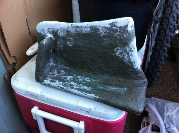

    I got ahold of some glass fabric and epoxy from work and began wrapping the cardboard in it. The stuff I used was something we had laying around, nothing special. (There are plenty of hobby shops and online stores that sell glass fabrics and epoxies for this type of thing. I think I saw some at Home Depot too). After laying down the first layer, I let that whole assembly cure so that the cardboard wouldn’t get soggy or deform. The next day I added a few more layers of chopped glass mat. I found it helpful to pull/ stretch them apart. This made it easier to work with especially when forming the corners and the sides. I let that cure another night. The next day, I sanded the edges down to get rid of any prickly glass fibers.
    Then I went to Home depot and bought a small container of Bondo-Glass. I would recommend sticking to just Bondo without the glass because the glass made it more of a PITA than it should have been.
    Then I sanded the heck out of it, recoated and sanded again!

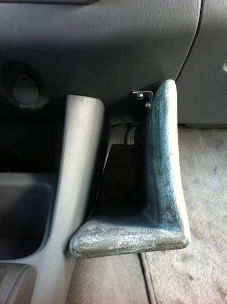

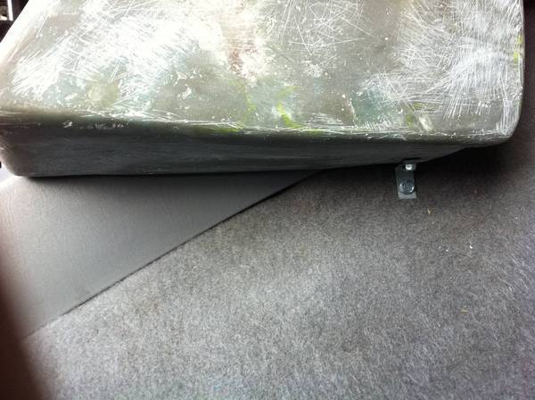

    The next step was mounting it into the truck. I used 1”corner braces (also Home Depot) and 8mm x ½” hex bolts. Make sure they’re hexbolts because the mounting is tight.
    I chose two mounting locations: one on the underside nearthe back and one on the top inside near the front. I mounted it, made sure everything was nice and secure.

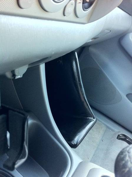

    Finally it was off to the painting. I painted the whole thing with a textured black paint. Three coats followed by 2 coats of clear.
    The thing took me a few days to build. I’ll probably end up slapping a big sticker on the outside wall since the texture isn’t perfect.

    is there not a big open space in the top back of it?

    Yup. Thats where taking dimensions would have helped but thia thing is like 8 inches long so the chances that i fill thw whole thing to the top with small trash are slim...
    Itll do pig...itll do
