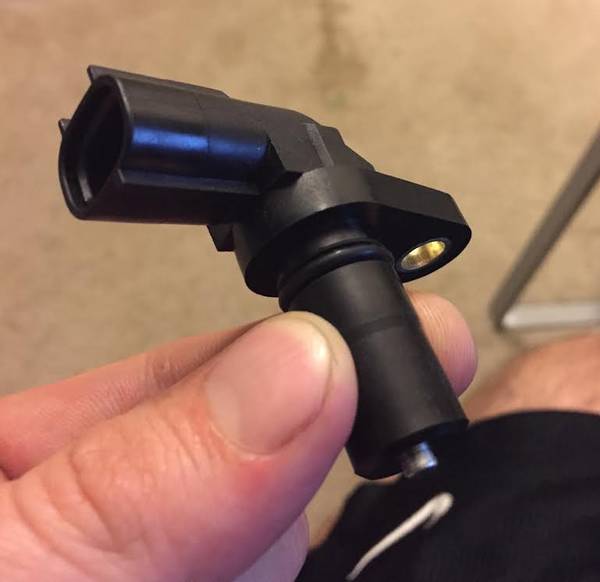

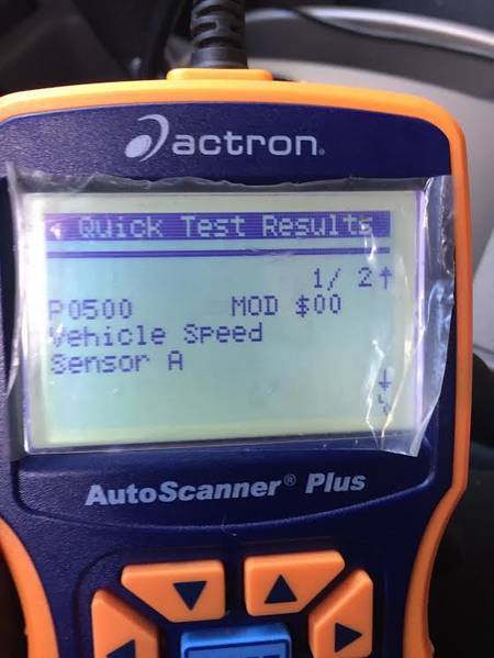

    08TRDOFFROAD, have you found a solution? I have a 07 TRD and am experiencing the exact same symptoms and same fuse is blowing, but i don't tow anything. I do have the tow package and the adapter for trailer but haven't checked that yet. The code reader I used gave a 0500 and also indicated " vehicle speed sensor a ". I will be installing that part tomorrow when the sun comes up. Can anyone tell me where the Vehicle speed sensor is located? i already checked the wheel speed sensors but not sure where the Vehicle* one is. I think its on the rear differential and I noticed Im leaking oil right on the sensor if thats what it is.

    manual 6 speed -- vehicle speed sensor is located on the transmission.

    also clean the sensor head , clean it very well with electronic parts cleaner. remove any dirt, or grim.
    Look for any chaffing on the wires & repair. I would ohm the sensor as well, with the new on so you can compare it. If it ohms same as the new one after being cleaned i would stick some dielectric grease in the connector and give it another go.

    I have a Automatic trans, will the sensor be in the same place? I just picked up a brand new vehicle speed sensor and alternator and will be installing them in the AM. That speed sensor was $120 and is a tiny little thing...

    yes driver side towards the middle of the transmission.

    Thank you! The sensor was very easy to replace. It was on the bell housing on passenger side like you said. I replaced the sensor, and the alternator and blown fuses and problem solved !! all codes are now off, truck runs fine, speedometer is back and battery is charging fine. Im sure it was just that sensor but I replaced the alternator anyways because I have 132k and would rather have the peace of mind for future trips.

    thanks for checking back. Was the old sensor damaged? Did you ohm it out ?

    I just replaced the sensor. Idid notice on the small metal tip, half of it had some metallic dust stuck to it and some minor purple color, but when i wiped it off with a terry cloth it looks new again. For my own sanity I just replaced the sucker for $90. btw.. what does " ohm" mean?

    Checking the resistance of the coil in the sensor with an ohm meter, or multimeter.
