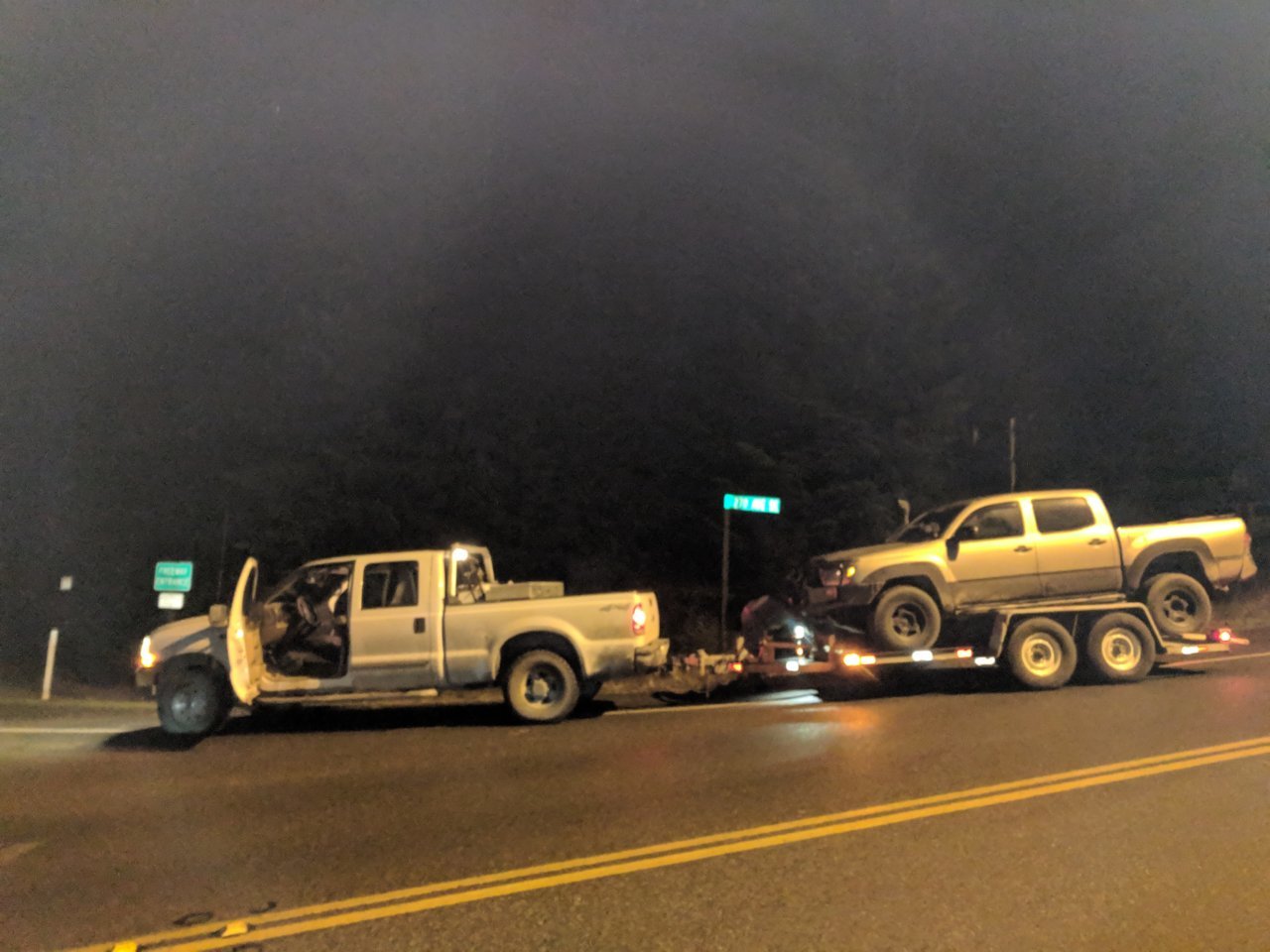

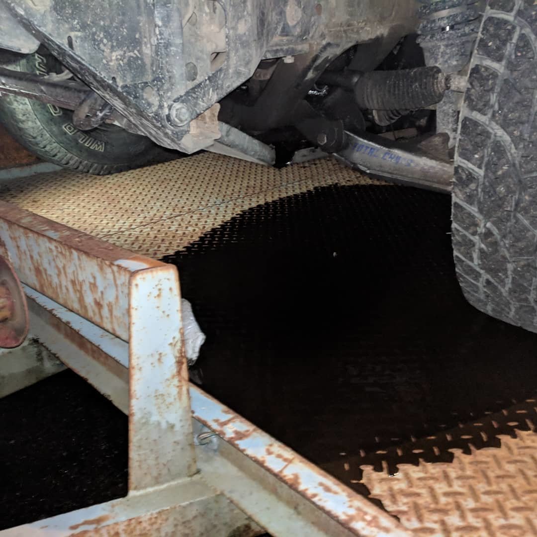

    With the amount of users here I'm sure there is someone out there who has had to replace their 1gr-fe 4.0 due to one reason or another. Tonight my 06 tacoma sh!t the bed while cruising home on the highway. I wasn't bashing or abusing the motor, just simply cruising along at 70mph when next thing I know it lost power and the motor died, with smoke billowing from under the hood. Upon seeing the smoke I could smell that it was burning oil. First observation was seeing a steady flow of oil coming from my skid plate. No obvious signs of block failure or even abnormal sounds like rod knock or crankshaft chatter prior to the engine giving out midstream, I did have the tunes up and my exhaust is on the loud side which probably masked the warning sounds of engine trouble. Giving the time of day, 10pm and pitch black out, I wasn't able to immediately centralize the problem or source of the oil leak but there's oil everywhere. I will do a thorough inspection in the daylight. I had to winch the truck onto the trailer.
    I haven't checked the coolant or oil level, but obviously the oil level will probably not touch the dipstick. Thinking out loud I'm predicting the timing chain broke, which makes things worse since what ive read is that the 1grfe is an interference engine. Just an assumption as when I tried to restart the engine it really struggled to turn over, making me think that the valves where not opening/closing.

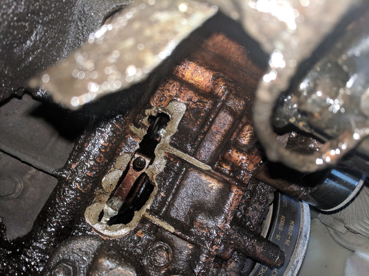

    Also while I was watching the oil flow from my skid plate, it had a strong smell of gas to it. Either the rings are toast, or I had a bad injector. I'll know more around 3:30 when I get off work. Approximately 5800 miles since the last oil change. Was going to change It this week.

    Threw a rod.
