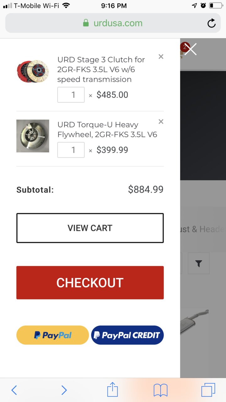

    After some more research, I think I might as well replace the clutch and flywheel while I’m in there. The URD stuff if really affordable and the OEM tob is only $96 through the dealer parts desk.

    Im running the URD stage 2 clutch with heavy fly wheel in my second gen, and am super happy with it. I emailed them, and told them how I use my truck and asked for their recommendation of which stage would be best for me. They responded quickly, and suggested the stage 2, which was good because I was going to order the stage 3. Just food for thought.

    definitely, especially in your case with a built truck that sees stress. i am waiting for any kind of symptom... as soon as it shows I'm upgrading as much clutch hardware as i can access. but unfortunately i think you're right that only the clutch itself is available from URD unless something changed recently.
