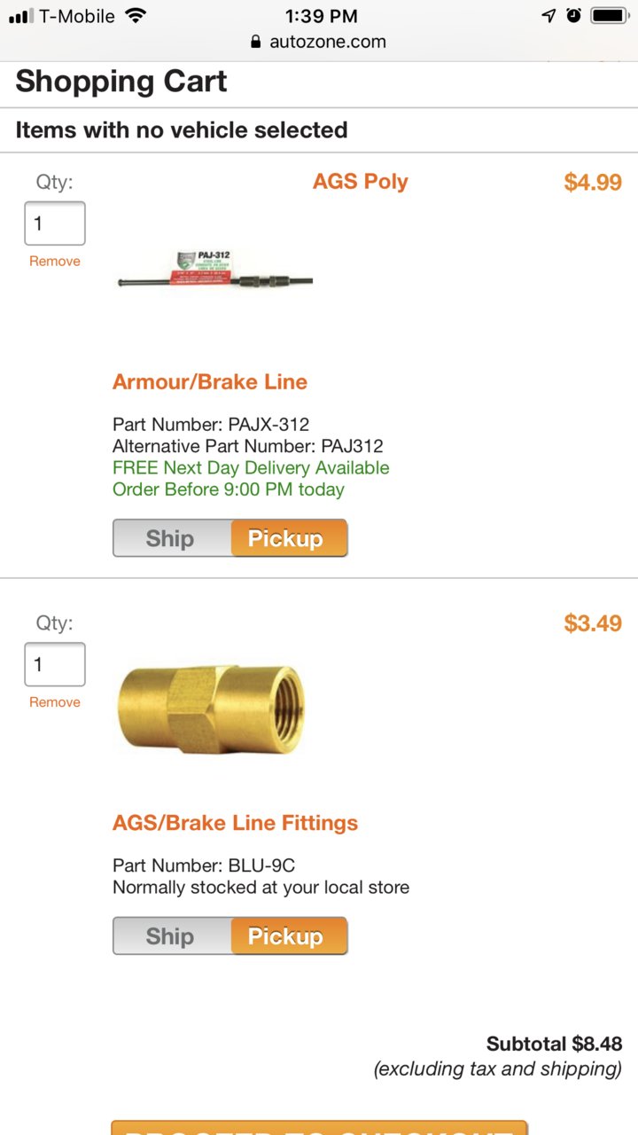

    Accumulator delete done and holy balls is it amazing.

    @RedBeard1
    Which route did you go? 12in prefab line?

    Modded it so much it turned into a 4Runner
    Yes I did. Super easy to do.
