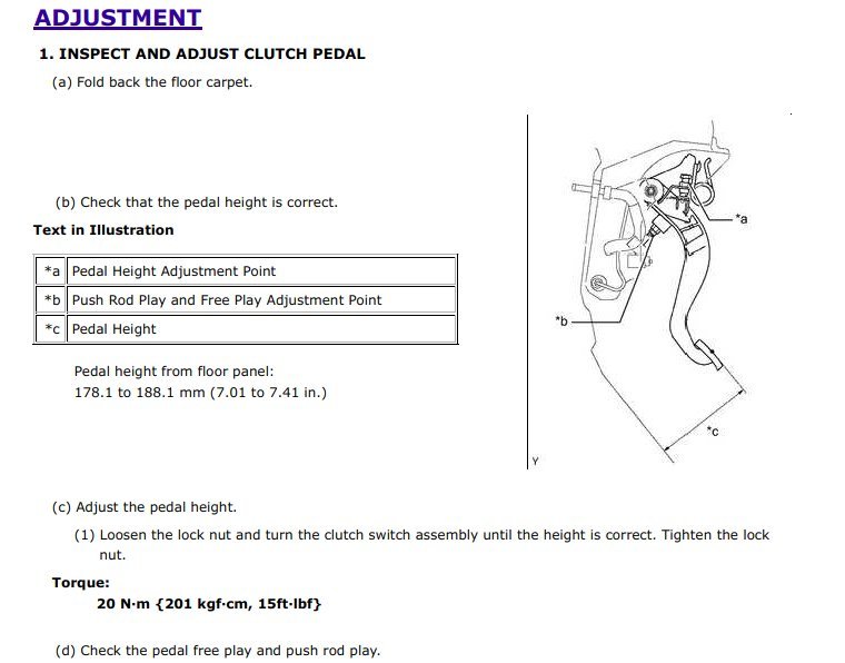

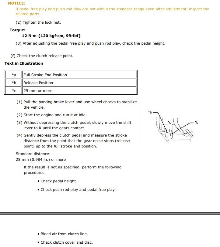

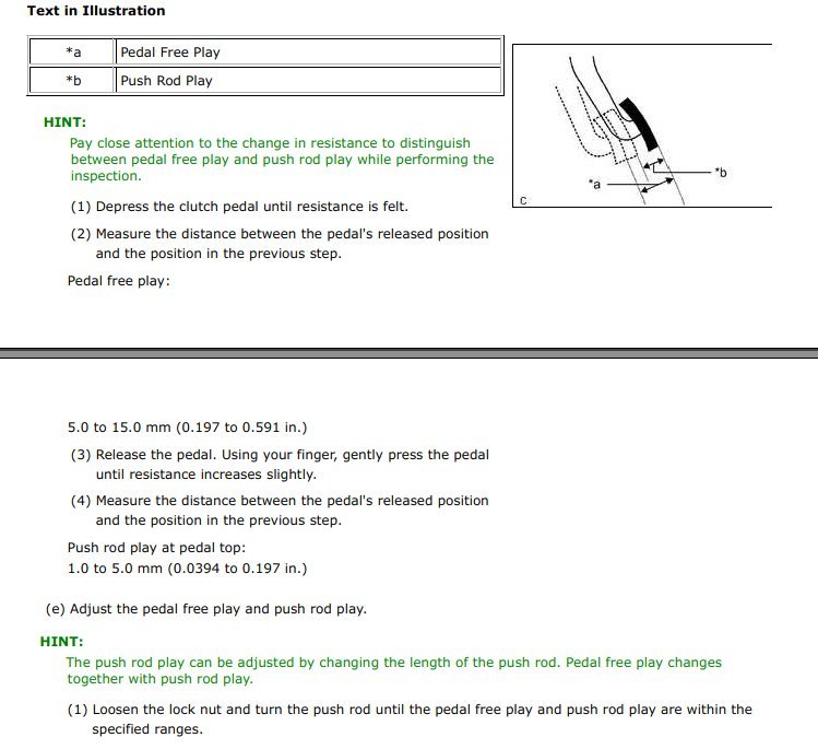

    I’ll post the official procedure below. I don’t think it’s going to help you, the MC is fully extended at rest and free play just ensures that the clutch pedal stopper that sets the pedal height (aka limits the pedal from going too high - this is accomplished by threading the cruise control switch up or down) isn’t pushing the clutch pedal into the MC to engage it.
    Over time, as the clutch wears, the pressure plate fingers expand outward which pushes on the throw out bearing which pushes on the slave. This pushes fluid out of the slave, and that fluid has to go somewhere. In a Tacoma though, that fluid should be going up to the reservoir, essentially making the reservoir gain fluid over time. It shouldn’t affect free play.
    Free play makes sure that your pedal is not acting upon the clutch at rest. If it is, then yeah you have problems. But if it was set right from the factory (and assumed to not have been touched again), it *should* be fine. YMMV of course.
    Long story short, essentially you are making sure the pedal moves without doing anything to the master cylinder, just a tiny bit before it starts to push the master cylinder. If you had no free play, you could be putting load on the throw out bearing all the time and also starting to disengage the clutch as well.

    BLtheP beat me to it for showing the free play adjustment. The adjustment I would focus on is the master cylinder rod free play which takes a 14mm and 12mm wrench to adjust. As stated, the pressure plate fingers move towards the bearing as the disk wears. I believe BLtheP and I disagreed on what happens next so i'm not gonna go there but give it a try and see if it helps.
