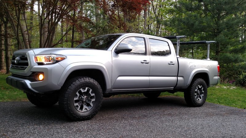

    2020 SR5 Tacoma DCLB 4x4 Red
    It's on. It appears to be pretty solid.

    That rack looks awesome. I got my mounts today and should pick up the Xsporter from my buddy in the next day or two. Hove you noticed any wind noise or decrease in mileage since you installed your rack? I have the short bed and based on your pictures I won't be able to adjust the height any lower than what you have in the picture.

    I installed the rack this evening, so no driving impressions yet. The rack is in the lowest position, but I don't think it's going to be loud.

    You can modify the rack by cutting some height off of the legs and that will allow you to lower the rack below the cab. I am fine with how low it goes, I bought it because I can raise it to different levels so I can carry canoes and sea kayaks. My canoe and sea kayaks are 17 feet long so I need them to clear the cab area . The rack fits great, the install was pretty straight forward. I did modify my bed rails so I can easily remove / install the rack .

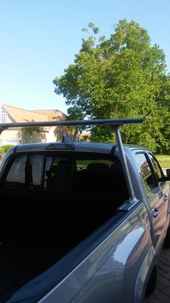

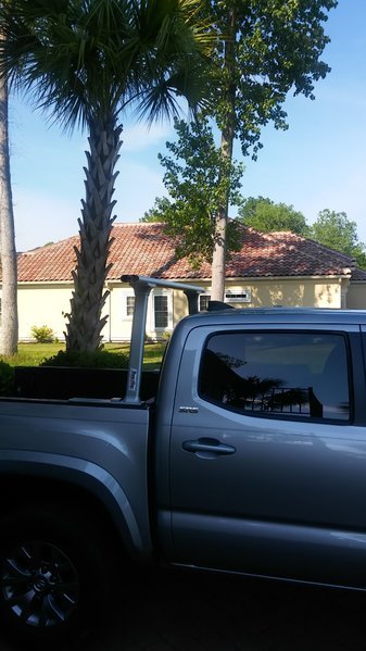

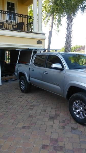

    Well, i can verify the Thule mounts work with the TracRac. I picked up the $299 model from Home Depot and it fits well. After putting it on, i feel it sticks up over the cab higher than i would like at about 7 to 8 inchea. Other than that i have no real complaints. The extra height makes it difficult to get my paddleboards up there. After putting it on i think i prefer the more stock look and think i may go with an OEM roof rack. But i did take a few pictures for you guys.
