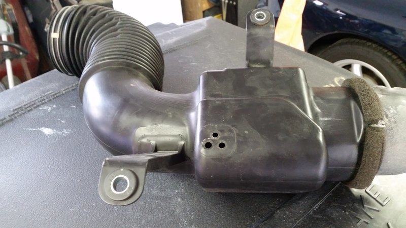

    I took the tube off and the foam is pretty crushed, so I will definitely add some some foam tape over it as Armkb suggested. But I also noticed that there are three holes drilled into the bottom of the tube (see picture). They kind of look like they were done by the previous owner. I couldn't find any pictures that would tell me if the holes are supposed to be there or not. Does anybody know if the holes are supposed to be there? If not, why would somebody drill the holes? Should I try to close the holes, possibly with a little bit of foam tape? Thanks!

    Don't know about the holes. Did you drive it with the tube removed? Is the noise gone?

    LJ, I did drive it with the tube removed. The noise is not completely gone, but it is less noticeable. I finally found a picture of the bottom of the tube. It was not the same angle as the picture that I took, but it did look like it had the three holes. So I'm going to leave the holes, add some foam tape over the existing foam and put it back together. I'm beginning to wonder if the sound I'm hearing is actually from the exhaust and/or cat. I didn't see any holes in the exhaust and it looks stock, but it does sound almost like an after market exhaust, more of a rumble/burbling sound. Maybe its always there and I can only hear it more clearly at low revs going uphill. I sure hope its not the engine! Thanks!

    Leave the holes. They are factory and meant for water drainage.

    Armkb, I did leave the holes. I put the foam tape over the existing foam and put the tube back in place. I may just being optimistic, but I think the "thumping" noise may be diminished. Thanks for your help!
