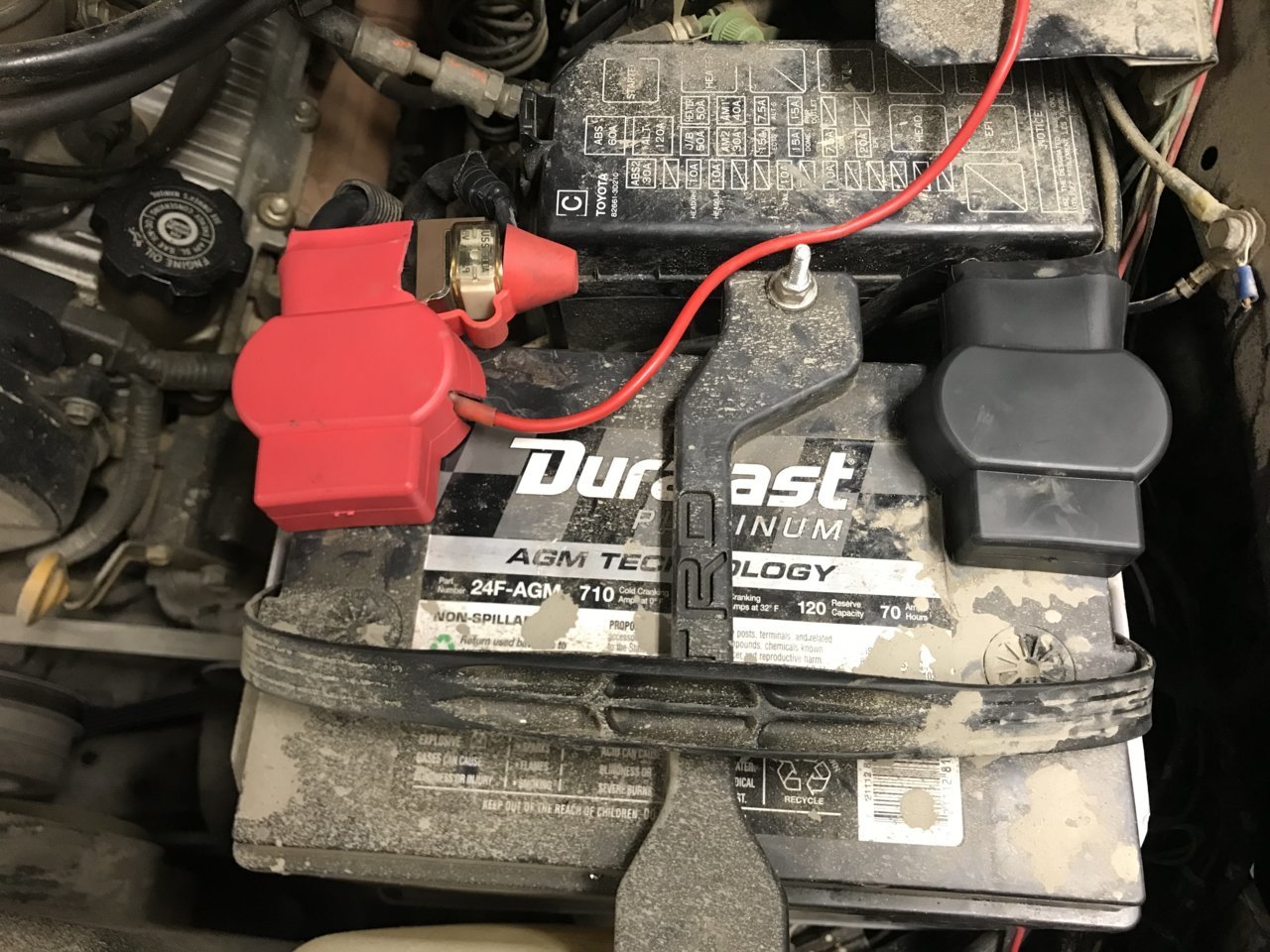

    Not entirely sure how I feel about this mod, considering exactly zero of the ring terminals fit and I had to drill them out.
    Also the boot didn't work at all so I had to hack it up too. Lots of hacking going on here.

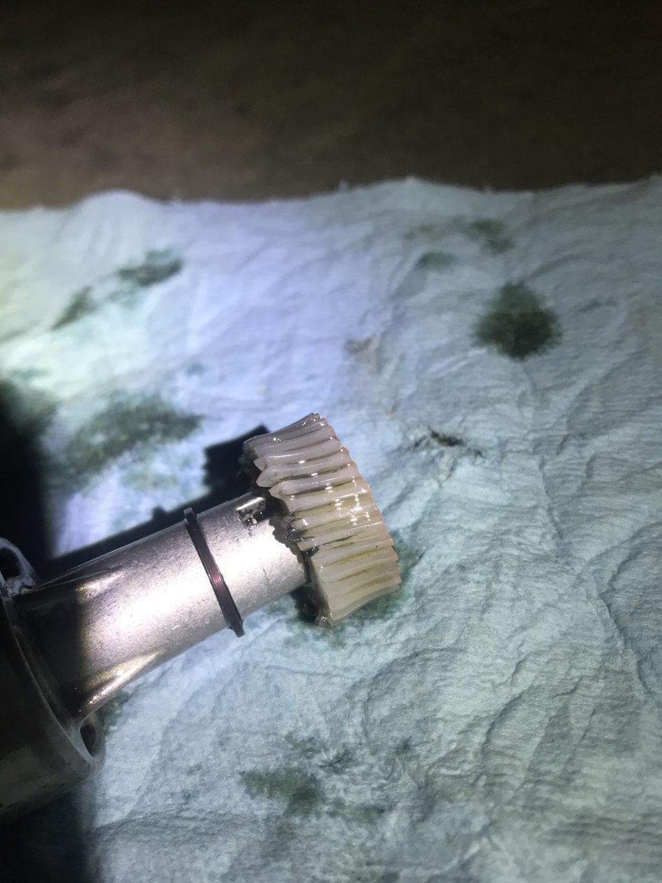

    @turbodb any idea why this got all fucky? I just took this out to swap to 32 tooth, needless to say it wasn't happy and also appear to have taken some pieces of something else with it. Feels like plastic pieces. Speedo still worked during that time.
    Perhaps swapping the speedo gear without also swapping whatever it runs up against is not a smart idea?

    Hmm, never seen that before - how long has it been in there?
    Looks to me like the plastic has been "worn down" over time on the far end (the end furthest inside the t-case). Maybe that's just from gunk in your t-case getting sucked up between the intermeshing gears over the years and wearing down the plastic? :notsure:
    In any case, what I would likely do - since you said it was still working correctly - is put in the new gear and change the oil in the t-case. Then, in a year, take the 32-tooth one out again and see if it too shows weird wear. If it does, then something weird is going on and you get to decide whether to address or ignore it. If not, then you chalk it up to...:tinfoilhat:.

    that's the 33 tooth gear you're looking at, has less than a tank of gas through it.. it was not very easy to put in and required more tapping it in than I cared to admit. The 30 tooth gear that I removed with 190k miles on it still looked perfect. That being said, the 32 tooth gear that I just put in went in MUCH easier, so I am hoping all is well with it. We will see!

    Oooof, one tank. :eek:
    Sounds to me like it was either mis-aligned or not the right gear (part #). My 33-tooth went in like it sounds like your 32-tooth did - easy. Hope the 32 works out for ya! Keep us posted.

    @turbodb Also it looks like the 32 tooth speedo gear is almost perfect, it reads maybe .7mph faster on my speedo around 70 mph, what's really funny is my odometer is still about 3% slow compared to my GPS speed/mileage app.

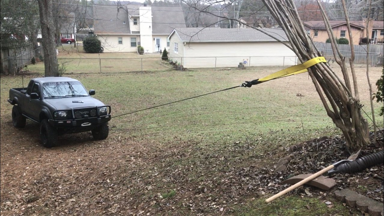

    Well my winch works.
    And yeah I figured out that tying the tree saver that way wasn't the most efficient way to rip a tree out of the ground haha
