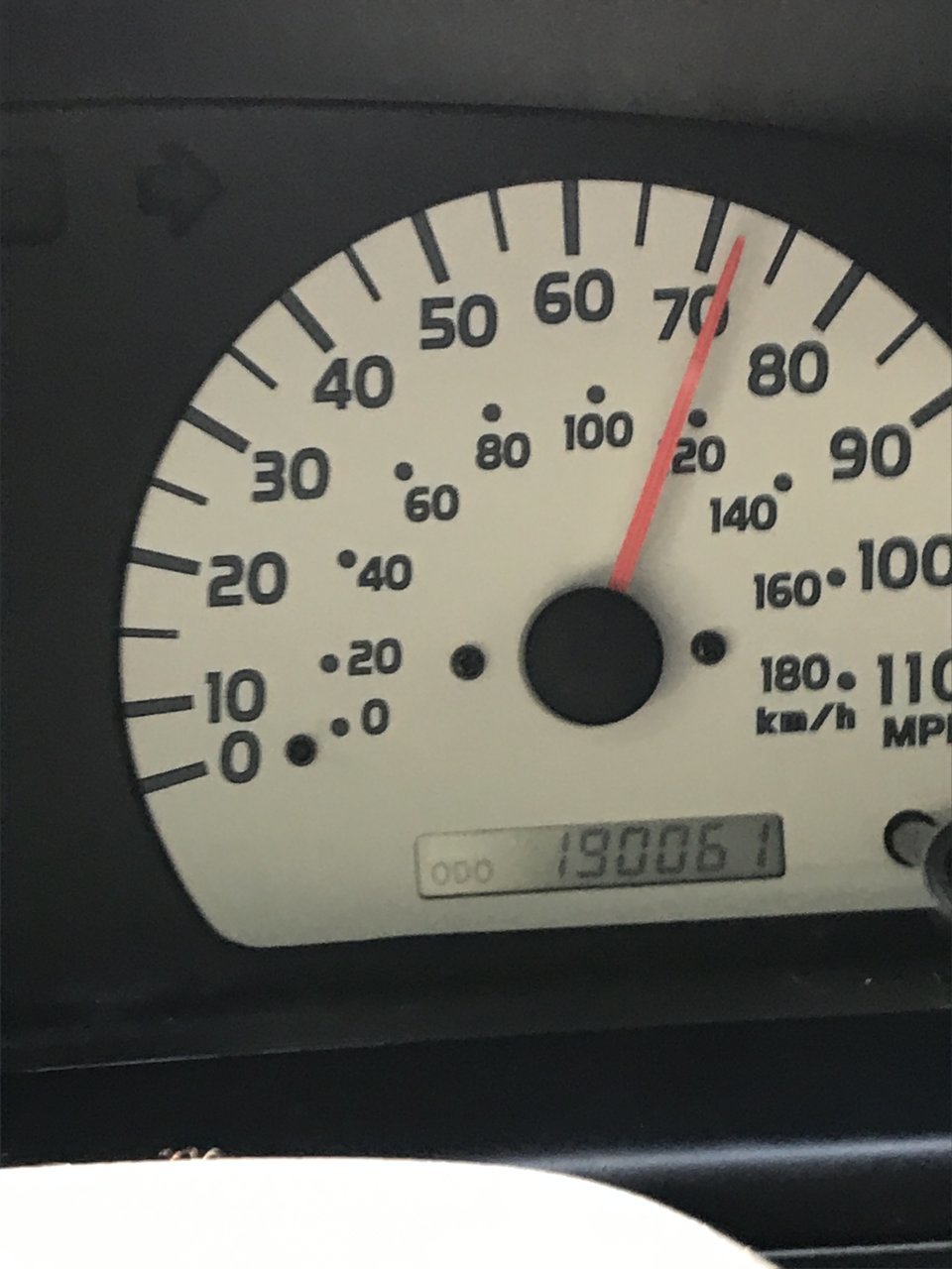

    Rolled over 190k and missed it. Still runs like a champ. Getting closer to the 200k club

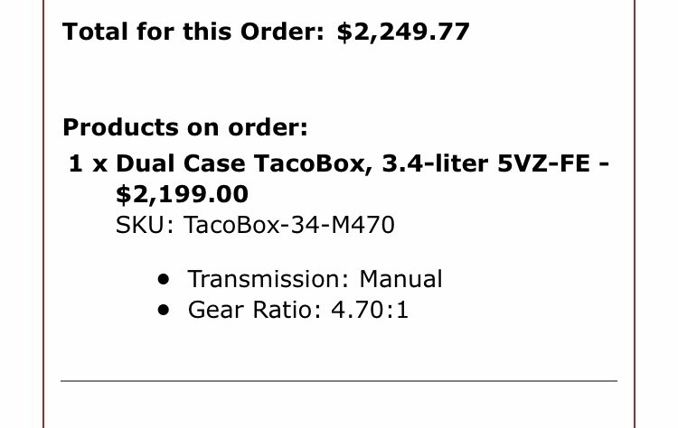

    Cancelled this order.
    I ordered this in late March and was told 6 week lead time.
    After 8 weeks, I called them and they told me they are waiting on shifter bases to come back from machine shop. "They will be here this week so you should have at your door in two weeks".
    After 11 weeks, call them and ask what gives. "Oh we are waiting on adapter plates, it's going to be at least 8 more weeks".
    Meanwhile, another forum member calls the next day and they tell him that the guy who builds the boxes is on medical leave for a month.
    So this week (12 weeks aka twice the quoted lead time), called them and asked to cancel my order. They did not ask any questions as to why or attempt to retain my business. Though they probably know why.
    Not going to continue playing this game.

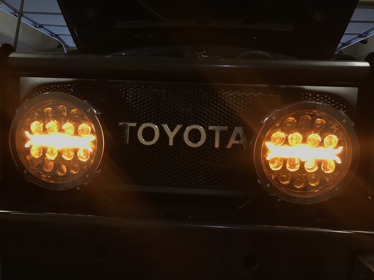

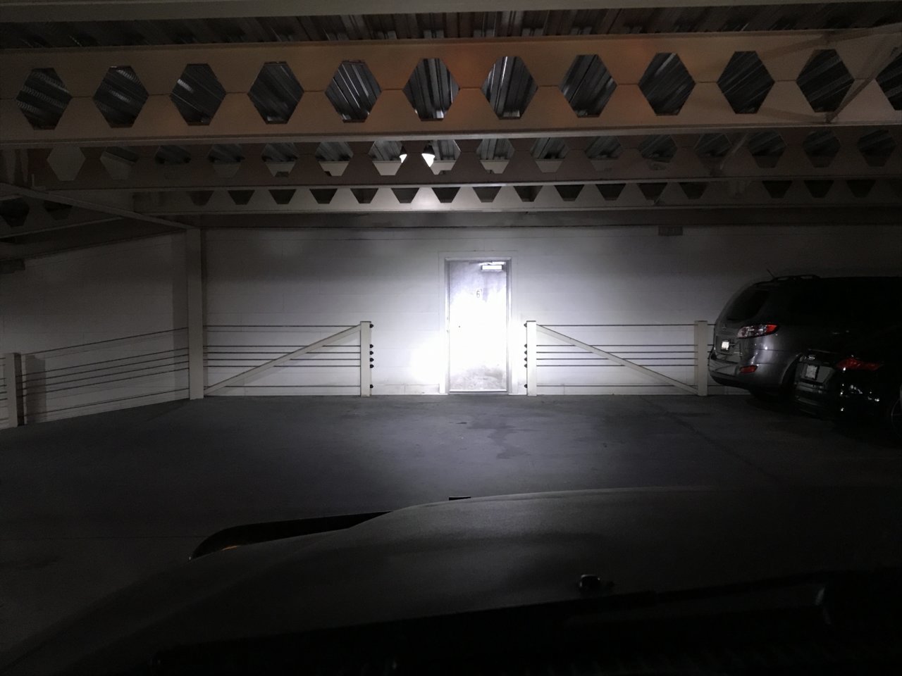

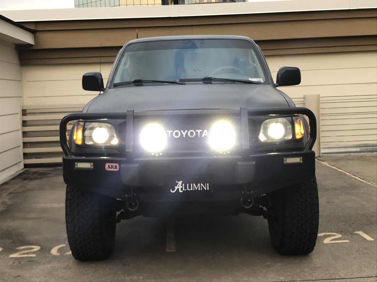

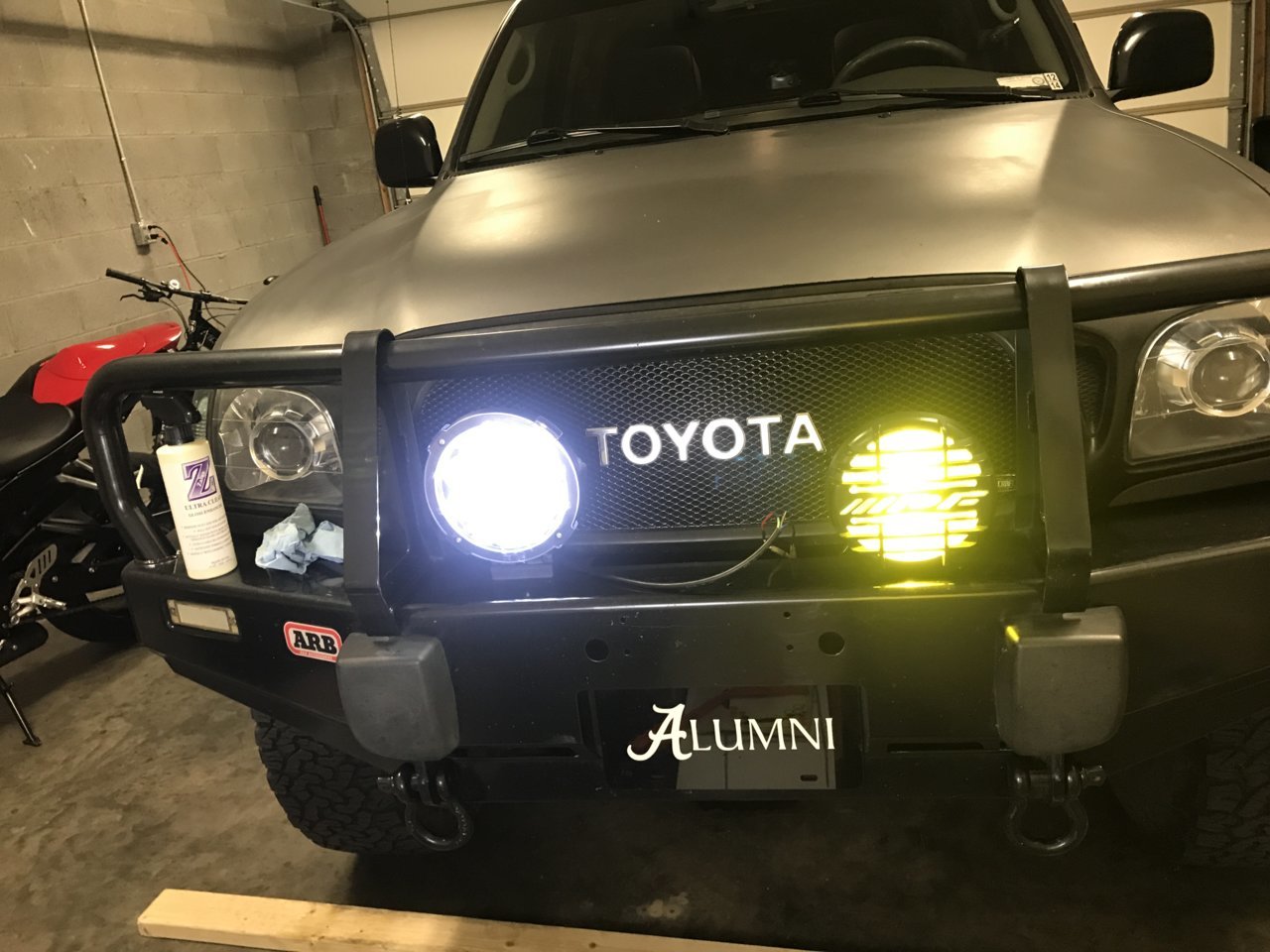

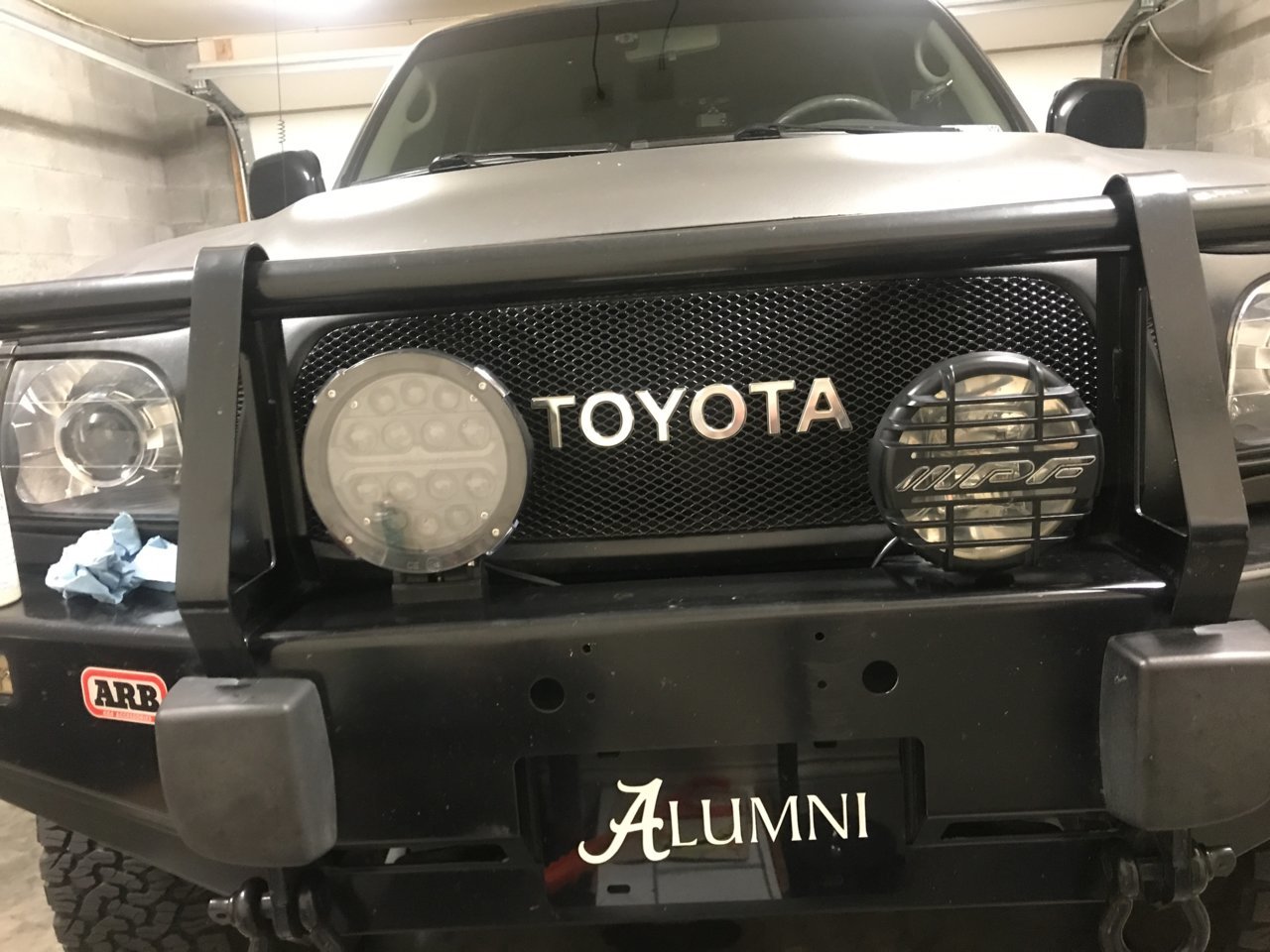

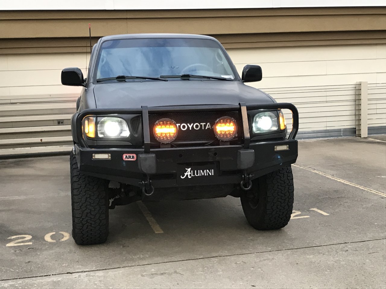

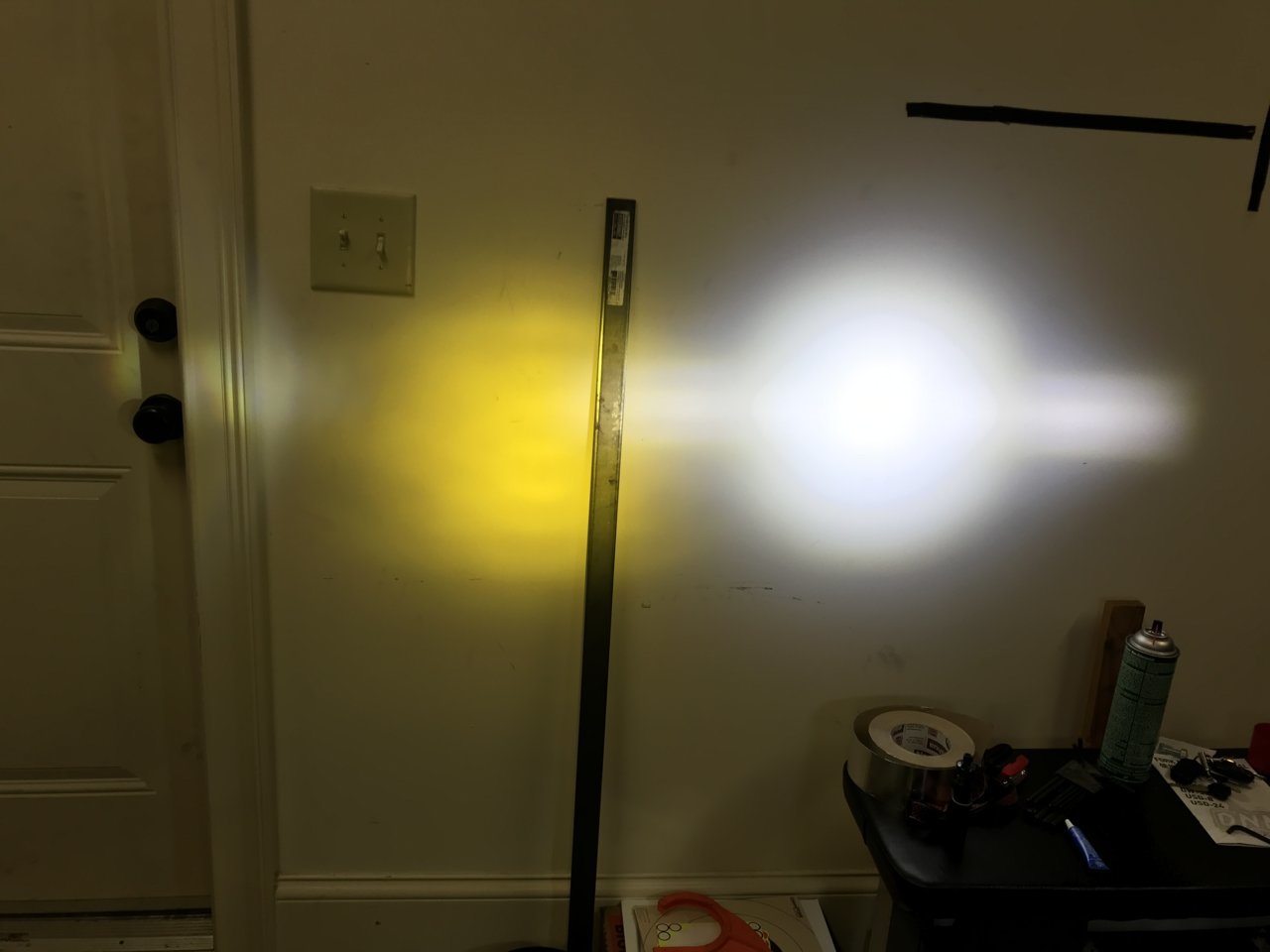

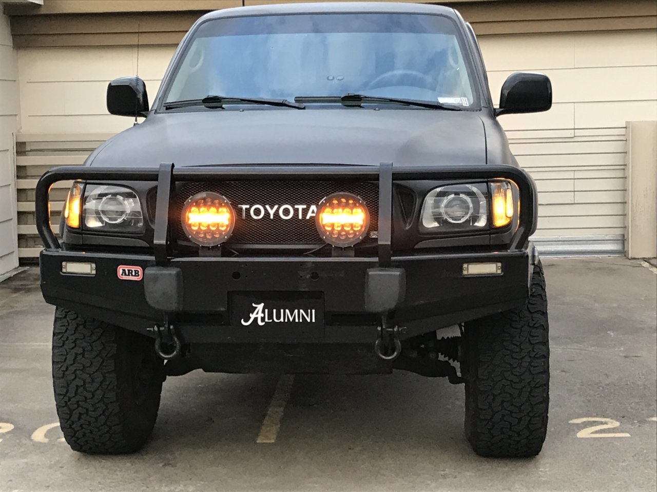

    AliExpress budget LED lights. Because why not. $60 each and arrived quickly from Taiwan (about a week). Have a feeling I will need to silicone seal an area somewhere.. gonna take my chances first. They have an interesting "combo" beam pattern. A horizontal beam for flood and circular beam for spot. Makes the light look like Saturn when next to a wall.

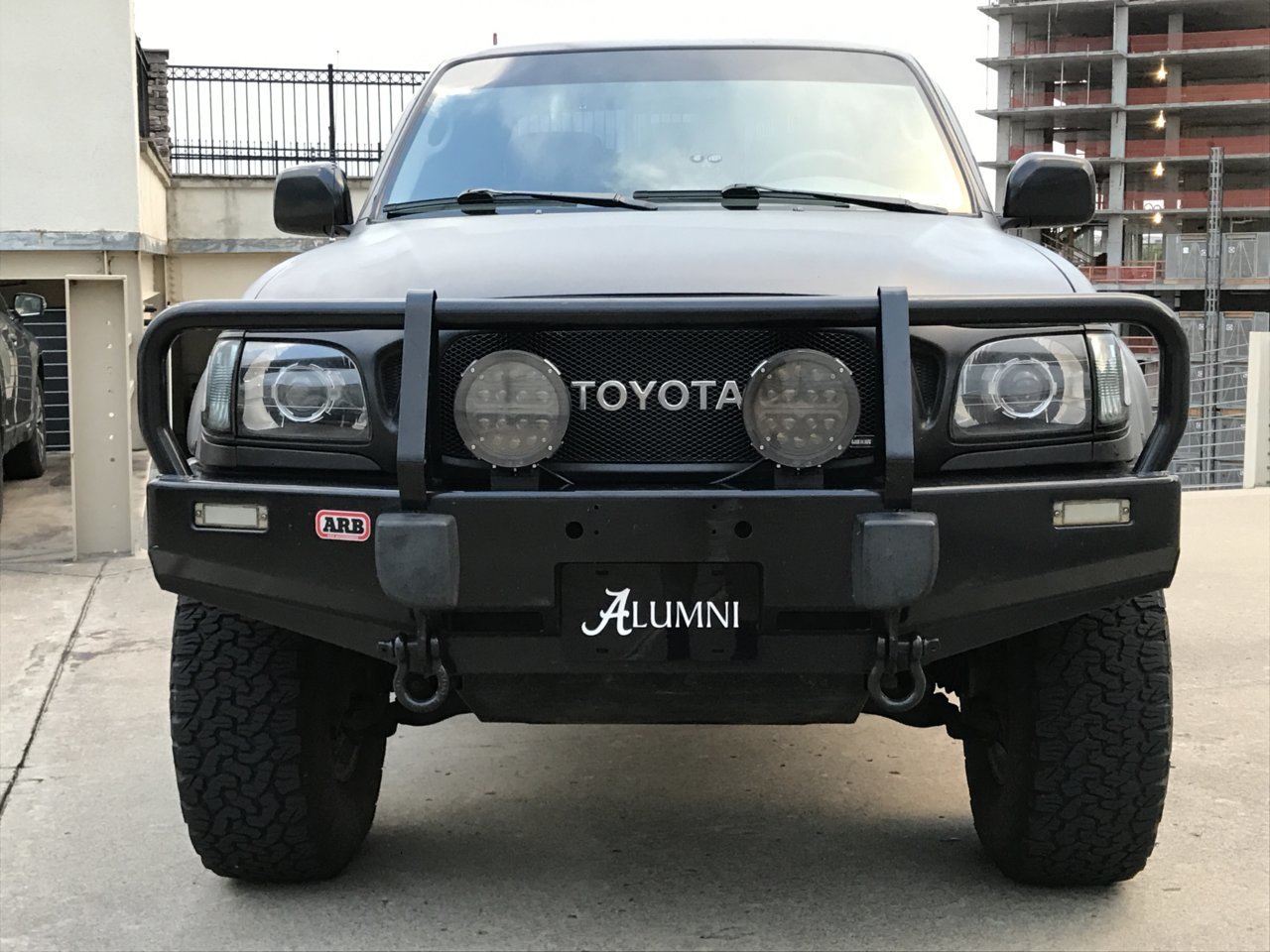

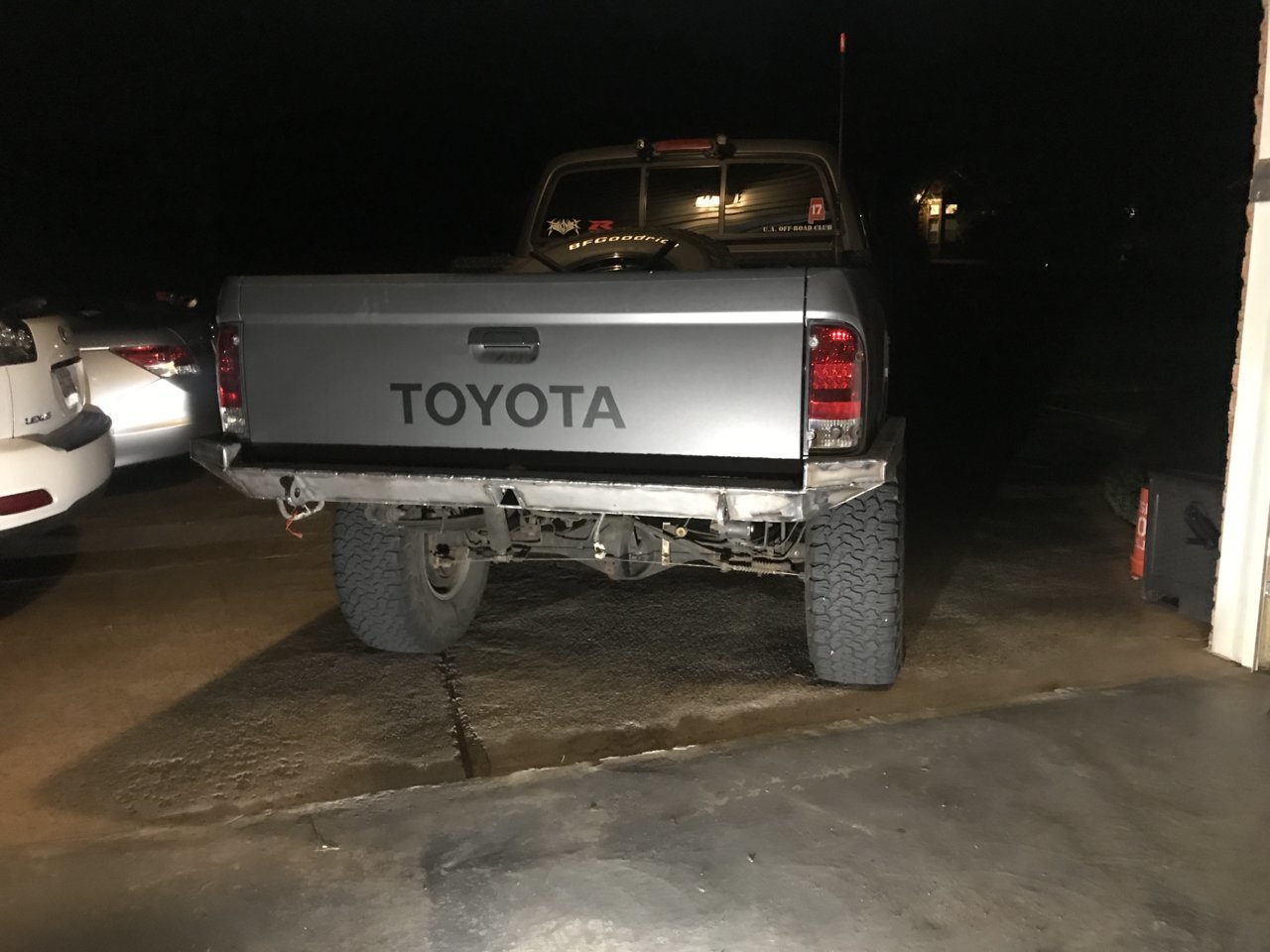

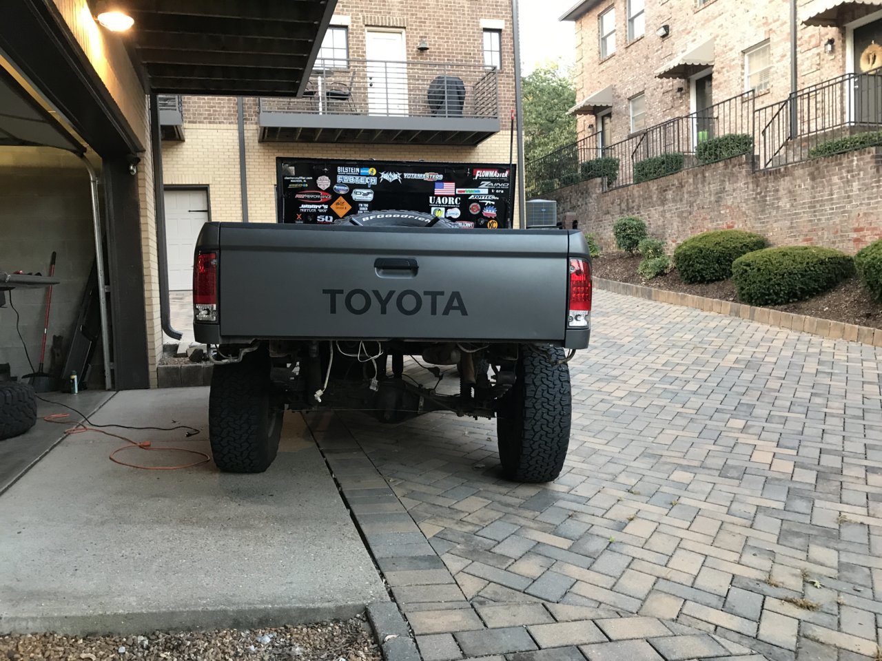

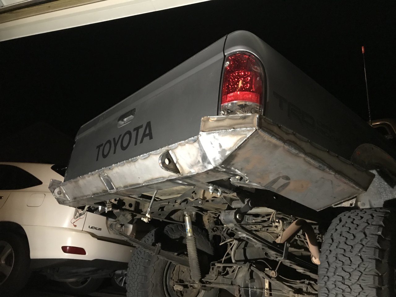

    The start of some serious mods over the next few months.

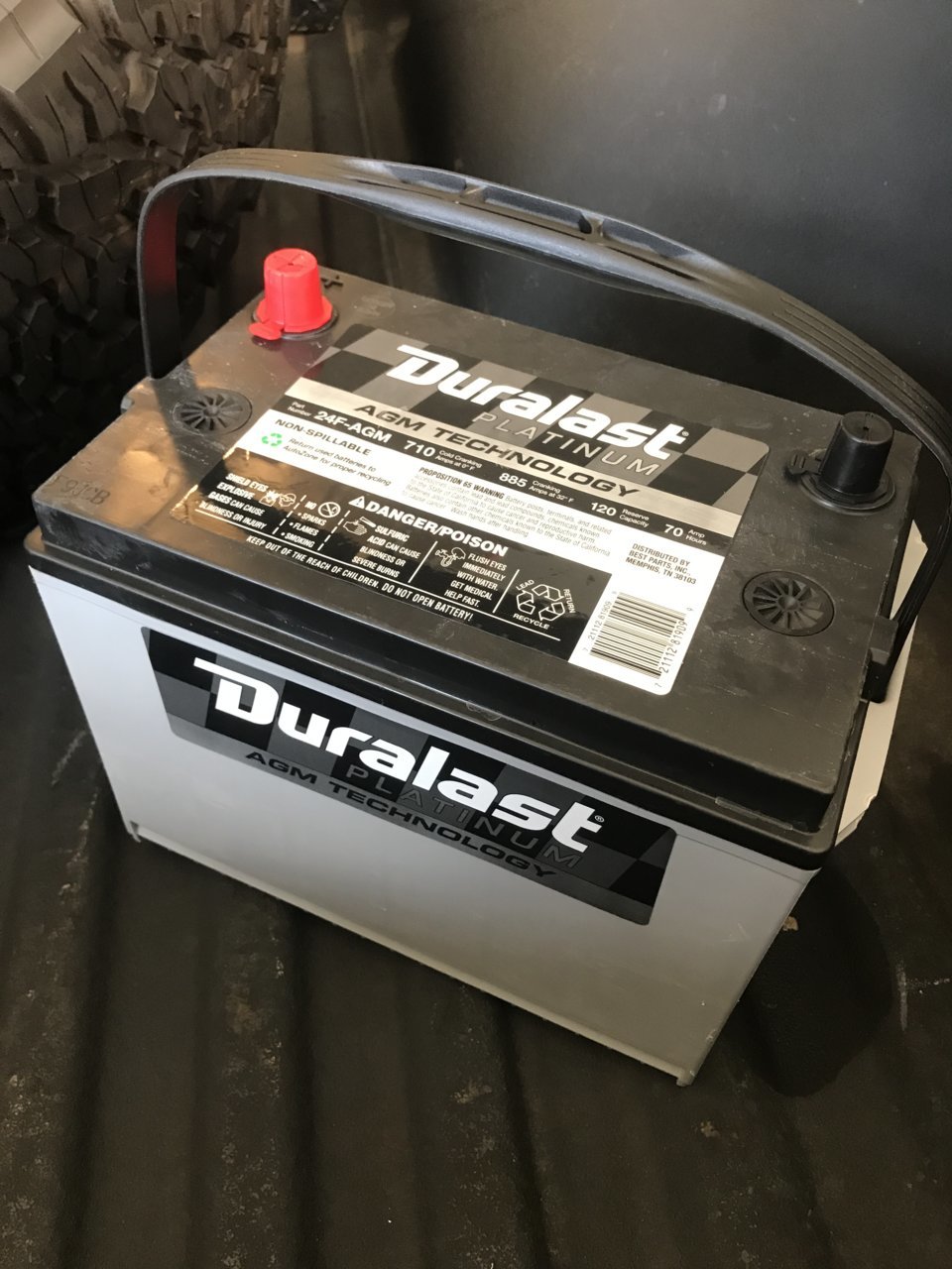

    Also forgot to mention, my Walmart battery finally killed a cell after almost 5 years (date code was marked 9/14). Badly sulfated.
    Picked up an AutoZone AGM battery. Looks like Johnson Controls makes it. We will see how it does. Popped it on the charger and eventually heard fizzling so I took it off. Holding around 13.0-13.1 volts at rest. When I got it at the store, it was at around 12.64 volts (date code 6/19). Always charge up a new battery especially if the date code is more than a month out.

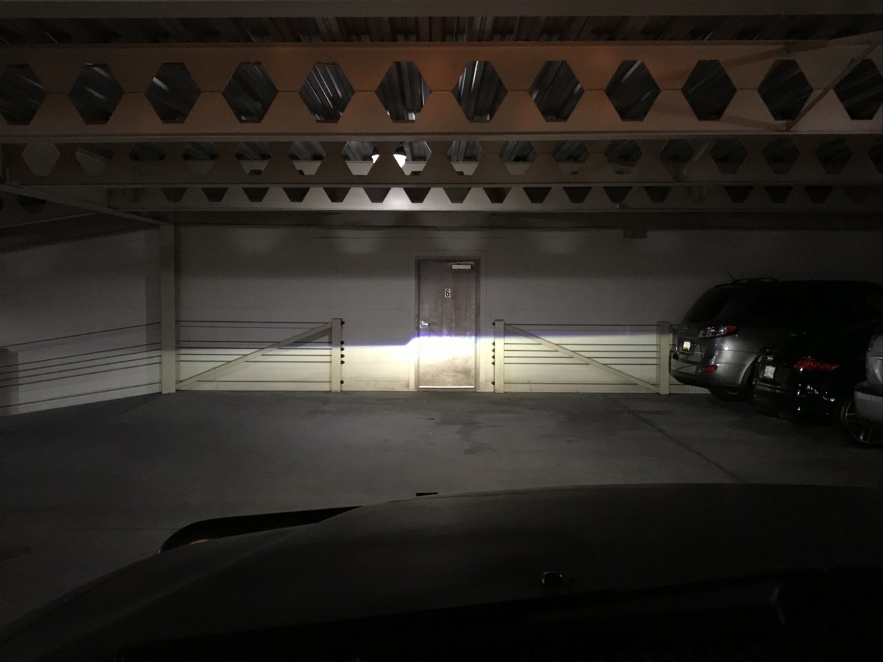

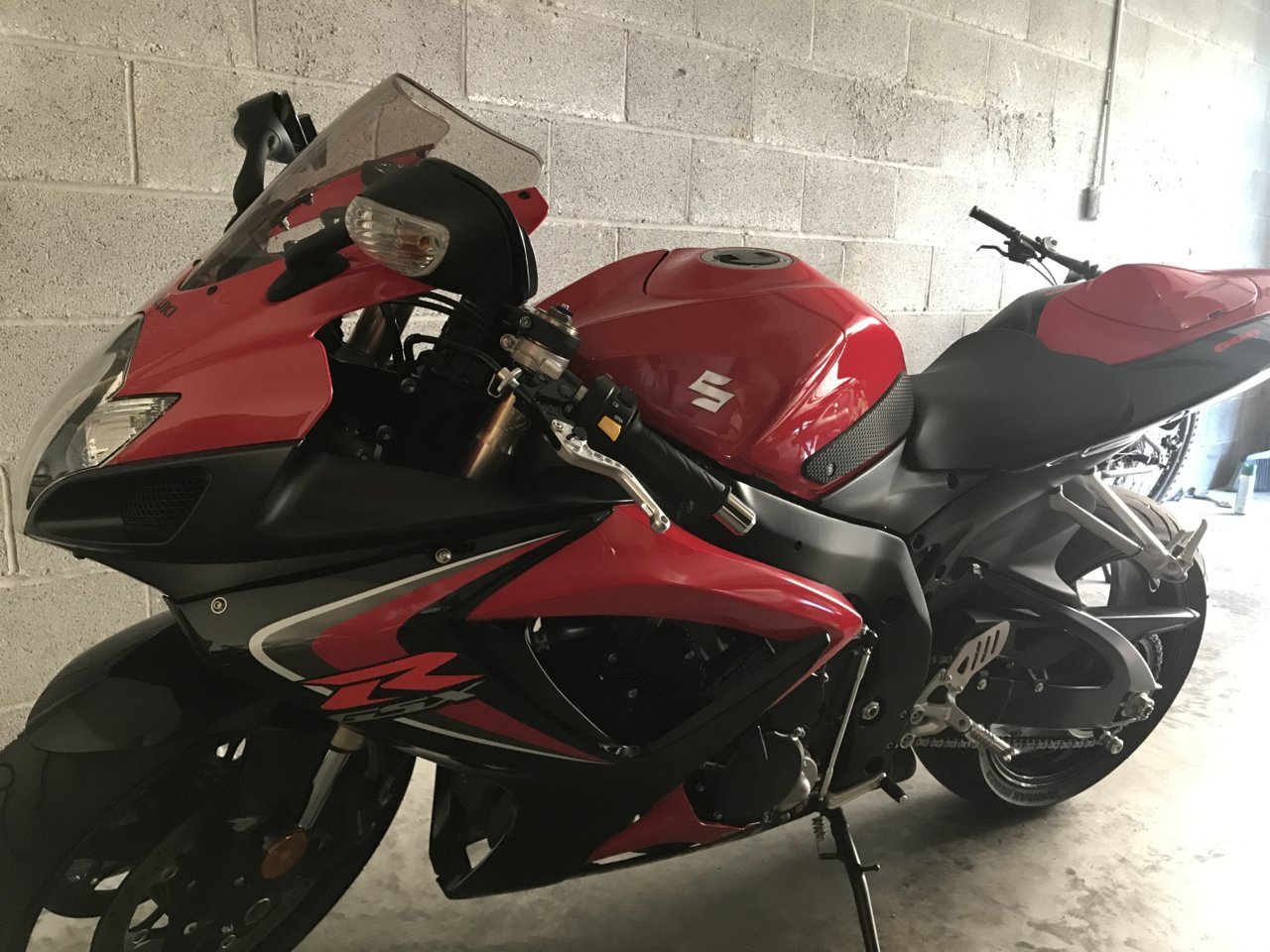

    Not truck related, but I'm going to be putting some HID retrofits into this guy. The headlight on this isn't great and the bulb tends to go out on occasion, usually fixed by smacking the headlight. That will change soon.

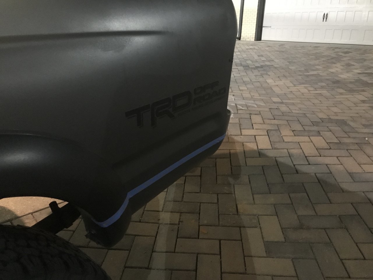

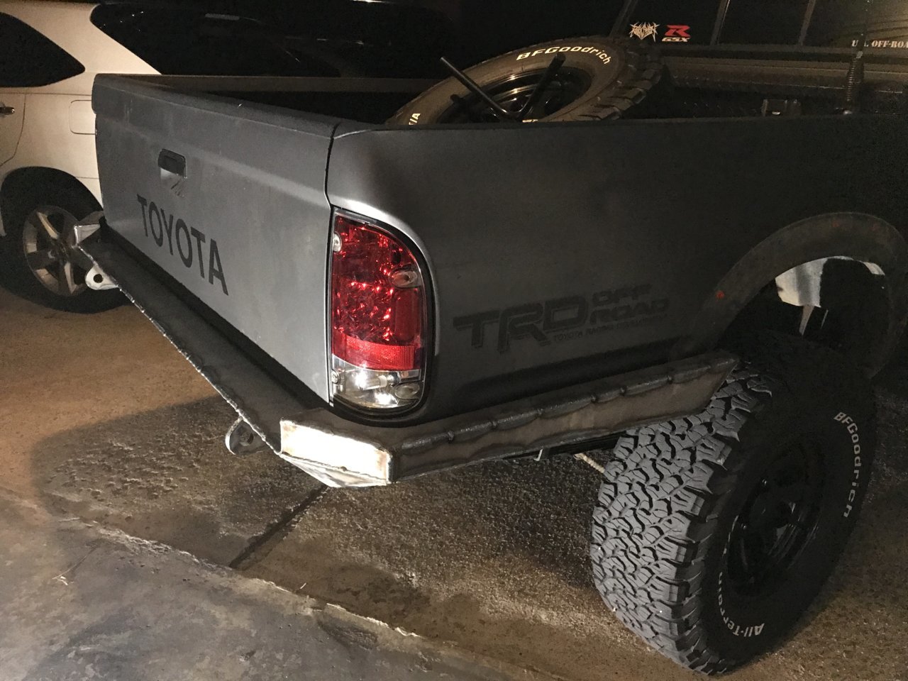

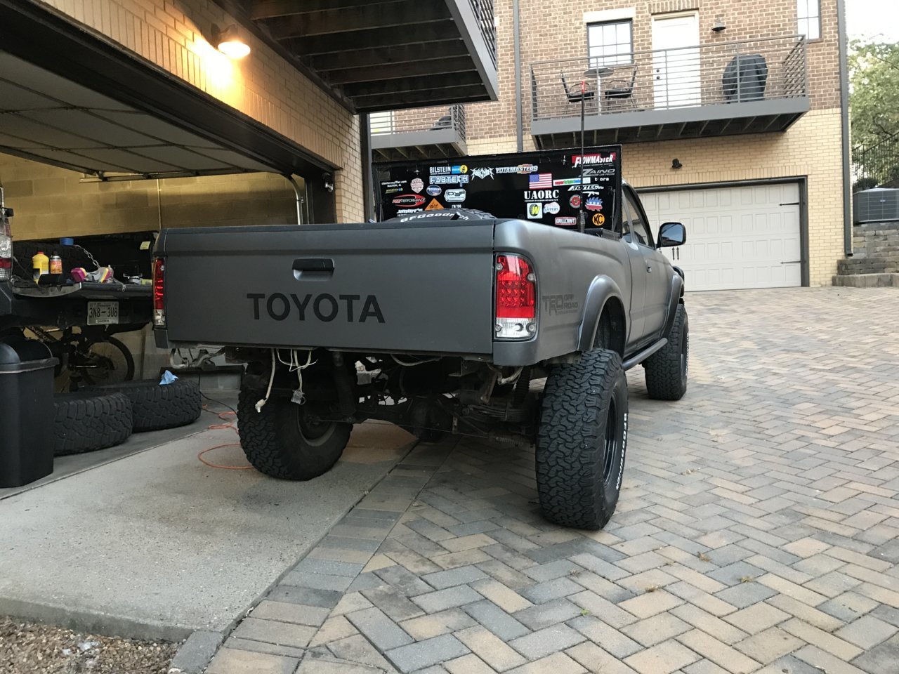

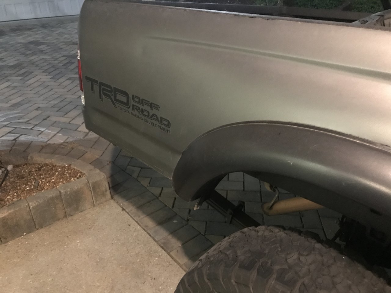

    Next step, bumper fitment. Then a little flap disc action, paint, followed by edge guard. Then it'll be out of sight.
