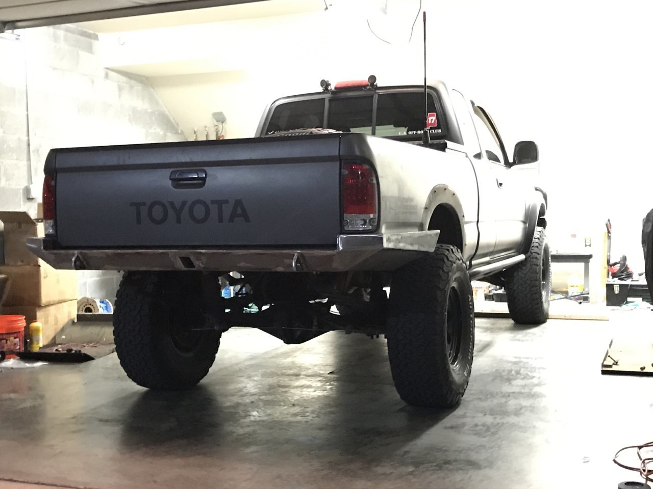

    It's a little of both. I had to cut about 1.5" off the bedside but the bumper covers up the cuts.

    same here, @Dave41079 shared a random link in our group chat a while ago and I saw they had some nice looking 1st gen bumpers. And for the price they can't be beat. A little more labor involved but I think it's worth it, especially since some of the lead times on the bigger bumper makers are getting pretty ridiculous.

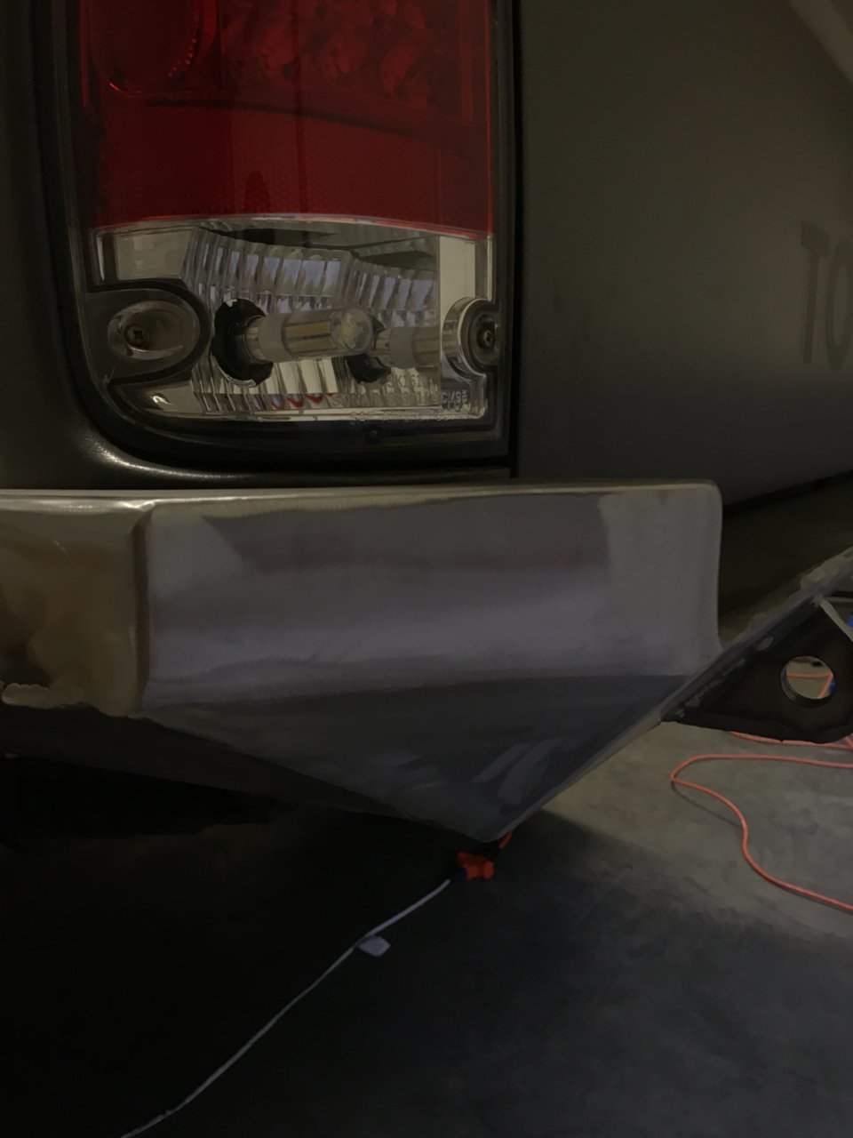

    Almost finished grinding. Couple of spots need filling and then it'll get paint. I also need to cut a little bit more off the fender next to the wheel wells (sticks out a bit there)

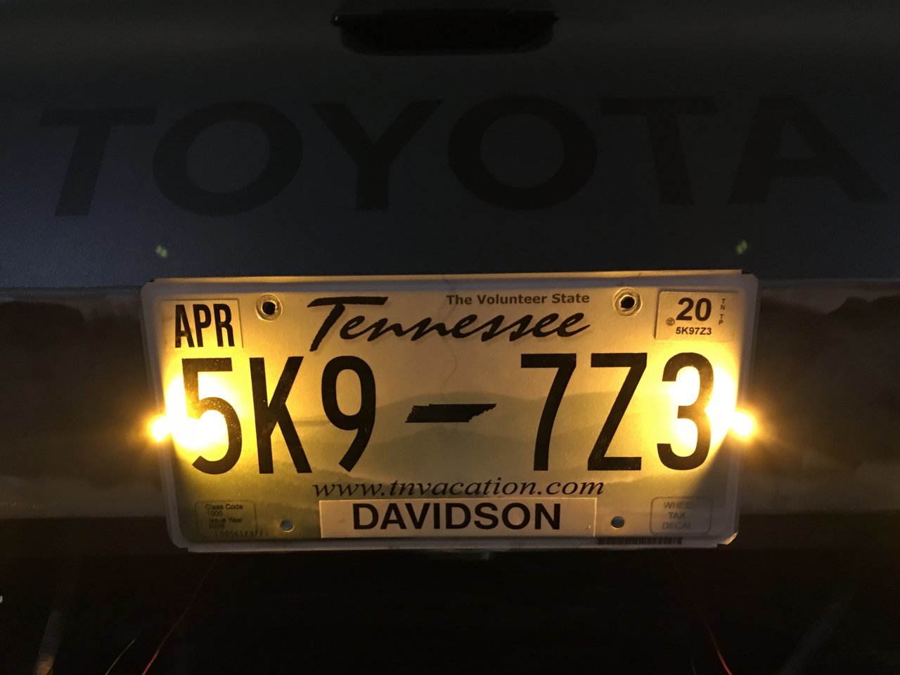

    Well the little license plate light doodads are not going to work where they drilled holes to mount the license plate. The acute angle of the bumper there is making it impossible to thread pretty much anything on the bumper from the backside. So I'll either have to drill holes somewhere down further on the plate, drill new holes in the bumper, or just say fuck it and not run lights, and use some kind of fender clip to hold the plate in.

    Tape glowsticks around the license plate

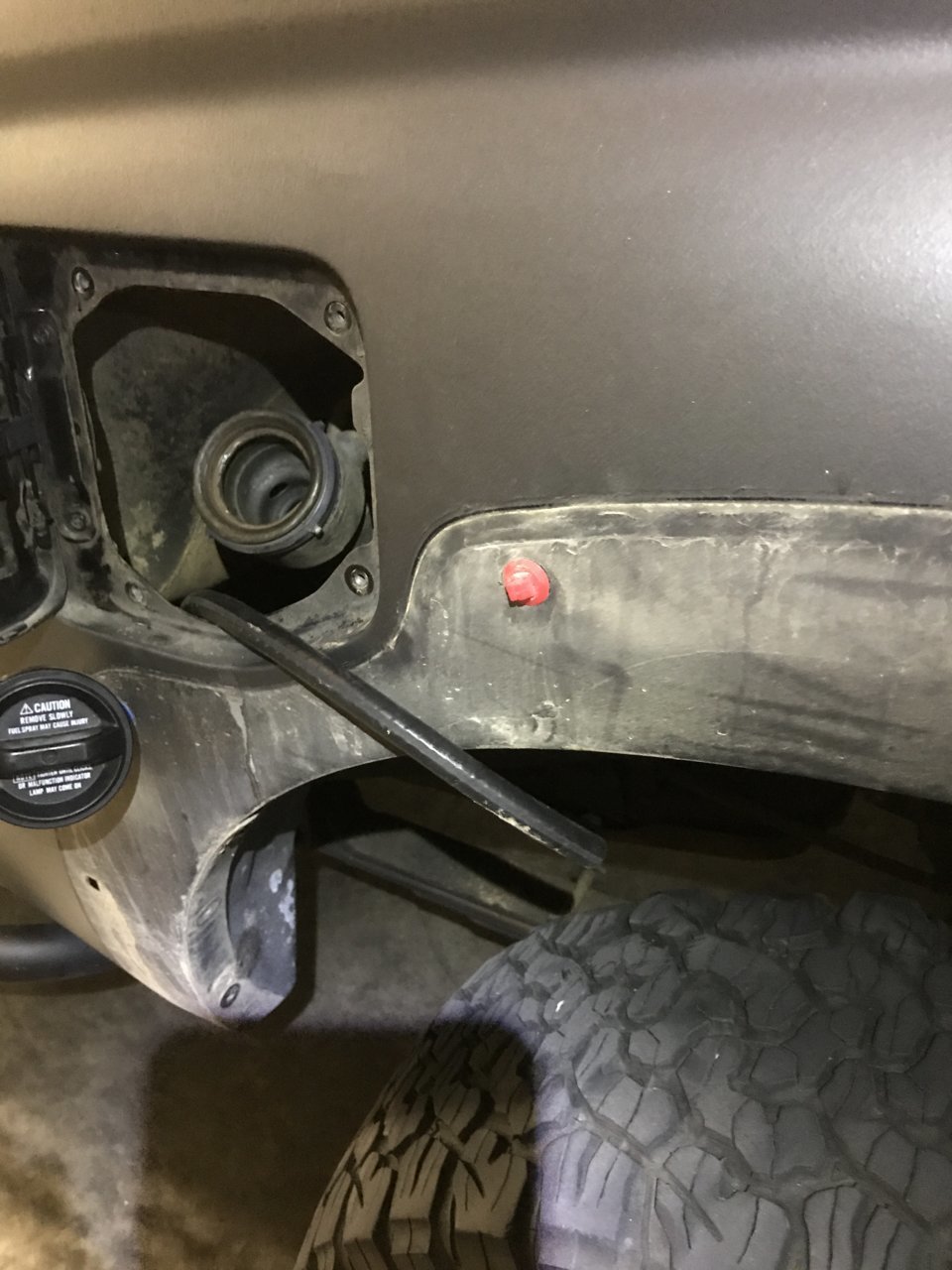

    Rear diff breather extension installed finally. Figured I might as well not trash these brand new ECGS gears.
    I mounted behind the gas cap plastic surround. Totally invisible. (sorry no pic with breather installed but it's just a generic Dorman part)

    French it into the tailgate with a 30° cant :thumbsup:
    Bumper looks sweet BTW :cheers:

    Probs gonna drill a couple more holes in the plate and bumper

    Also went ahead and defaced my license plate in an attempt to be "legal" (the irony).

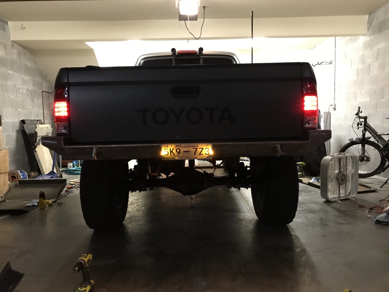

    Finally done. Next mod is crawlbox but that won't be for a while
