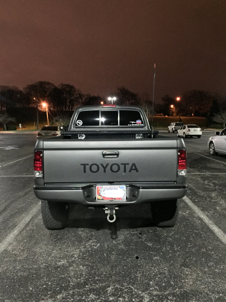

    Got better pics of the LED tails? Love that style if it's the style I think it is.

    Here ya go.

    :thumbsup: Thank you! I need those in my life.

    They're pricey but worth it. Really cleans up the rear.

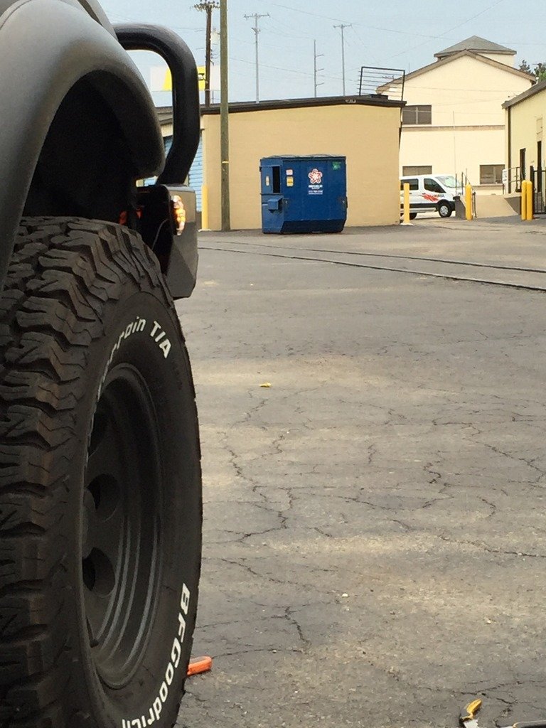

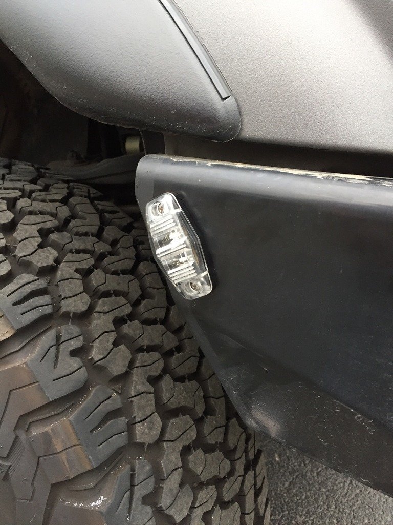

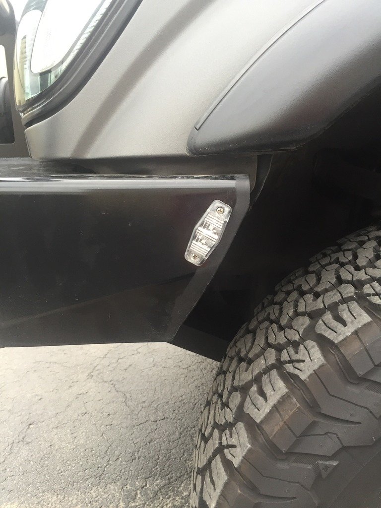

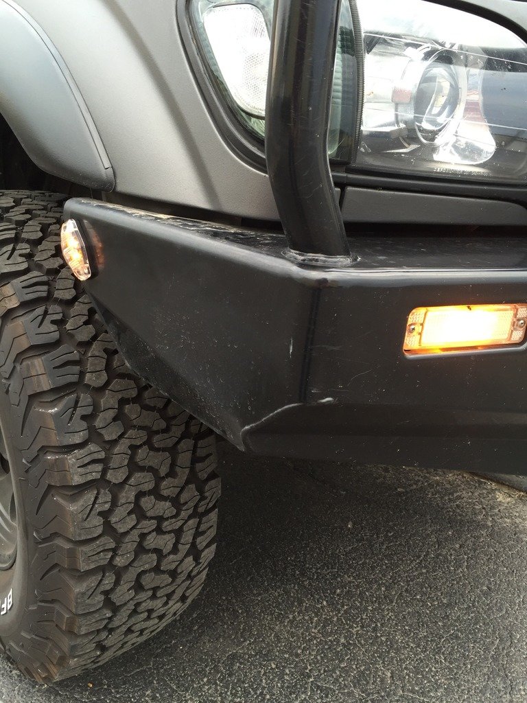

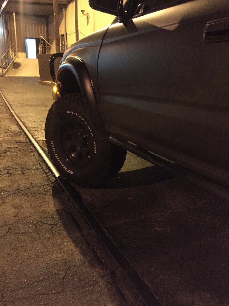

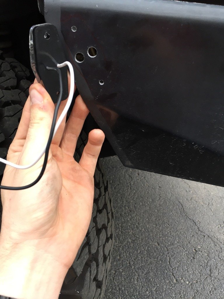

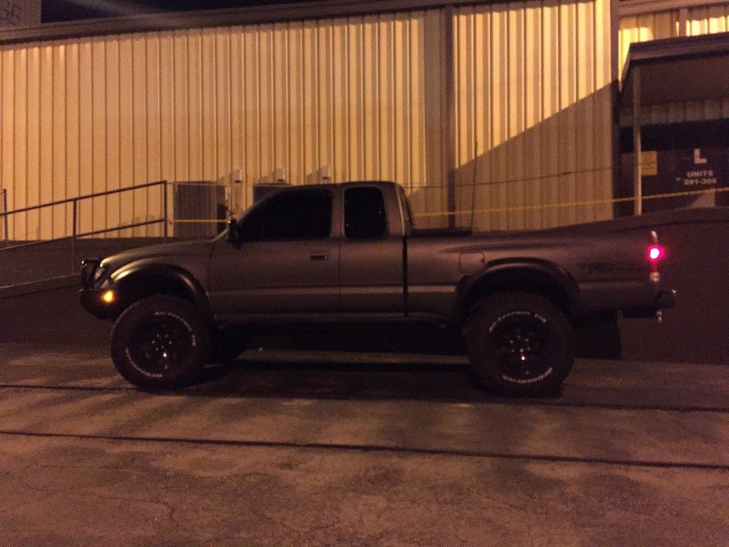

    Decided to add some little LED turn signal lights to the side of my bumper. After I had a close call with some dude being really "surprised" that I was merging over into a lane near him, I figured something needed to be done about the lack of a side facing turn signal. Easy enough to install. Just needed to pick up some stainless hardware (Phillips head bolts, lock nuts) to mount them to the bumper.

    Probably gonna get ripped off by a tree at some point. But they were 3 bucks a piece so no biggie.

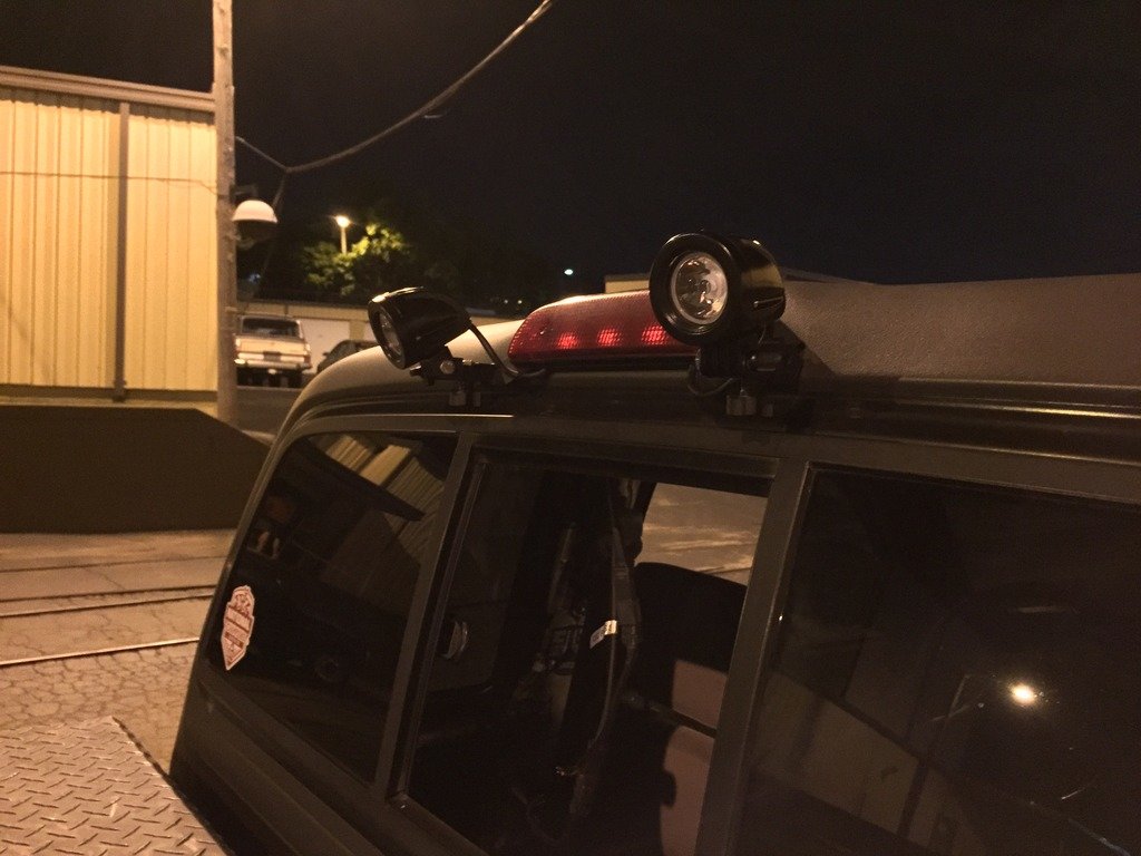

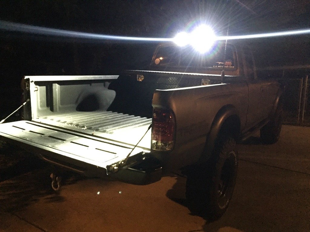

    Test fit some Better Bed Lights and got them mounted up. Very happy with them! Should help nicely with loading up my bike, checking things out back, reversing at night in pitch black areas, camping, and whatever else :)

    Those lights are awesome, was following your progress when you were testing them. I wish they were around back before I did my tool box lighting.

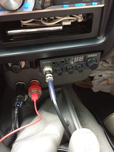

    Finally installed a Uniden 520xl pro in my truck and ditched the cobra III. And I put it in a cleaner location.
    Probably gonna have to get a new coax cable though cause I kinked it near the antenna point when I was trying to get a tie down at the hook under the toolbox :mad:
    Thanks to @cynicalrider for info on getting the CB mounted here!

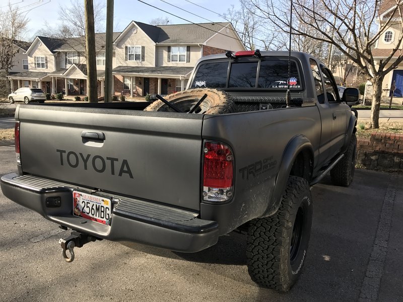

    Installed a spare tire carrier last night. I just need to ditch the 32" spare and get a 33 now
    Tire looks massive lol

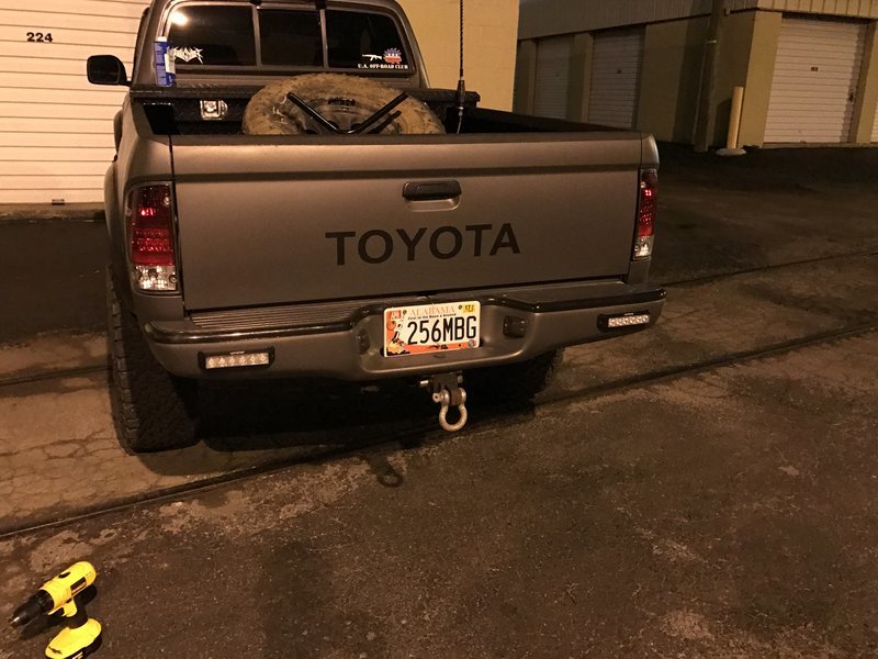

    Installed these back up lights today, they flicker like mad. But I can actually kinda see when I back up now. Need to pull the trailer harness and see what happens.
    EDIT: installed a relay and the flicker is gone. Dirty power coming from the reverse wire apparently, the lights flickered the same way my 1156 LEDs did before I installed the relay.
