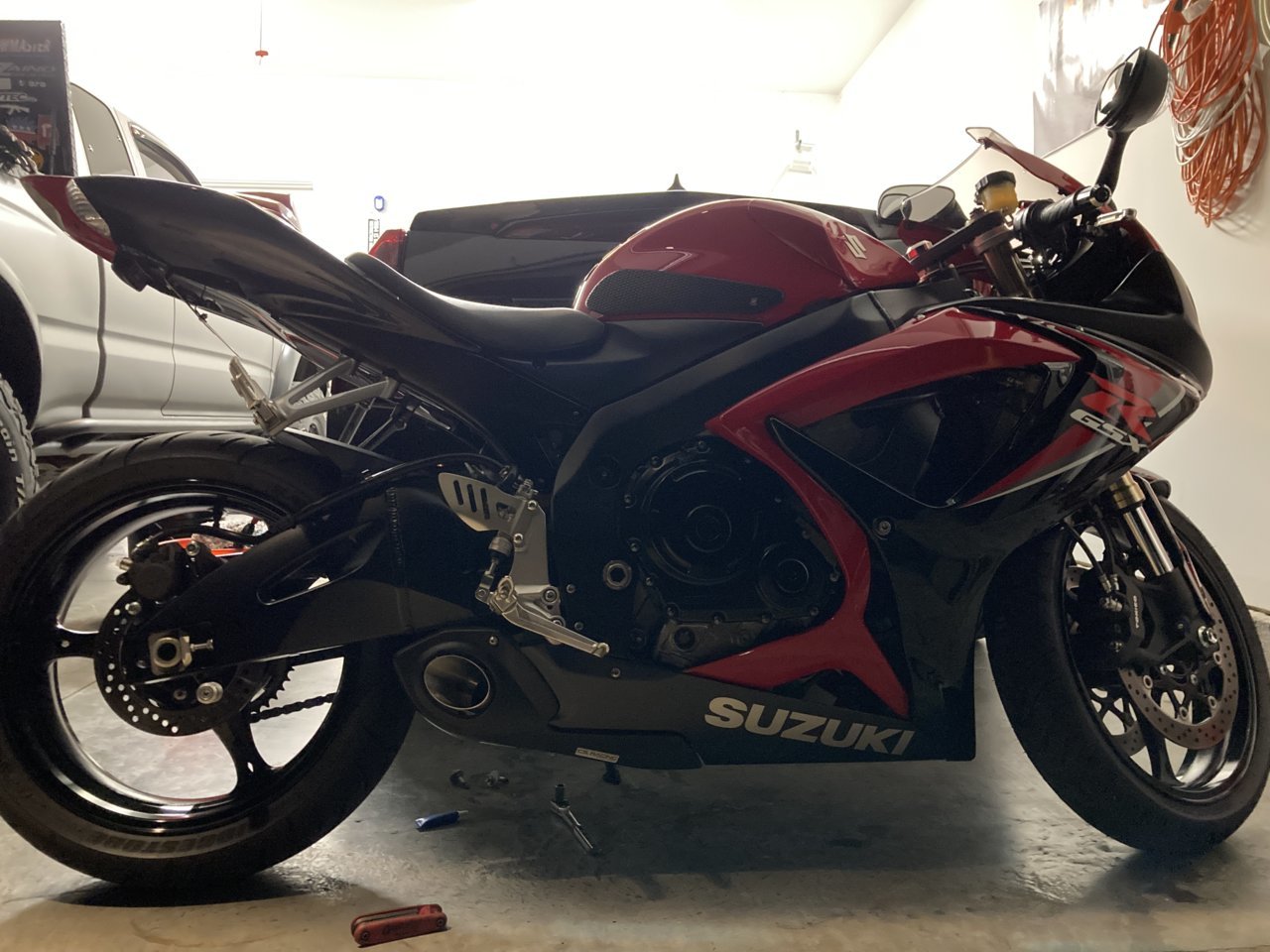

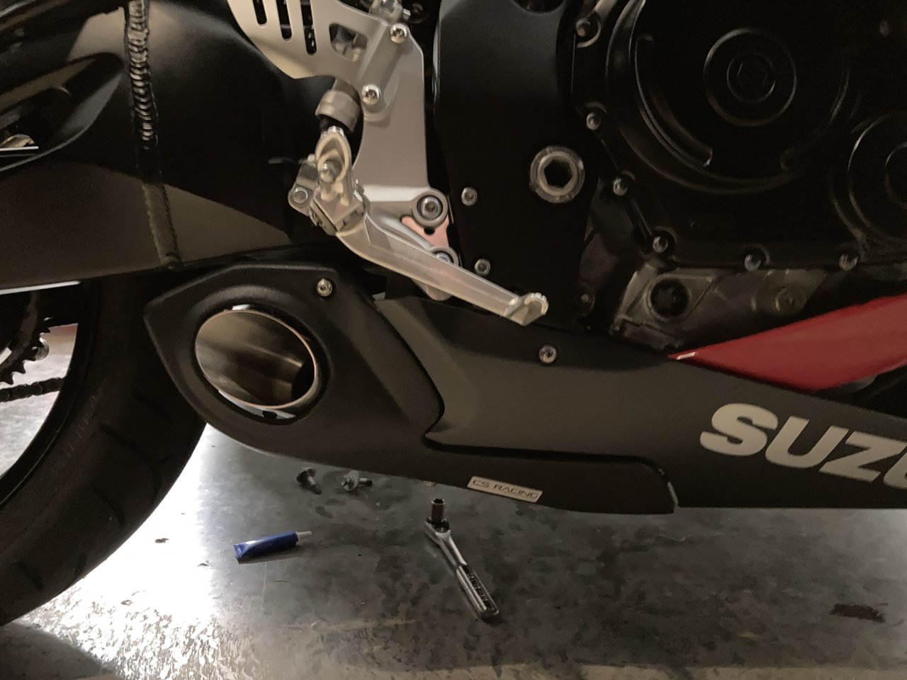

    New pipe for the bike. It is stupid loud. Basically just a resonator. Came with a silencer so I may play with on/off configuration, and a couple other DB killer designs before getting it tuned.

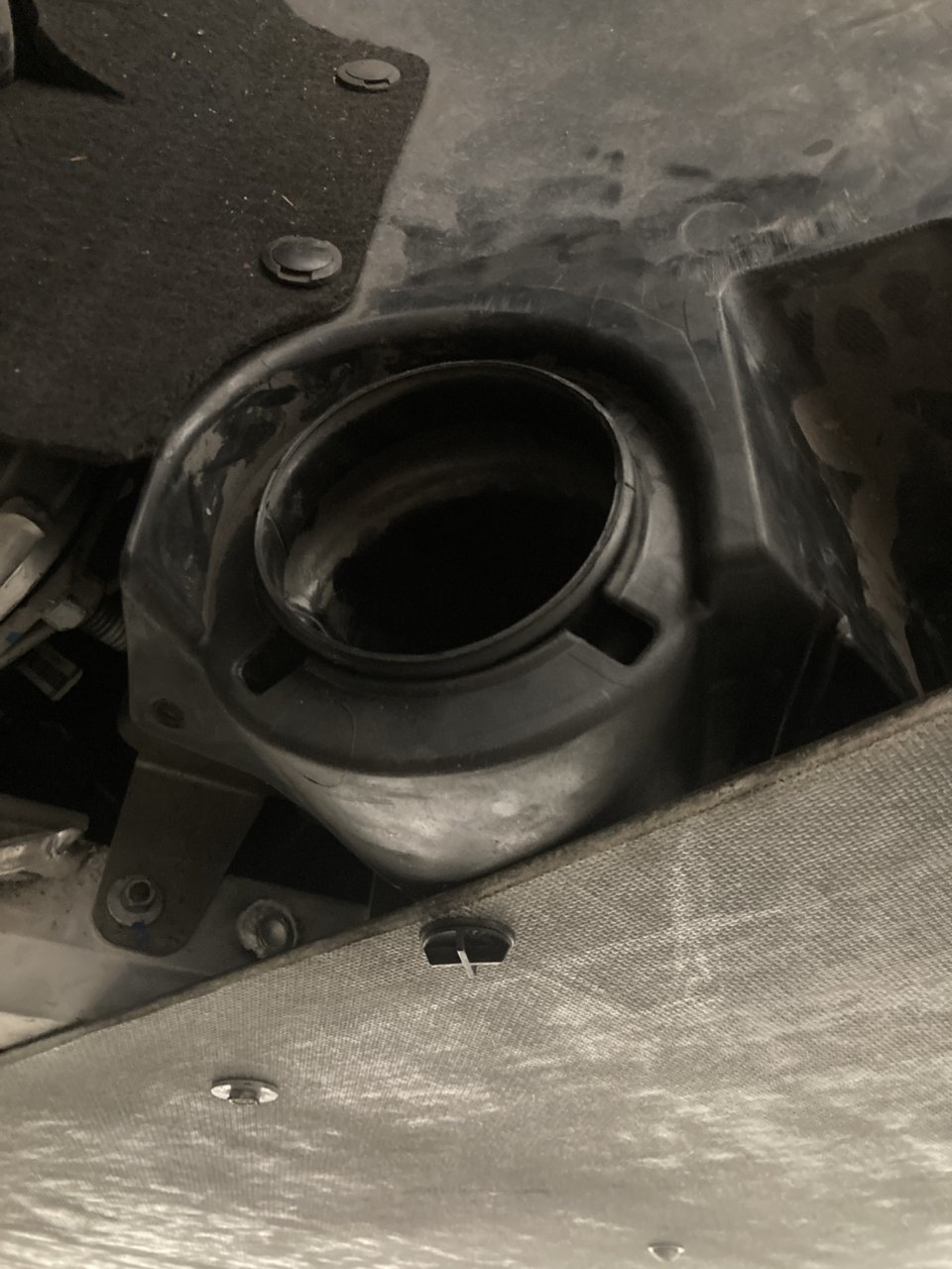

    More V work. New pass side sway bar end link, retorqued engine cradle bolts.
    Tried to affix the brake cooling ducts so they wouldn't scoot away and separate anymore due to the front splitter, since the brake duct tubing is just two plastic halves loosely clipped together. I just used some plastic fender clips I had on hand, drilled a couple holes and sandwiched things together.

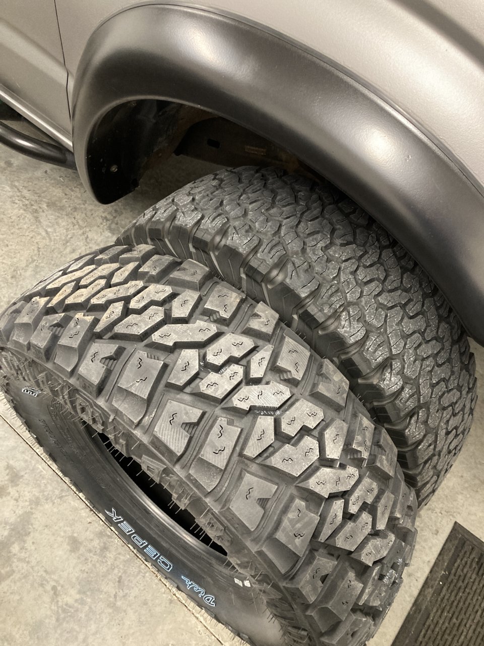

    KO2s have about 45k miles on them and still have a fair amount of tread but starting to get dry rotted since they're approaching 7 years old. Time for some new tires.
    need to fix my lower control arm situation before putting these on.

    Yup, I couldn't find really any other sizes, whatever remaining stock is on shelves will be the last of these tires, unfortunately. I may have gone 255/85 but I'm cool with 285s still.
