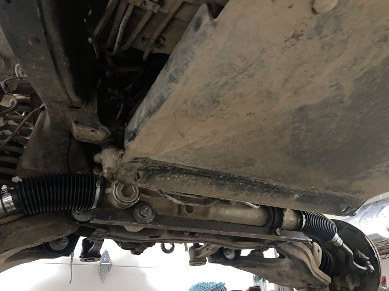

    LCA work this weekend. Fingers crossed..

    I was able to rotate all the alignment sleeves with no issues. I removed and anti-seized the front sleeves and bolts but I'm debating bothering to do the rear since I have to loosen and get the steering rack out of the way..

    Well I did the rear ones too, found a torn steering rack boot. Replacing both while I am here. Then I'll dick with the camber settings. Maxed out the caster while I was messing with it. I kept rubbing the rear wheel well when off road.

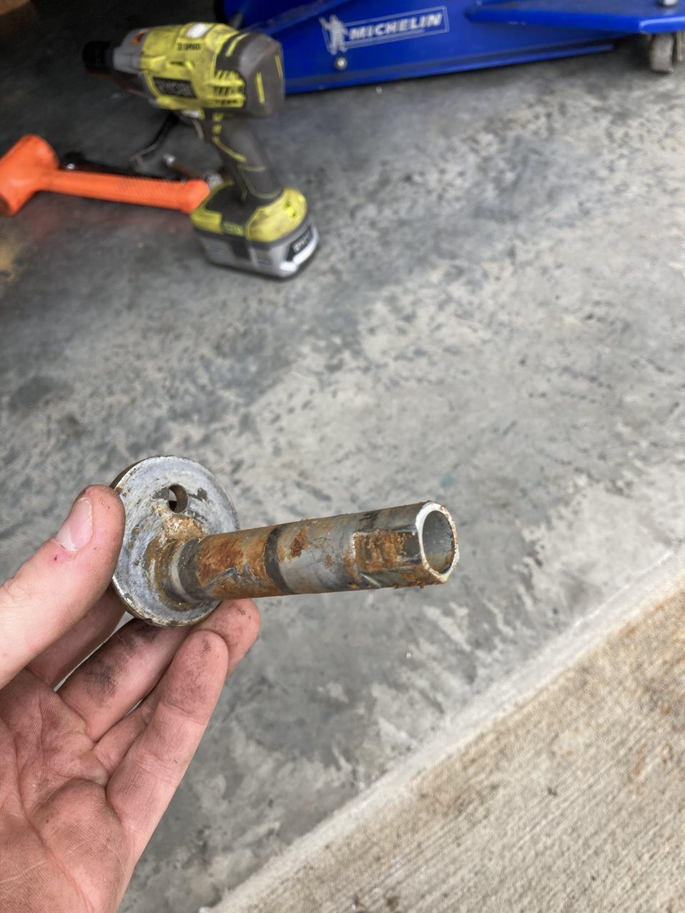

    Toe is real fucky on the passenger side, I'll readjust that along with the camber and limp it to the alignment shop 2 miles down the road lol. Then it's time to mount the tires

    I figured out why my toe was off so bad on that side, I accidentally had the caster set all the way to the rear instead of all the way to the front :anonymous:

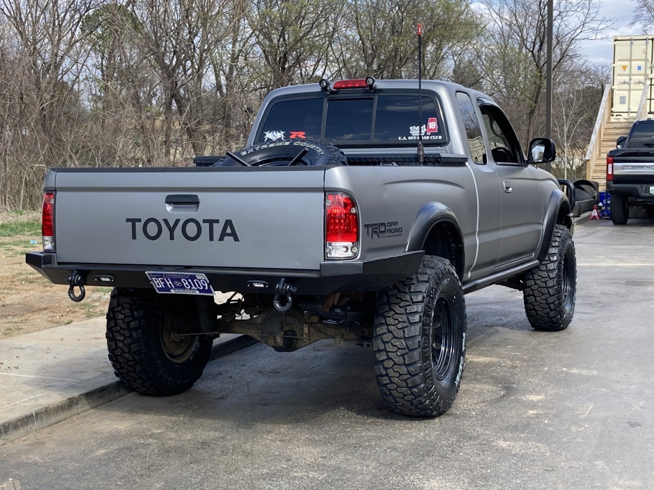

    It's really a shame these are now discontinued, I really like the look and road manners of these so far, and the noise level isn't too bad either.
    We will see how they do at AOP.

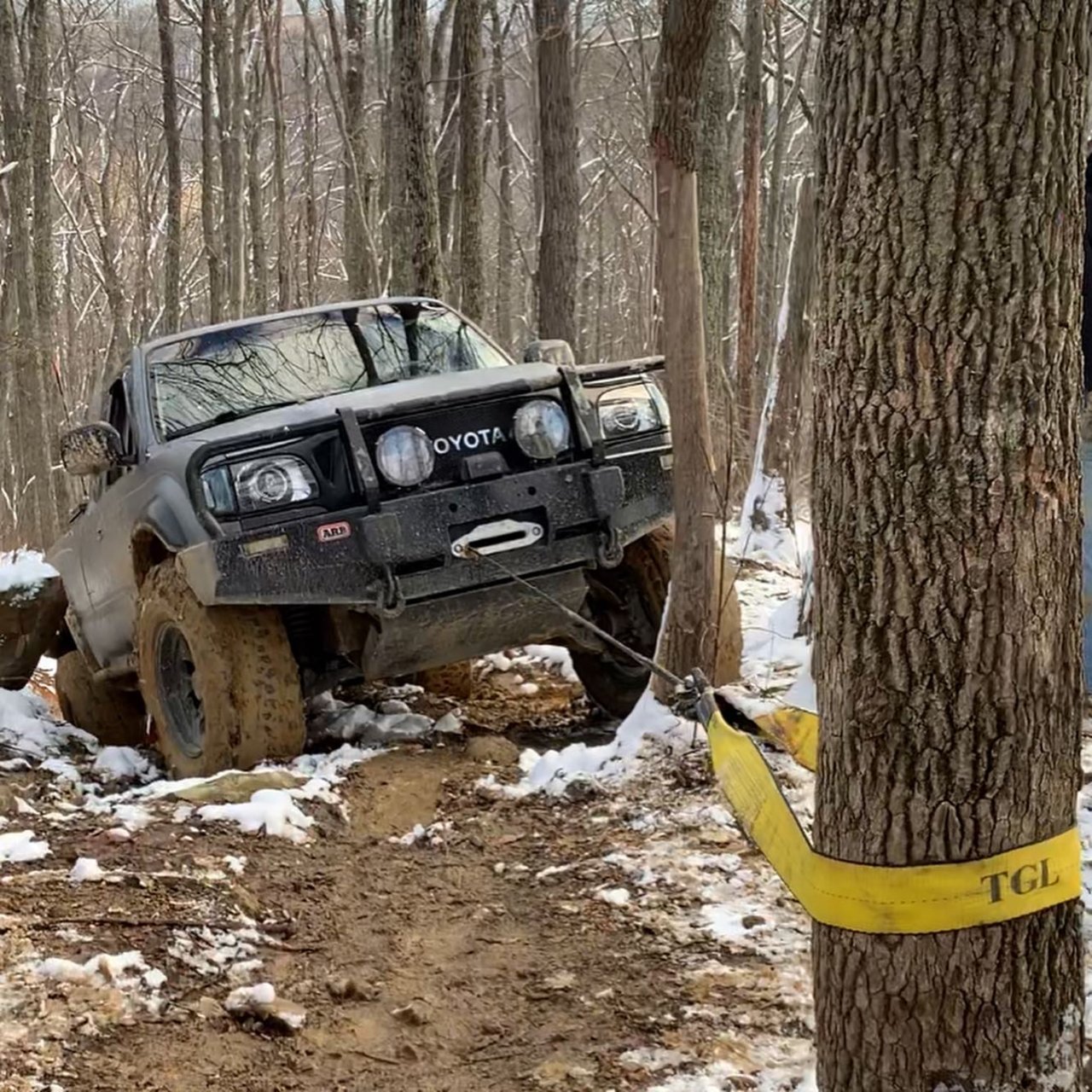

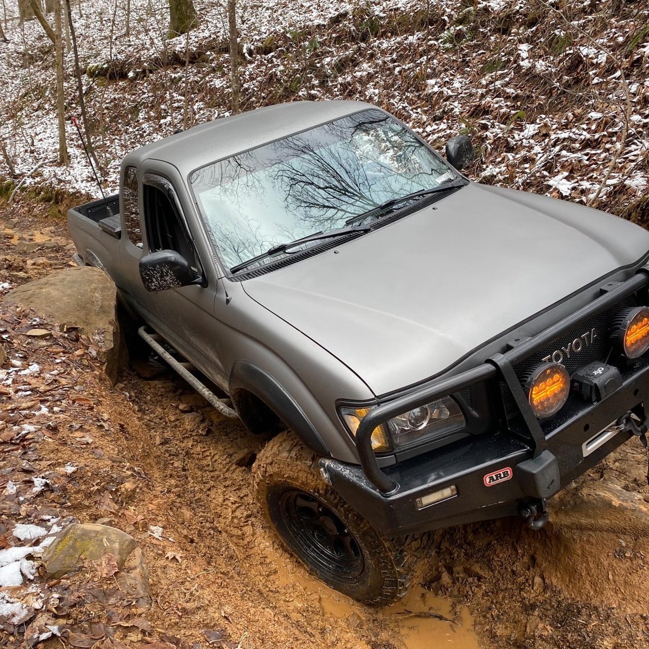

    Took the truck out and wheeled it with @Justinogo and friends. Only minor cosmetic scrapage to the passenger rear flare and bumper and a blown diff seal.
