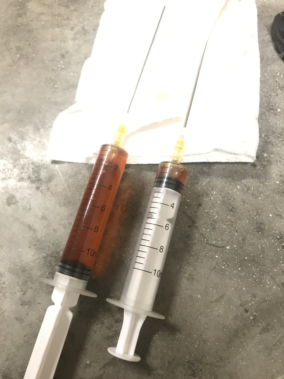

    1ST GEN OR GTFO
    Toyota NERD
    yeah, I had to swap the inlet plate from the old compressor to the new one, and I was able to take a look inside. I also dumped the oil from the old compressor. While the oil was very dark (not normal.. moisture probably).. there was no visible debris in the system. @Styx586 works on AC systems for GMs and helped me out, he said the oil looked fine other than the color, no debris. I agreed.
    I also looked up what all is involved with flushing.. and it sounds like a pain in the ass. Generally most places will just swap out the parts now. Especially the evap and condenser... there is no way you can get all the debris out of them even with flushing. There's just too much surface area and too many tiny channels that the freon travels through. They just swap the parts and maybe flush or replace the lines.
    I've looked up pics of what "debris in the AC system" looks like.. it's sort of a graphite lead color, lots of metal flakes, oil is thick and gooey looking, and grey, opaque colored. This was definitely not the case here. What I suspect is the oil is dark either from being worked too hard (too little in the system last time the AC system was opened up.. dealers fault) or moisture got in (...probably also the dealers fault for not properly evacuating the system).
    Here's a pic I found online of "catastrophic compressor failure".. I've seen other pictures that show large metal shavings in an otherwise clean looking system. Neither were present.

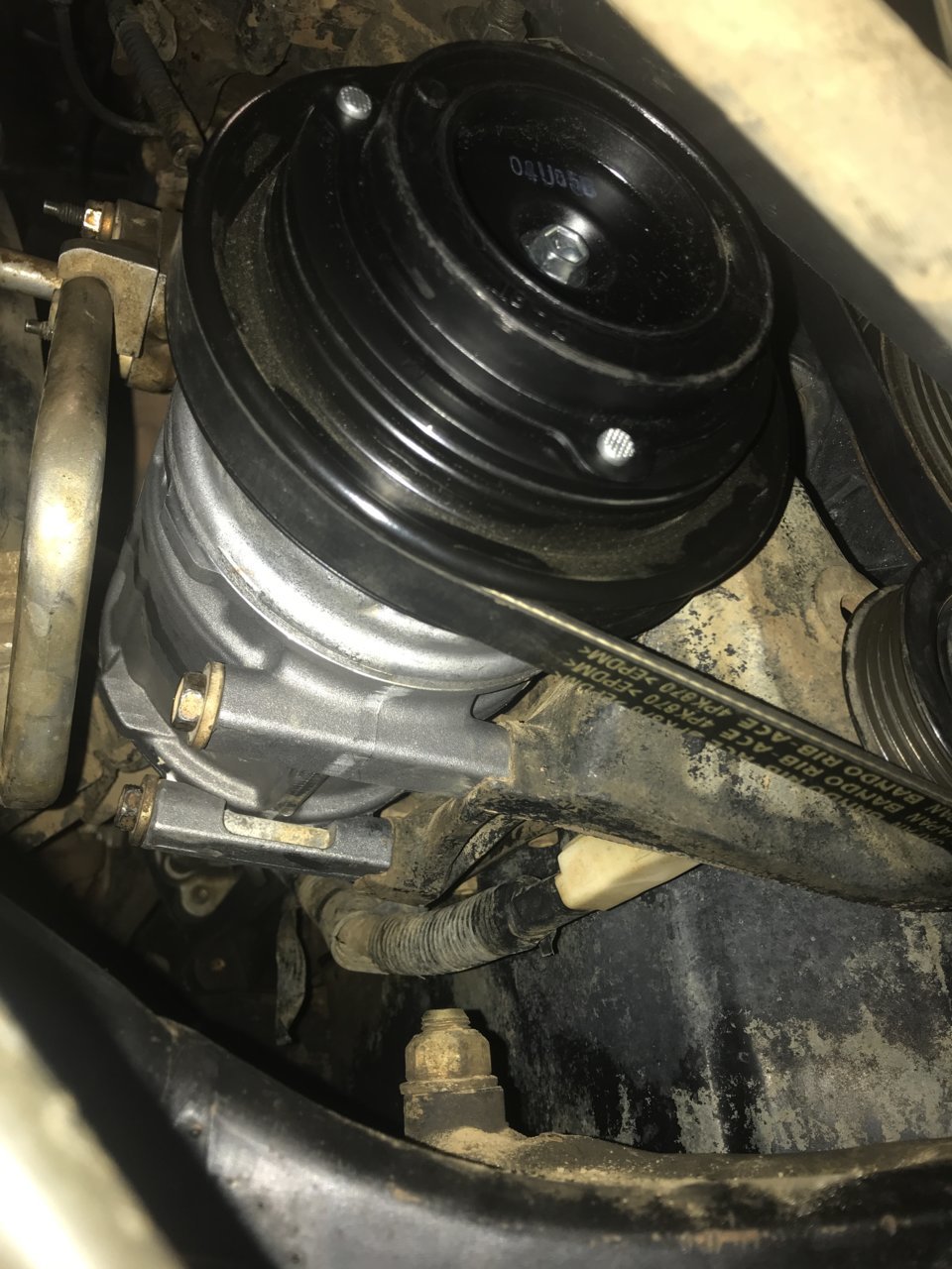

    @cynicalrider
    Some tips on the compressor replacement.
    Pull back the fender apron on the pass side near the front of the truck so you can get to the bolts for the freon lines and the top two mounting bolts on the compressor. You can access the bottom two bolts from underneath the truck (remove skids).
    Remove the bracket attached to the front crossmember for the hard lines there (see pic with bracket removed for reference) this will allow you to move the lines enough to wiggle the compressor out from between the front crossmember and radiator. I unbolted the fan shroud and tried to scoot it out of the way, this may have helped some.. but loosening the lines is what ultimately helped me get the compressor out. It's still a tight fit but some finagling will get it out of there.
    Also, getting the electrical connector off the compressor was a bitch.
    The drier and condensor are easy. Just follow the FSM if you have it. You may need to loosen the driver side headlight at the 10mm bolt and swivel the plastic bracket out of the way to get to the rearmost bolt on the drier. Tightening/loosening the drier clamp and re-positioning to get to the bolt helps too. Once the drier is off you can completely remove the lines that go to the condenser and get the condenser off.
    When done, make sure the cable is attached in the little cradle properly for the hood latch mechanism after bolting it back. I didn't do this and went to pop my hood, nothing happened. Thankfully the grill was still off so I just loosened the whole thing and figured out what the problem was. Also, loosening and adjusting the hood bracket higher or lower on the mounting point will probably be needed in case your hood no longer 'pops' open.
