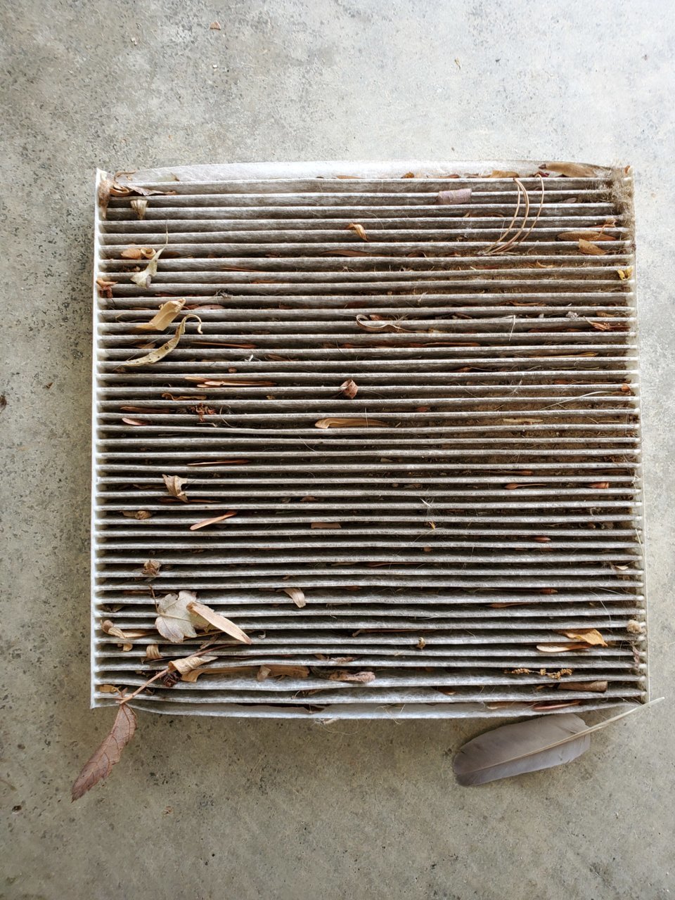

    Ever changed it out before? Fish you hand down into the fan below the air filter and make sure you don’t have debris down there.

    I change all filters, except this one.
